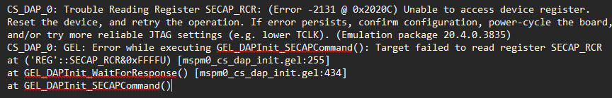

After doing a power cycle the device was locked as described in the MSPM0C manual. The factory reset completed with a positive response. But even after multiple following factory resets and power cycles I cannot flash my device anymore. It responds with this message
Error connecting to the target:  Connection to MSPM0 core failed.  Possible root causes: 1) Debug access within NONMAIN was disabled or enabled with password. 2) Peripheral mis-configuration (e.g improper watchdog or clock).  To see a more detailed diagnostic of the issue, please press the 'Read boot diagnostic' button.

  • Hello Janz Bai,
    I am currently unable to reset the device it seems. I did experience this multiple times prior when a factory reset was already executed. It either gets stuck at "Press the Reset button..." or reports this
    Flashing is still not possible. Also, did you mean FactoryReset_Manual? Auto uses the debugger chip's NRST pin, does it not?
