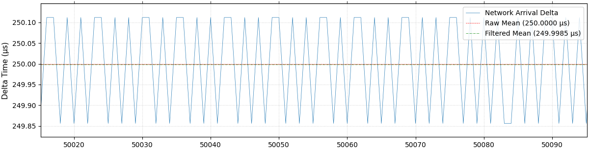

i've built an application based on the gPTP/EST-Example. One Ethernet-Frame is created every 250 µs through a triggered interupt using the GENF-Module. Afterwards, it's released using the EST-Mechanism on a seperate queue (Nothing else is there allowed and im using a Guardband to protect the slot, additionaly between creating the frame and queuing it enough time should pass).
Now i can view on my reciever a NIC i210 that the differences between arrival times of 2 frames is not really constant. It jumps between 250.113 µs and 249.857 µs (256 µs difference) but it seems kind of random. Can you explain this behaviour? Has it something to do how frames are fetched for/from the EST queues?
The y-axis is the arrival time difference, the x-axis the paket-number.
The raw mean is mean of all paket arrival differences. Here are a few burst events included, because the gPTP-Task delayed the Frame-Creation-Task although gPTP has the lower priority configured.
The filtered mean is the mean of the paket arrival differences shown in this image.
Flo

  • Hi Teja,
    i don't think it's accuracy loss. Parallel i've probed my setup and i measured rms-jitter of 5 ns between the LP Genf signal and the NIC. The maximum Peak-to-Peak jitter in 30 Minutes was only 30 ns.
    Best regards
    Flo

  • Hi Flo,
    For a 64 Byte packet size, the acceptable window size is close to 0.8-1 usec. The observed variance is close to 0.1-0.15 usec, which is within the expectation of the spec, and suggested limits. Does your applicaiton need even tighter tolerances for the packet sending?
    If yes, please let us know some more details on the usecase so that we would be able to help you identify the available options.
    Thanks and regards,
    Teja.
  • Hi Teja,
    the variance is 127 ns, peak to peak is 256 ns. I think it has something to do with how data is fetched from the  EST-queues and maybe some clock domain crossing at this point.
    I am trying to implement highly deterministic TSN-Communication, ideally with RMS-jitter < 10 ns. My gPTP - synchronized network currently reaches this level of jitter, but as you see, the transmission of the pakets doesn't operate at the same level.
    The overall goal is to determine, what the capabilities of TSN and currently available TSN-Hardware are.
    Because the jitter is discrete and jumps only between 2 levels, i would have thought, that maybe with the right configurations one can loose this current behaviour?
    Flo
