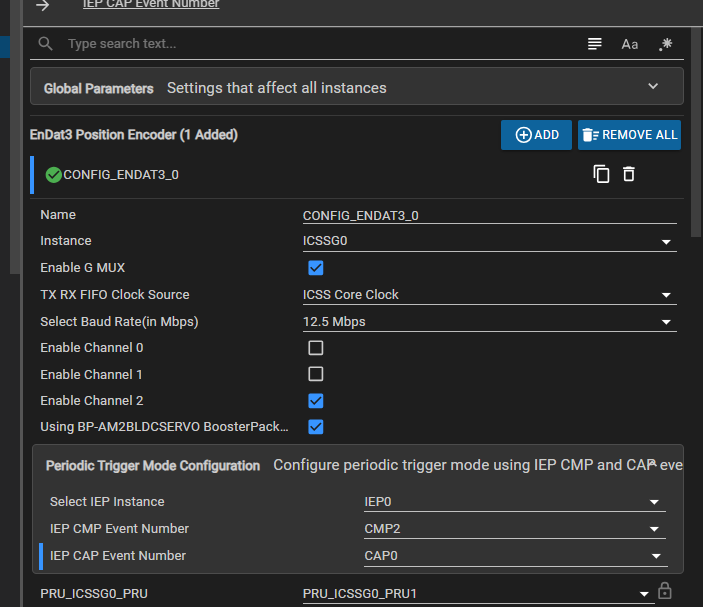

AM2434: Trigger EnDat3 through external Interrupt via CAP
Part Number: AM2434
is it possible to use EnDat3 in periodic-command code through triggering via an external interrupt the CAP-Input? I oriented myself on the routing example:
https://e2e.ti.com/support/microcontrollers/arm-based-microcontrollers-group/arm-based-microcontrollers/f/arm-based-microcontrollers-forum/1452411/faq-lp-am243-routing-gpio-interrupts-to-pru-core
but i couldn't make it work.
Configuring Sciclient did work, but the PRU never registered an event.
Here the function i used:

LP-AM243x-Pin used: 48 (=PRG0_PRU0_GPO6/H2)
EnDat works with the IEP-Timer settings and CAP6.

  • Hy Flo,
    check the EnDat 2.2 example where CAP0 is used for Channel 1 with an external interrupt using the GPIO0_4 pin. Verify if any configuration is missing or incorrect.
    motor_control_sdk\examples\position_sense\endat_diagnostic\endat_periodic_trigger.c
    BR,
    Achala Ram
  • Hi Achala,
    i can't write to the register from the application. Reading is no problem.
    Also do i need to configure the GPIO in a special way?
    Flo

    did you see the same error or could you tell me how to implement it?
    Flo
    We are working on the above issue. Please share you example.syscfg file with us.
    Also please tell, the GPIO pin which used to generate the interrupt/event, is it configured as GPIO or other functionality? Also is the functionality of GPIO pin changed during the runtime operation in your application code?
    Tushar

    endat31.$name                  = "CONFIG_ENDAT3_0";
    endat31.Booster_Pack           = true;
    endat31.G_MUX_EN               = true;
    endat31.channel_2              = true;
    endat31.channel_0              = false;
    endat31.CAP_Event_Num          = 0;
    endat31.ENC1_EN.$name          = "ENDAT3_0_BP_POWER_EN0";
    endat31.ENC1_EN.GPIO_n.$assign = "MMC1_SDCD";
    endat31.PRU_ICSSG0_PRU.$assign = "PRU_ICSSG0_PRU1";

    it's configured as GPIO, as you see in the syscfg., i don't change anything during runtime operation. The first Problem is, i can't even write to the routing register, without generating an error.
    Flo

    Step 4: Update gpio_config.c.xdt
    • Use destination id = TISCI_DEV_PRU_ICSSG0 and host irq = 4 for CSLR_PRU_ICSSG0_PR1_IEP0_CAP_INTR_REQ_MAIN_GPIOMUX_INTROUTER0_OUTP_18 in gpio_config.c.xdt located at:
      <mcu_plus_sdk>\source\sysconfig\drivers\.meta\gpio\templates
    • This will enable routing through SysConfig, where you can select any router number. It will always use the destination CSLR_PRU_ICSSG0_PR1_IEP0_CAP_INTR_REQ_MAIN_GPIOMUX_INTROUTER0_OUTP_18.
    •  I used direct values nested as macros are not present in the SDK for this output.
    • You can see the host IRQ index here. software-dl.ti.com/.../interrupt_cfg.html
    Step 5: Update endat3 example SysConfig file and diagnostic.c file
    Update the endat3 example SysConfig file and diagnostic.c file with the provided updates.
