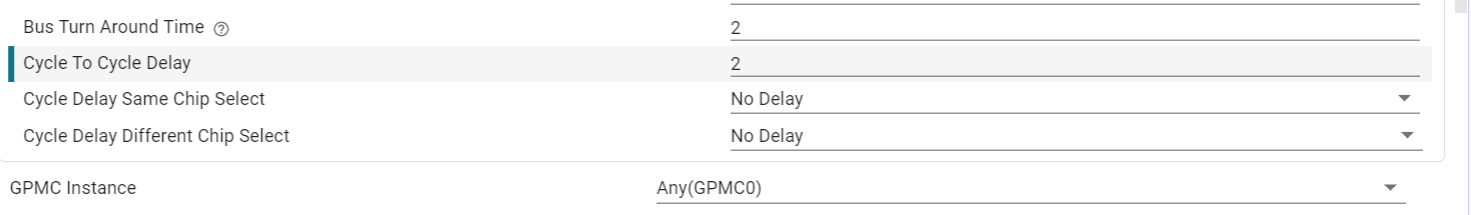

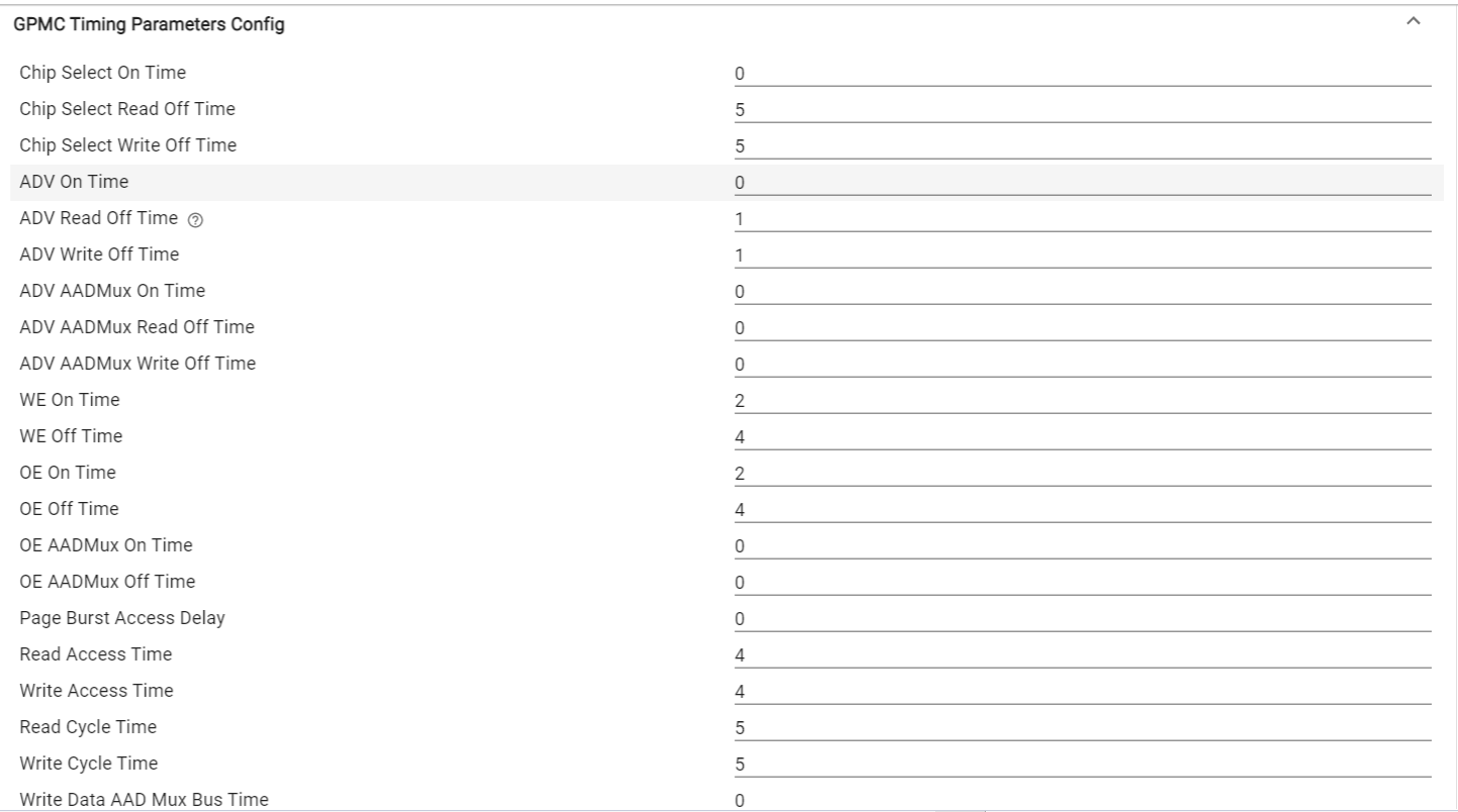

we have interfaced NAND Flash MT29F8G08ABACAWP-IT-C  with AM2434BSFFHIALVR controller  on our custom board.In the Sysconfig we need to fill the timing parameters whose values are not directly available in the NAND flash datasheet.The following are the parameter values we have written in Sysconfig as seen in the screenshots attached.Can you verify the timing paramters values which we have written are correct or not?Can you also provide any formulas for each of the parameters according to the NAND flash timings. image.png

  • we calculated the timing parameters according to the formulas which you have given but there is no improvement in the NAND Flash

  •  the issue is we are not able to receive the ready busy signal.We probed the lines using logic analyzer and no response on the ready busy signal.The 0xFFh was going to the NAND flash and rest of the CS and other signals were as expected.If our calculated values are wrong then please provide exact values.We are not able to know this is a hardware issue or configuration issue as this is a custom board.

  • Hi Kashish,
    Based on GPMC0FCLKDIV = 0 -> i.e. DivBy1 mode and GPMC0_FCLK freq.=133 MHz ( ~7.5 ns clock period)
    please try setting the following timing parameter values in the corresponding GPMC0_CONFIG2_1 - GPMC0_CONFIG6_1 register bitfields:
    Considering MT29F8G08ABACAWP-IT-C parameters we have following AM62P GPMC0 config. values
    NAND Write cycle
    CSONTIME = 0 ( 0 ns )
    CSWROFFTIME = 5 ( 5 cycles * 7.5 ns = 37.5 ns )
    ADVONTIME = 0  ( 0 ns )
    ADVWROFFTIME = 5  ( 37.5 ns )
    WEONTIME = 0 ( 0 ns )
    WEOFFTIME = 3   ( 22.5 ns )
    WRACCESSTIME = 4 ( 30ns )
    WRCYCLETIME = 5 ( 37.5 ns )
    NAND Read cycle
    CSRDOFFTIME = 6 ( 6 cycles * 7.5 ns = 45 ns )
    ADVRDOFFTIME = 6 ( 45 ns )
    OEONTIME = 0
    OEOFFTIME = 4 ( 30 ns )
    RDACCESSTIME = 5 ( 37.5 ns )
    RDCYCLETIME = 6 ( 45 ns )
    BUSTURNAROUNDTIME = 14 ( 105 ns )
    I am looking forward to your feedback !
    Anastas Yordanov
  • Hi Kashish,
    Do you follow the recommended sequence for issuing the command from the AM243x processor to the NAND memory ?
    Is the WAIT0 input stuck active LOW infinitely (constantly busy) after the processor issues 0xFF to the memory ?
    Is the MT29F8G08ABACAWP-IT-C R/B# pin attached to the AM243x gpmc0_wait0 pin and do you have the recommended pull-up resistor with the appropriate value (see memory datasheet) attached at this pin ?
    From your Sysconfig GPMC window screenshot I do NOT see what is the specified WAITMONITORINGTIME value. Is it 0 cycles ?
    Looking at your previous parameters:
    I can see the ReadAccessTime=4 > ReadCycleTime=3, WriteAccessTime=4 > WriteCycleTime=3 which means you try to access the bus after the R/W access cycle has elapsed.
    The ADV On Time = 4 can NOT be higher than the ADV Read Off Time = 3 or ADV Write Off Time =3.
    Also the ChipSelectReadOffTime=2 and ChipSelectWriteOffTime=2 can not be lower than ReadAccessTime=4 and WriteAccessTime=4.
    For the timing values relations, and more intuitive explanation, please refer the NAND timing diagram  Figures 12-192 through 12-195 from the AM62Px TRM above.
    Important notice on NDA restrictions: It looks like Micron's MT29F8G08ABACAWP-IT-C memory datasheet contains proprietary and confidential data that must NOT be disclosed / discussed in the Arm-based microcontrollers public E2E forum. Thereby I am deleting the above attached AC characteristics tables screenshots. If you'd like to discuss on concrete parameters we can continue on some of the internal forums. Let me know.
    Looking forward to your answers !
    Thank you
