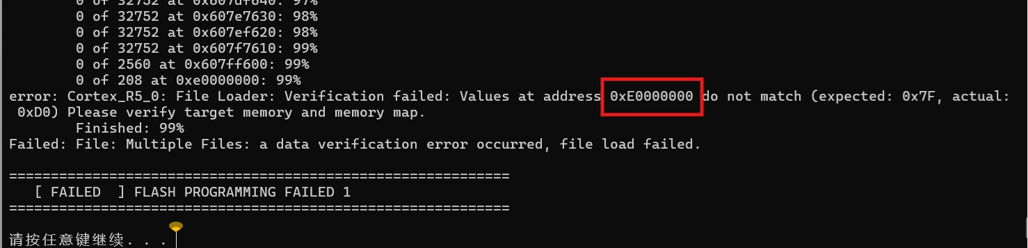

Hi experts,
The customer encountered a verification failure during the XIP programming process.
Here is the log

        0 of 208 at 0xe0000000: 99%
error: Cortex_R5_0: File Loader: Verification failed: Values at address 0xE0000000 do not match (expected: 0x7F, actual: 0xD0) Please verify target memory and memory map.
        Finished: 99%
Failed: File: Multiple Files: a data verification error occurred, file load failed.
   [ FAILED  ] FLASH PROGRAMMING FAILED 1
Press any key to continue....

I instructed the client to use the following command:
set GENERATED_COMMAND=-c user_files/configs/AM261x.ccxml -l user_files/settings/generated.ufsettings -s VerifyAfterProgramLoad="No verification" -e -f "user_files/images/sbl_ospi_multicore_elf_am261x-lp_r5fss0-0_nortos_ti-arm-clang.tiimage,0x60000000" "user_files/images/littlefs_5mV3.3.2.bin,0x60300000" "user_files/images/ethernetip_adapter_generic_device_mii_demo_am261x-lp_r5fss0-0_freertos_ti-arm-clang.mcelf,0x60081000" "user_files/images/ethernetip_adapter_generic_device_mii_demo_am261x-lp_r5fss0-0_freertos_ti-arm-clang.mcelf_xip,0xE0000000"
This effectively disables the verification step.
Customer feedback: After removing the verification step, the program can be correctly flashed. Furthermore, upon power-cycling the chip, the CPU is able to properly execute the program located in the XIP (eXecute-In-Place) region.
The question now is why verification fails in UniFlash.
