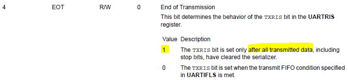

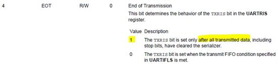

  • @ Stellaris Sheldon,
    Your inside info - this topic - highly appreciated.  Below - detail w/in our LX4F manual - UARTCTL Reg:
    Devil in the detail here - and manual's use of, "after all transmitted data" may logically apply to a single byte - may it not?  This absence of clarity as to the define of, "all xmt'd data" derails many...
    Might you detail "just how" Register UARTCTL can "know/detect" when the final byte of a multi-byte (perhaps 100 bytes - in the example here) has been reached?  Might this be, (absence of byte-stream) "time triggered?"
    Further - does this same EOT bit "trigger" of TXRIS exist in the simpler, non-uDMA UART mode?
    Thanks much your time/attention...
  • @cb1_mobile,
    This works because the DMA should be filling the FiFo with data as the FiFo is pushing data into the serializer, meaning the serializer is not done transmitting data until The DMA and FiFo are empty. The description of the Transmit Interrupt in the data sheet:"Transmit (when condition defined in the TXIFLSEL bit in the UARTIFLS register is met, or if the EOT bit in UARTCTL is set, when the last bit of all transmitted data leaves the serializer)".
    If you were not using the uDMA the interrupt should trigger when the FiFo and serializer are empty. If you are also not using the FiFo, the Transmit interrupt should trigger after each byte.
    Sorry for the confusion,
    Sheldon
