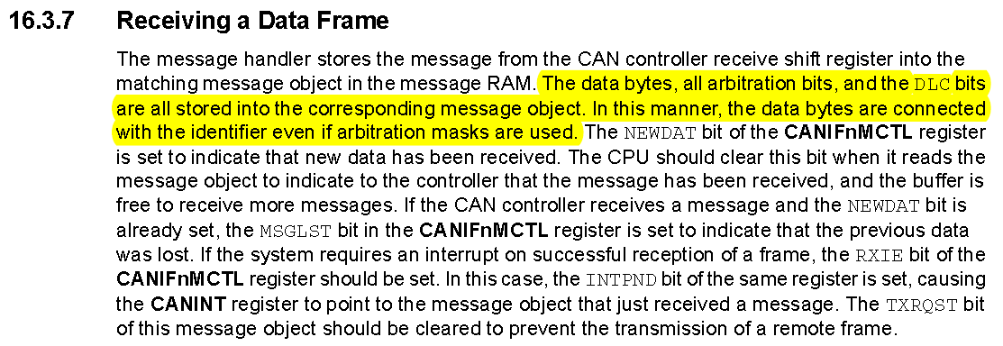

I am a new user of TM4C1231H6PM tiva series ARM Microcontroller.
İn my project I have to get all 29 bit CAN frame.
Is it possible for Tiva-C series microcontrollers?
API is giving 8 data bytes but could I reach the ram to get all bits?
Thank you for your comments.

Hello Amit,
I want to read 29-bit Can Frame.
In datasheet It looks to me I can read just 8 byte data and ıt doesnt allow me to acces Message object in RAM.
Please excuse my poor English :).
Hello Serkan,
When using the acceptance filtering the ID will be available in the CANIFnARBn register. Please refer to section 16.3.11
