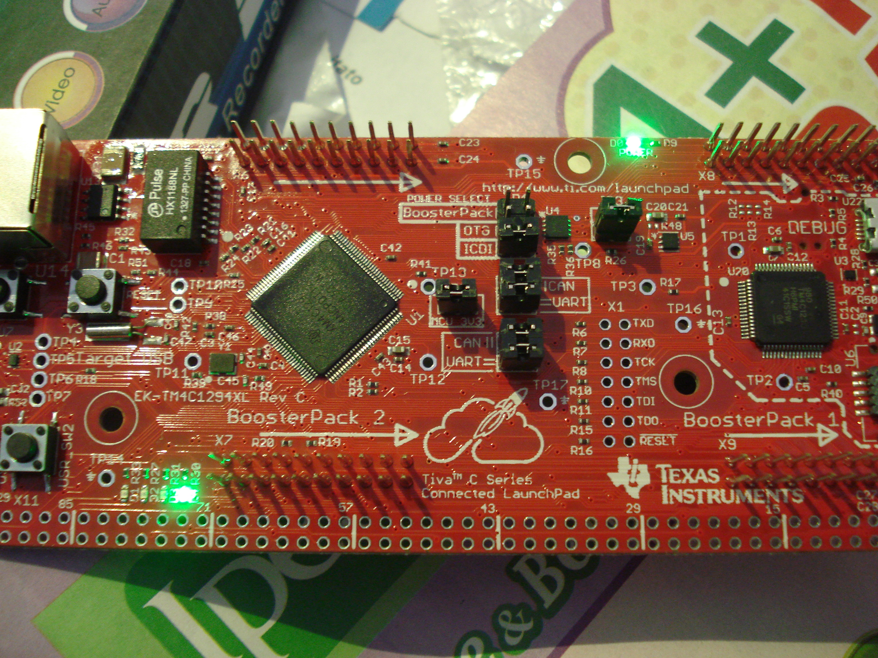

    Hardware: EK-TM4C1294XL - without modification
    Documentation: DS-TM4C129ENCPDT-15802.2729 SPMS394B April 22, 2014 NDA Version of the Datasheet
    Development Software: Code Composer Studio 6.0.0.00190, TivaWare 2.1.0.12573
    Ethernet PHY Cable Diagnostics - p. 1594, 1778
    PHY Register MR30
    There are timing characteristics that I cannot find documented.  Documentation on what exactly it is doing would also be appreciated.
    Set the START bit, wait to see it set in the register.
    Wait for DONE bit, read register, decode results.
    Results inconsistent.  If I wait some time, and reread the register, the result may have changed.
    I've run this with good cables and with bad (shorted pair).  I've run it connected to another device and not connected.
    Does anyone have better documentation for this function?  For the timing issues?  For what it is actually doing?
