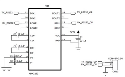

  • Hi...i have connected MAX3232 between controller n pc..i'm taking the output of  MAX3232 to pc..

  • Hi sorry for late reply...i'm cheking the Tx and Rx pins in oscilloscope..but i'm not able see any pulses in oscilloscope...please help me.
       Post a schematic diagram showing connections from microcontroller UART to MAX232 to PC.
    - kel
  • Hi Rashimi,
         I assume the OP prefix at your signals refers to your PC connection. Should be like this below. Where did you tap the oscilloscope?
         TX_RS232 -> DIN1   - - - - -   DOUT1-> RX_RS32_OP
         RX_RS232 <- ROUT1   - - - - -   RIN1<-TRX_RS32_OP
         Also, your capacitor value too small 0.1uF??? The MAX232 I have used before had 10uF drum capacitor across C1+ and C-. Same with C2+ and C-.
    - kel
  • I'm checking  DOUT1-> RX_RS32_OP and RIN1<-TRX_RS32_OP at CN12 connector.You mean to say i need replace from  0.uf to 10 uf???
  • Long ago - the original RS232 level shifters did require such (relatively) high value, electrolytic caps.  But most all now work quite well w/ 0.1uF - yielding great cost/size saving.  And indeed - poster's chip is modern - needs not those huge,expensive caps.
    As poster states there is no recognizable output from UART_TX - troubleshooting "down the line" (i.e. RS232 level shifter) seems inappropriate - at this time!
    Poster should follow Amit's advice to use more basic "UARTCharPut" function.  Insure all earlier, different functions have been removed.

  • Hi...i'm getting pulses..can you please check with the schematic what i have sent you.because now if i enter character then it is display the diffreent symbol..y so??

  • Hi....i got output because of  schematic problem i was not getting the output..now i suppose to print the string like
    UARTprintf("***Software Rev : 0***\n");    but it not printing on hyper terminal

    3. Is it toggling at the other end of the Cable connected to the PC?
    4. Did you try checking if the device manger in the PC is detecting a serial port?
