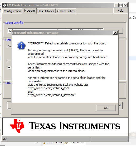

  • Dear Sir,
    I tried testing the  codes from C:\ti\TivaWare_C_Series-2.0.1.11577\examples\boards\dk-tm4c123g\boot_demo1 on
    Stellaris LAUNCHPAD (LM4F120XL) . I used LM Flash Programmer to build the Boot Loader Program and in next step configured it to Manual and selected SERIAL (UART) and was trying to dump a random sample code. Below is the error message which I got. Please advise what to check to make it working.
  • Hello Chandrashekhar,
    Please keep a single thread on the same. Anyways I have updated the new thread you have posted.
    http://e2e.ti.com/support/microcontrollers/tiva_arm/f/908/t/370841.aspx
