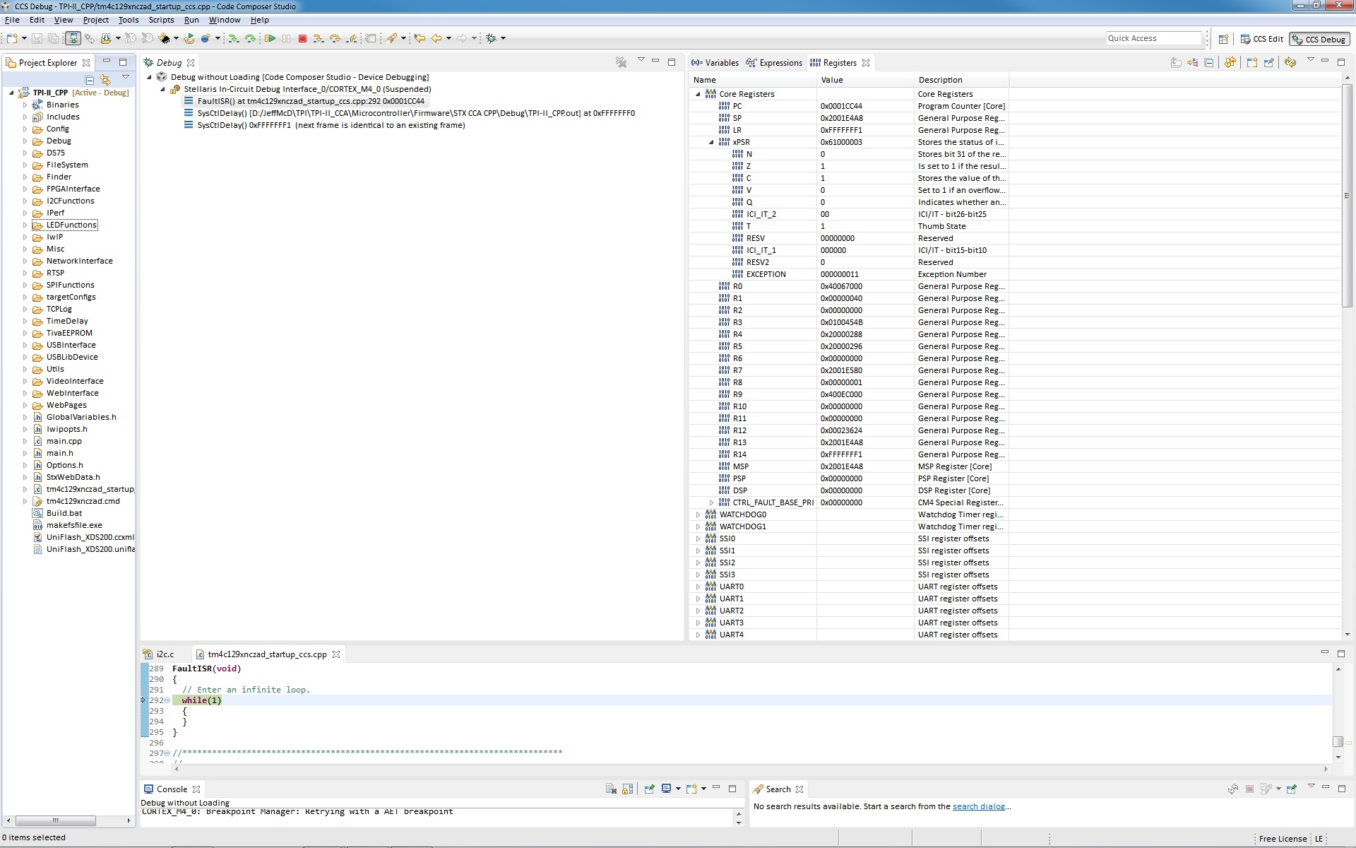

  • Amit,
    The code is ending up in the FaultISR( )  handler.
    Jeff
  • Hello Jeff,
    Looking at the CPU registers it seems (could you check the FAULTSTAT and FAULTADDR registers in NVIC) that the fault is for the Address 0x40067000 which is GPIO Port R.
    Amit

  • Hello Jeff,
    IMPRECISE Bus faults are a little difficult to debug. There is an application note for CM3 which was written and does help in the debug as it requires the dissasmebly to the faulty STR opcode.
    http://www.ti.com/lit/pdf/spma043
    Amit
  • Amit,
    I was able to determine that I had a race condition in my code. I am using Timer0 to blink an LED and I was enabling the timer before enabling the port for the LED. For some reason it only failed after updating the code using ROM_UpdateEMAC. It was a long road to get there but the problem is solved.
    Thanks for all of the help!
    Jeff
