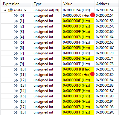

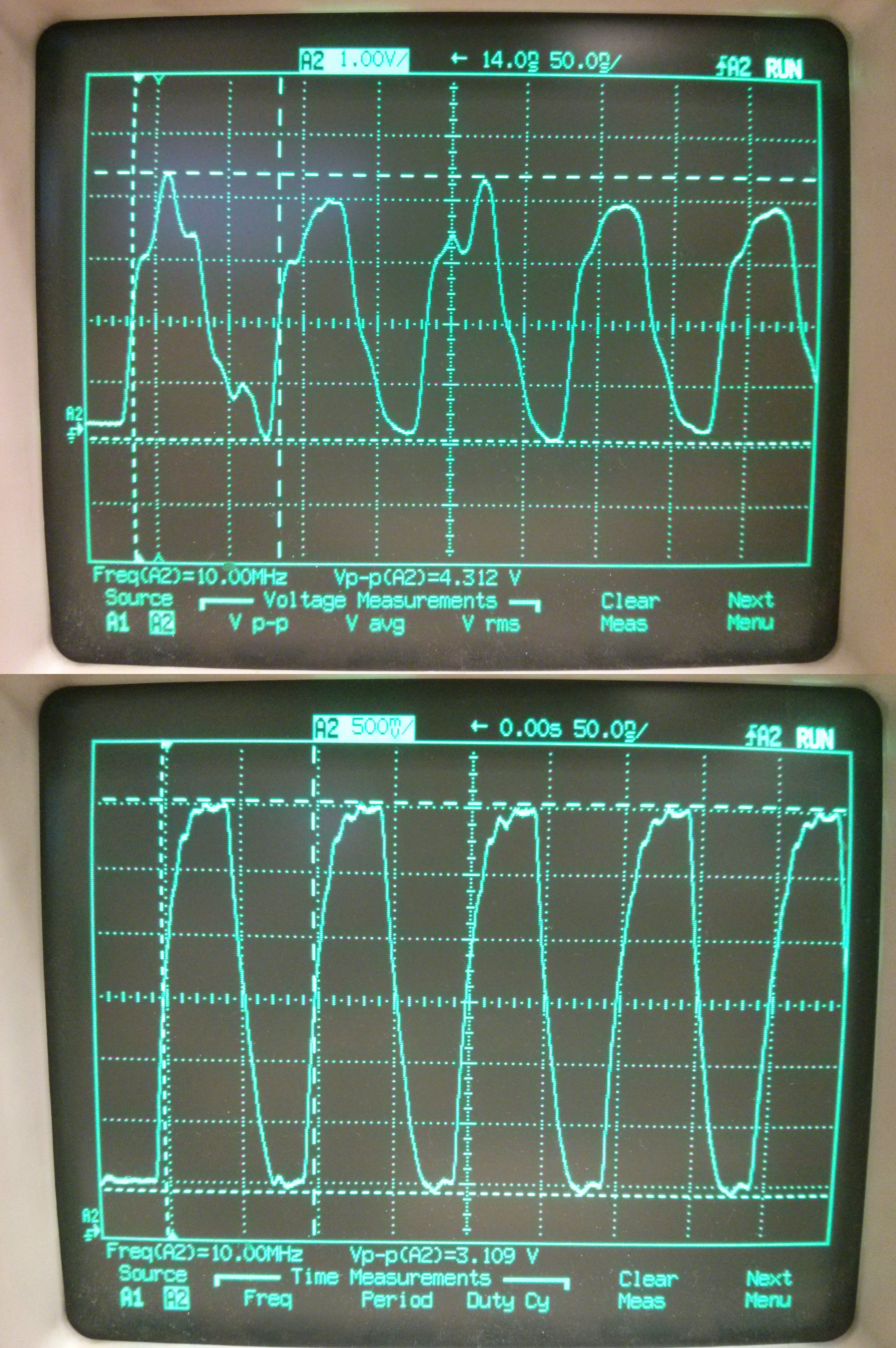

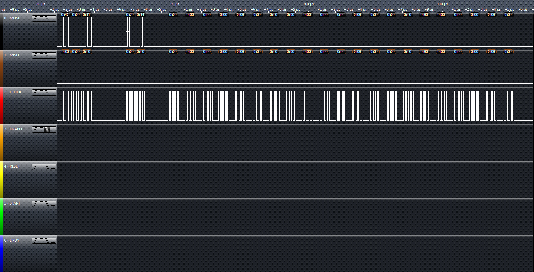

This sounds like a software/firmware issue rather than chip.  The chip (from the d/s, Timing Requirements on page 7) should be able to handle up to 20MHz clock for SCLK.
You may want to look at the configuration of the SSI; I would suspect that you may not be reading correctly at the slower speeds even though it may appear that is the case.  If at 1.2MHz you don't read all the data, the slower will not read out all the data either.
So far my intuition tells me that there are certain SSI restrictions that are violated. I've followed the recommended protocol as outlined by TI Application Engineers so this problem seems to be a bit more complex. Maybe ssi.c needs to be examined in more detail?

    3) The logic analyzer shows MOSI sending out correct data. So we can confirm that it works in one direction. It's just MISO not getting any response.
    I've attached a screenshot of what transmission looks like at 10MHz
    Stephen
  • Hello Stephen,
    1. The variation of clock on the LA may be an artifact of capture. Since it is a digital divider and as long as the System Clock is not changed the frequency shall be 10MHz.
    2. You can enable HSE bit after SSIEnable in the InitSPI0 function. But now that is not important as the MOSI is being sent and MISO is not being received. The MISO line is in fact flat line, which would mean that the Slave device did not see the command at all and so does not know what to do. And as you said this happens above 1.2MHz. Is that right?

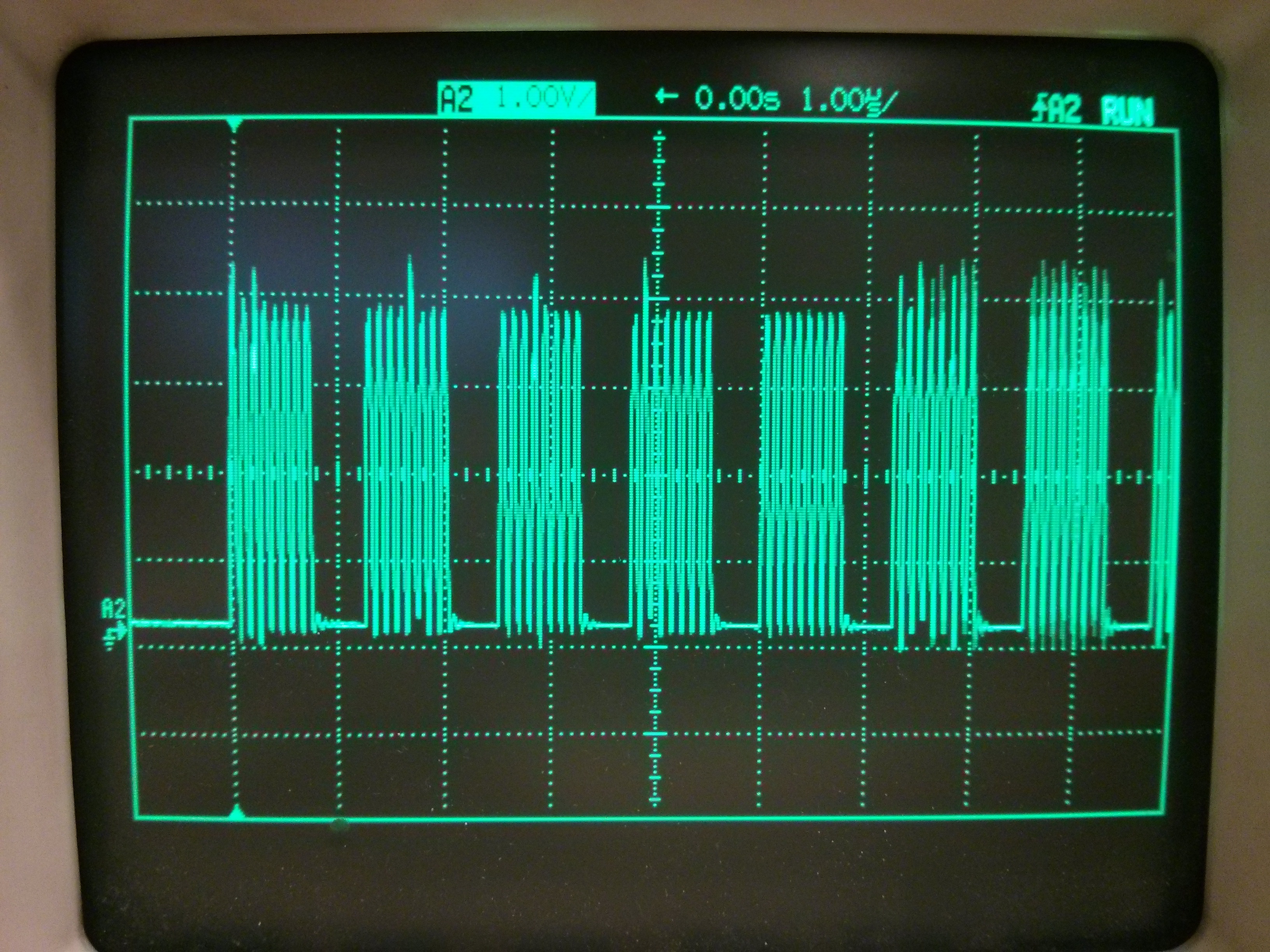

    3) I hooked up the oscilloscope to the  header pins on the eval board. The SCLK signals are pretty bad... I think it is from the ribbon cable I used (30cm long)

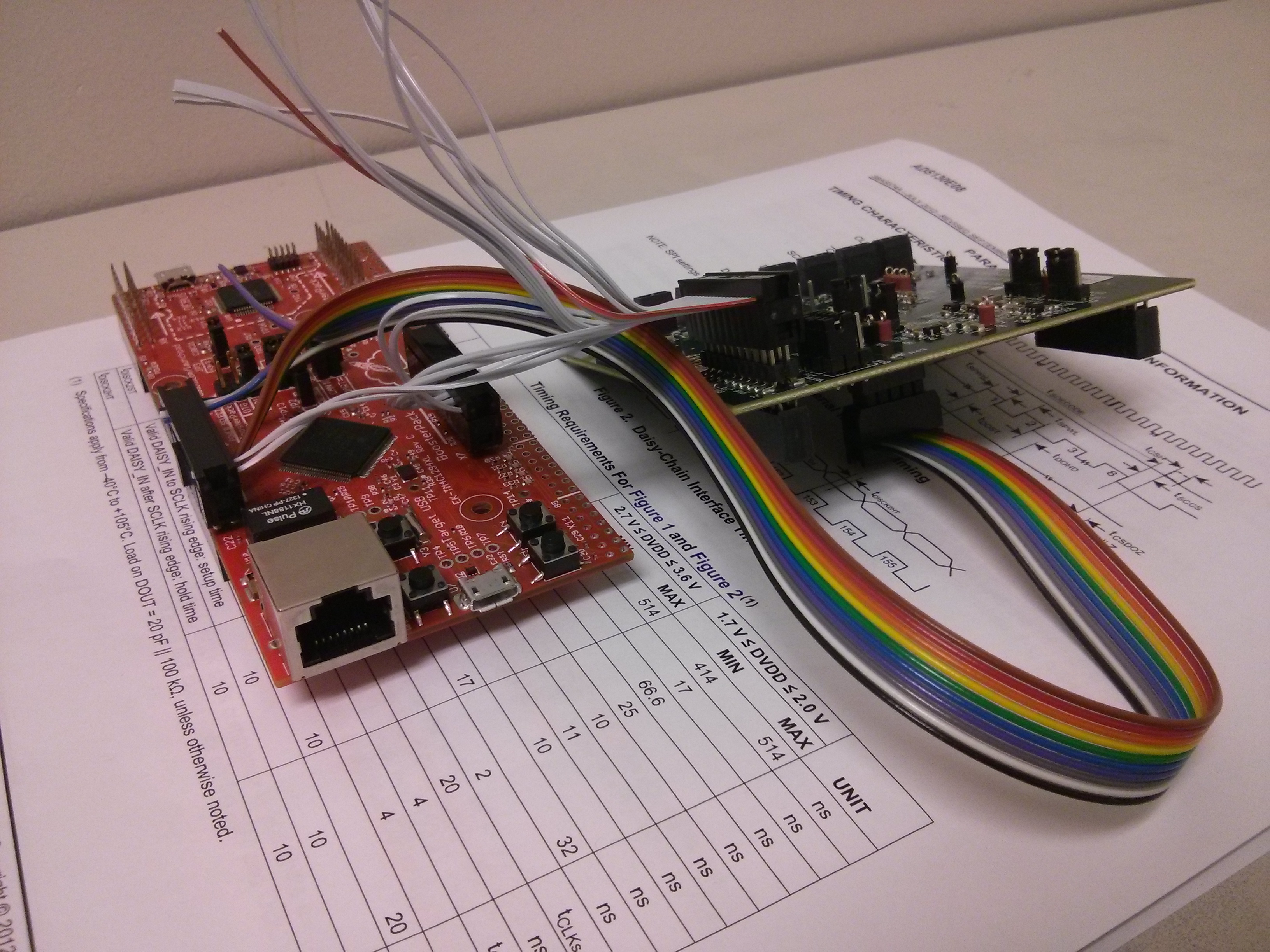

    Could this be the root cause of the problem? How long can the ribbon cable from TIVA to eval board be?
    Stephen
    See attached pictures.
  • Hello Stephen,
    Purely, my experience with SSI and cables have been not so good either. Never have I tried more than 3" of SSI and expected higher frequency of operation. I prefer to do a solid PCB with SSI (no cables) and ensure that route delays are well managed.
    Amit
  • Hi Amit,
    I cut the cable to 2" and set SCLK to 5MHz. Results seem to be the same (only 1MHz works, higher frequency I get data but they are wrong)

    Is this the slave's doing? or TIVA SSI register not clearing properly? I use SSIDataGetNonBlocking to empty FIFO.
  • Strictly an aside - but our tech group "has" succeeded w/IDC ribbon cable at lengths up to 250mm & at clock rates of 10MHz.   One trick we've found - is to interpose ground between each/every signal lead.  (thus you can accommodate 4 signal SPI w/a standard 2x5 IDC cable/header assembly - power routed separately)
    You may also consider CAT 5/6 cable for high frequency work.
    You once mentioned an Eval Board.   That ADC may be too demanding for prototype work - is it part of a pro eval board?  And have you recently measured the power - at the ADC IC?   (and while running @ full speed?)
    From experience - we know Amit's SW works - it's unlikely the ADC has a design glitch - that points (heavily I'd say) at your ADC board/cabling/powering!

    (btw - that 2nd scope cap showed much improved signal edges - I'd wager good stack of chips your issue is ADC layout, interconnect or power problem.   Always blame yourself first - chips last!)

    ADC board in your photo looks "real" - yet the multi-color ribbon is (likely) too long & the gray ribbon appears (pardon) unkempt - unlikely to support high speed signals!  If you can some way/how configure your interconnect ribbon as: "G-1-G-2-G-3-G-4-G-G" where G is ground & each # represents an SPI signal - things (likely) will improve.
    Another concern - marketing chose "launch" for your MCU board - but it very well may be that it's unable to adequately power a serious accessory board - especially when you, "Call for Speed!"  As past stated (my earlier post) have you measured the ADC's power pins - when operating at high speed?  Under demanding conditions - your launch board may reveal itself as, "slight push" pad.  (and - that too - has a neat ring...)
    Yours is (I believe) a system-design issue - unlikely an MCU nor ADC one - and you must "bullet-proof" all elements to gain full performance.

    I made new cables and the SCLK are much better.
    As before, I have always been able to read and write to the ADS. It's just the quality of data returned is not good.
