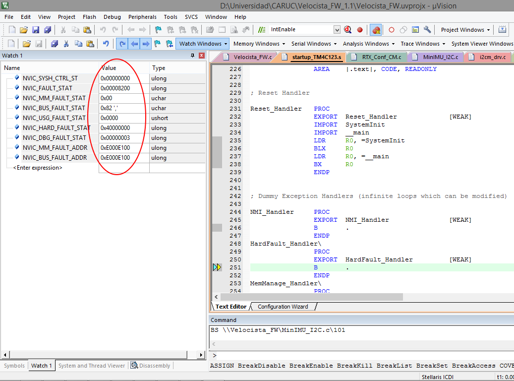

finali in debug i'm detect the code that generate the hardfault esception
in line:
I2CMInit(&g_sI2CMSimpleInst, I2C0_BASE, INT_I2C0, 0xff, 0xff, 120000000);
function go to enable interrupt in file i2cm_drv.c
MAP_IntEnable(ui8Int);
and finaly execute this code in interrupt.c
        // Enable the general interrupt.
        HWREG(g_pui32EnRegs[(ui32Interrupt - 16) / 32]) =
            1 << ((ui32Interrupt - 16) & 31);
and go to hardfault exception
and the rebuild not generate errors
Thanks  for your help !!

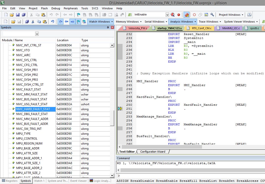

  • Hi Raul, value of fault register are necessary to completely diagnose fault, first sticky notes on this forum address the frequent cause of fault and malfunctioning, try read them and if persist publish fault register as explained on that post.
    I don't see I2C init code of GPIO if not external from before to launch RTOS task can be the main cause of HWFault. are you using TM4C129 series? If not 120MHz are excessive so lower the clock too.
  • Hi Roberto, thanks for your reply, sorry for not explain i2c init code, this is post in PortFunctionInit(); generate whith tiva c series pin mux utility in init task, all de tasks used gpio, pwm, qei, adc, uart, use this function for gpio config in task init, all funcion ok but the I2C not.
    In EXPORT HardFault_Handler it's equial to 0x000004B6 i dont see if this value its a fault register.
    I'm use Tiva C TM4C123GXL, the 120 MHz it's copy paste error : ), i'm change for 80 MHz but the error persist.
  • Hi, check all point of this post:
    e2e.ti.com/.../374640
    check issue 2 for I2C and issue 6 for Fault and register we need see.
    If you ported code from 129 to 123 read also the part I added in reply to Amit analysis.

  • Hi Raul, is fault stat reporting precise address? or not? if so cause of fault is at address and you can point to where Fault is fired, as I wrote take care about clock, on overclock random Fault occour and are untraceable nor are deterministic too.
  • Hello Amit,
    I'm find the FAULTSTAT and FAULTADDR register value, and I attach the print screen image with error code values. Thanks for your help.
    Raul.
    1
    -1
  • Hello Raul,
    What is the data in the two registers? That is not visible in screenshot.
    Amit
  • Hello Amit,
    Sorry I'm not see the columns name, i'm send the screenshot with value for registers:
    Raul
  • Hello Amit,
    I'm upload new image whit data values for the error registers, thank's for your help.
  • Hello Raul,
    Now the Fault Status indicates that the Bus Fault Address is valid and it is a precise bus fault, so the fault address registers should contain the faulting location. The Fault Address does not seem to indicate any valid address. This means that an attempt to write to the flash was done. I would have to again ask you to narrow it down the code section which results in the fault.
    Amit
