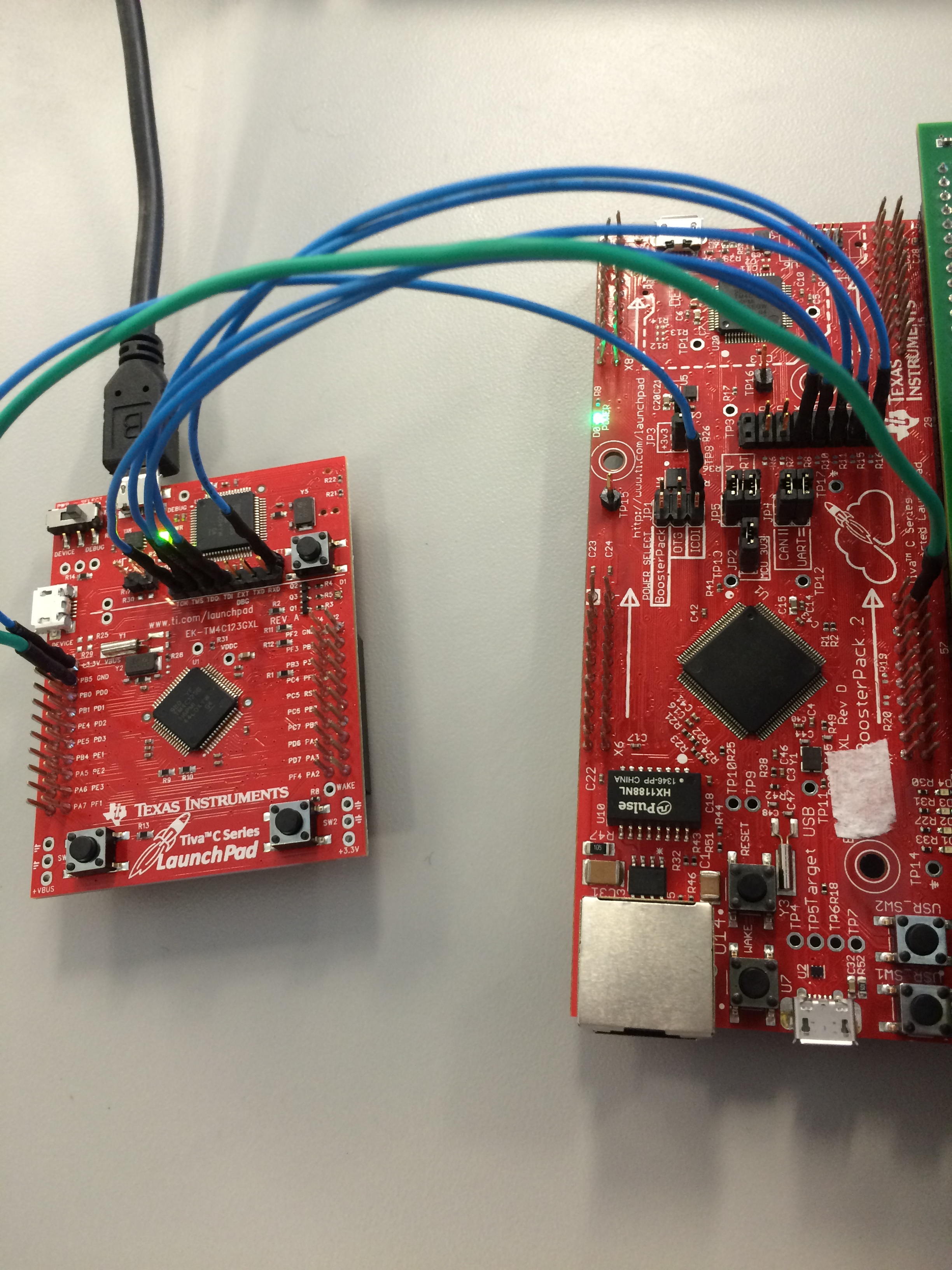

Microcontroller used in custom board design: TM4C123GH6PZ
Programmer: ICDI EK-TM4C123GXL
Software used for Programming: LM Flash Programmer Build 1613
 Programming Issues:
Programming new board is done without errors. But programming already programmed board is not successful every time.
Error received
  • Error: Programming error 0x1
  • Verify Address Failed: 0xXX
Also, programming using CCSv6.0 never gives error.
