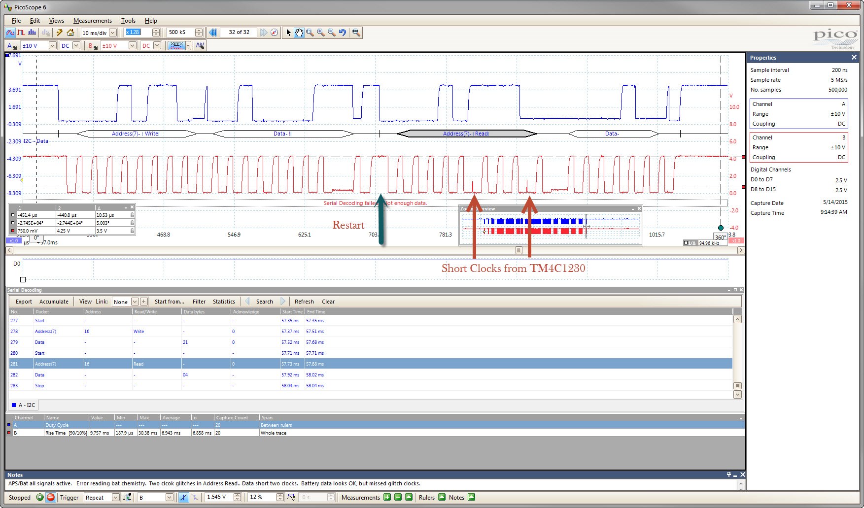

SMB/I2C short clocks look like glitches to slave
I am having problems reading reliably over SMBus using the Utils.
I have tracked down one type of error as an apparent glitch by the TM4C1230 sending out a short clock pulse in the middle of shifting out from the TI Master.  Byte address being sent should be 17x to be a read.  If the glitches are counted as valid pulses, the address would be 17.  The clock before the next glitch would be where the ACK would come (but the slave lost sync by rejecting the glitch, so it didn't pull data low to ack.
If the glitches were not supposed to be clock pulses, the transmitter stopped clocking too early - there are only 16 full scale pulses in the Read Address / Read Data sequence when there need to be 18.  But there are two short pulses.  This leads me to believe that these pulses are not noise, but are abbreviated clocks.
I don't see any way that the software could shorten the clock pulses.
Any ideas?

    Yes, this has the same behavior on multiple boards. We have checked the normal things - power supplies are quiet, trace routing is good.
    I see more errors on the SMB ReadBlock than ReadWord. This makes sense as the blocks are normally 5-25 characters, while words are only 2 bytes.
    There are two batteries attached. Each is on a different SMB port with no other devices.
    The battery is usually "Slave", but may become "master" to broadcast alarms or commands to the charger. This initially created bus faults until I figured out how to handle bus-busy (Usually, just wait for the battery-master to finish it's transfer).
    Yes, this packet works 99.5% of the time.
    I have tested with a non-battery SMBus slave. It is still on the same address, but has a limited number of Smart Battery registers that it supports. It never becomes a master, so I have eliminated the two-master conflicts. I get the same sort of errors.
    Added PEC helps - I can detect an error and retry. Even with up to 5 retries, the packet transfer occasionally fails.
    I am trying to get to 100% reliability - or at least 99.99% after retries.

    And this is with the Glitch filter enabled as in the earlier post from you? Could you send the Baud Rate configuration and System Clock Configuration functions?
    Amit
  • Hi Amit,
    As I read - it is your MCU's (output) clock pulse - which (appears) to be glitching!    Is the glitch filter intended to prevent an (MCU output) glitch?
  • Hello cb1,
    Yes, i understand that. The I2C Module works by sampling the SCL on the bus to determine Clock Stretching. So if the glitch is being generated (which I am not sure it will unless at the time of glitch we can determine if a low level was put by the slave) which causes the master to abort the clock but yet sample it as a valid edge, then it would help get a correct clock pulse.
    Amit

  • Yes, this is a continuation of the original issue.
    I found that I was not handling errors from the SMB stack correctly.  When I started handling BUS_BUSY, ARB_LOST, BUS_TIMEOUT, reliability got much, much better.    In that case, I had clocks that were fairly wide - and short.  Once I correctly ( or at least more correctly ) handled these errors, the runt pulses went away.
    My config code is based on using the library reference:
    uint32_t SysClk = SysCtlClockGet();
    SMBusMasterInit(&Context, BaseAddress, SysClk );
    IntPrioritySet( InterruptAddress, 5<<5 );
    // Set up glitch filter.
    I2CMasterGlitchFilterConfigSet( BaseAddress, I2C_MASTER_GLITCH_FILTER_32); // todo
    SMBusMasterIntEnable( &Context );
    MTPR was correctly set at 18x (100Khz).
    The set up of the glitch filter does not appear to be correct when I use the call to I2CMasterGlitchConfigSet.
    void
    I2CMasterGlitchFilterConfigSet(uint32_t ui32Base, uint32_t ui32Config)
    // Check the arguments.
    ASSERT(_I2CBaseValid(ui32Base));
    // Configure the glitch filter field of MTPR.
    HWREG(ui32Base + I2C_O_MTPR) |= ui32Config;
    It is attempting to write to the MTPR which has no bits in the shifted position.  It should be writing to I2C4MCR2.  Also, it never sets up the GFE bit in I2C4MCR.

    It is clear that it is putting the value into the wrong register.  It should be MCR2 per the datasheet The defines for the values are also wrong:
    #define I2C_MASTER_GLITCH_FILTER_32 \
    0x00070000
    Finally, the routine doesn't set the GFE bit of MCR.
    I will change my code to:
    HWREG(BaseAddress + I2C_O_MCR2 |= 7<<4; // Set to 31 clock glitch filter
    HWREG(BaseAddress + I2C_O_MCR) |= I2C_MCR_GFE; // and enable now
    I should have checked the registers earlier.  I had hoped to leverage libraries.
    I will let you know how this works.
  • I made the changes and ran 100,000 messages (32 different registers, ranging from 2 byte to 30 byte transfers) with no errors.
    So, as you pointed out a couple months ago, the problem was the Glitch Filter settings.
    Shame on me for trusting the libraries. Is there a way to report a bug against them?
    Thanks for all your help. CB1, you helped too by asking your last glitch question. Thanks!
