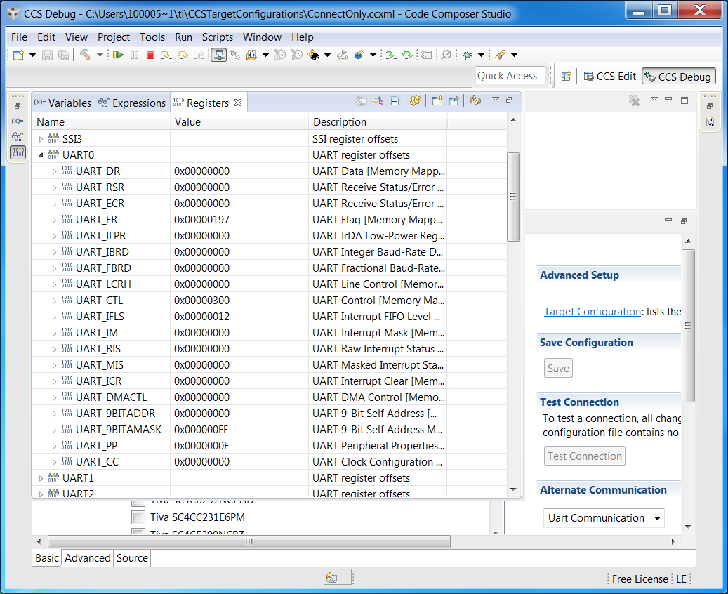

  • Got it.  Was not connected.
    Inline image 1
    Here are the flash registers.  BOOTCFG is 0x7FFF30FE     Tried using the unlock command of uniflash to get NW bit back to 1 and in the process, I have two Launchpads that I can no longer connect to with any tool :(   Anyway, 30FE should work for me.  GPIO PB4 is grounded and when I do that before reset, the program in flash that flashes the Leds is not running anymore - a good sign we are now in the ROM bootloader.

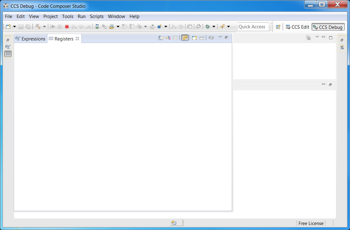

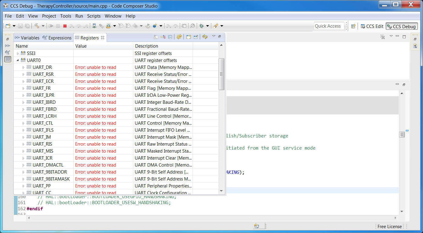

  • Hello Randall,
    It looks like the UART is not configured at all for Baud Rate. The register for Integer and Fractional Baud rate both show 0x0. Can you get the same snapshot by doing the entire process except running sflash (so that Auto Baud or Boot Code does not touch the UART configuration)?
    Also a snapshot of the CPU registers. Did you check if the PC points to ROM address space?
    Amit
  • Tried again, here is the screen cap.  Its not displaying the registers.

  • Hello Randall,
    From the snapshot: The debugger is not connected. Notice that one of the two buttons should be Active.
    Amit

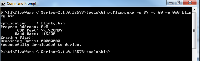

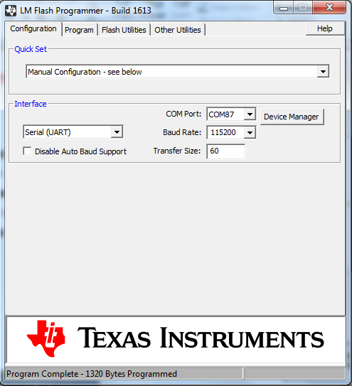

    I am using LMFlashProgrammer with the following setting. Can you attempt to do the same? Also can you send me the full command line for sflash.
    NOTE: COM port may be different on your PC.

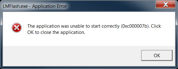

  • I have never been able to get LM Flash Programmer to run.  I have tried reinstalling visual studio redistributables per what I found on the web about this generic error.  Nothing works.  Seems to be a dll issue but I don't know which one.  My laptop is x64
    Inline image 1

  • Hello Randall,
    I tried the same and it works with sflash.exe (I removed the -d as with -d it does not work)
    Amit
  • That's what I thought.   I had read that autobaud was needed and the -d disables autobaud.

  • Amit,
    I was not able to program my EK_TM4C1294XL launchpad using sflash with the bootcfg enabled pin asserted. When you programmed blinky using sflash, which launchpad did you use and how exactly were you connected into uart 0? I have a usb to serial converter cable with txd and rxd tied directly to uart 0 PA0 and PA1 of connector x11. Not sure how the "debug" processor ICDI on the board factors into this.
  • Hello Randall,
    I am using EK-TM4C1294XL (there is only one TM4C129 LP right now). The issue you are facing is the fact that the ICDI on the LaunchPad is connected to the TM4C129 for UART0. So both the ICDI MCU is driving UARTRX and so is the USB to serial converter (bus contention). The only way to resolve that is
    1. Do not use the converted but the on board ICDI.
    2. Remove the resistor R6 and R7 to prevent ICDI from driving the UART0 of the TM4C129. They can be reconnected by using the 100 mil jumper headers right next to R6 and R7.
    Amit

  • On thing that is really strange. I am able to call ROM_UpdateUART from my program after setting up uart 0 for 115200 baud and using the usb to serial cable connected to the uart 0 pins on connector x11, it downloads fine. That should not have worked because of the contention issue. But it does. Its only when using the BOOTCFG pin to launch ROM update, that it fails. Strange.
  • Hello Randall.
    That is a good point you raised and I need to look into the same. But to unblock you I suggested "method 1".
    As for the issue with Pin, I would need more info as I do not have your setup-application code environment: Does the UART update work if the device is erased and then you try to flash the application code when using USB to Serial Converter? This is to eliminate some code artifacts.
    Amit
