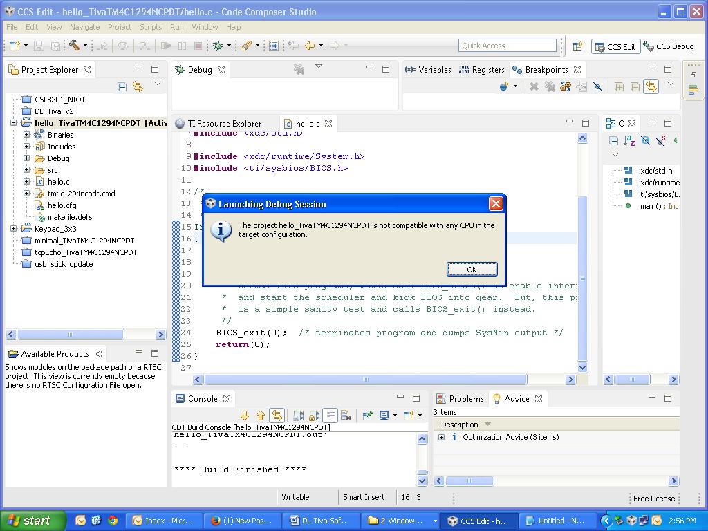

I purchased Ek-TM4c1294XL evaluation board last month.  Now i want to do some software development using this board. For this first I used your given example i.e. hello_TivaTM4C1294NCPDT. I compiled this example it is done but when i tried to load on the development board, it is not happening. For this I am attaching snapshot.

    Clearly this example is not coming from TivaWare but from TI RTOS. I would ask to run the basic examples from TivaWare first to validate the authenticity of the exercise

    This problem is solved. This was happening because of not selecting the Stellaris In-Circuit Debug Interface from properties--> General--> Connection in CCS.
