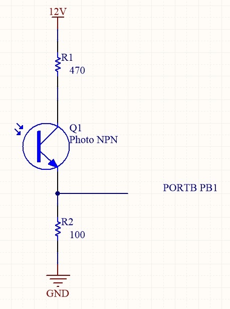

And finally, this is the circuit I've used to generate the digital signal:
Some clarifications:
i)  I've connected every other PORTB input to GND through a 100ohm resistor, so they don't generate "false" interrupts.
ii) I've used 100 ohm in R2, so I can use the "Weak Pull Down" option.
iii) I've correctly added the Interrupt Handler in the Startup file.
iv) The digital "high" signal voltage level, is around 3V (As PB1 can stand up to 3.6V)
v) I've checked the errata, but It doesn't mention any failure regarding PB1 input.
When I execute the program, I'm having the interruption permanently triggered, even when there isn't any voltage present in PB1.
When I DO trigger the sensor, (i.e, obtain the 3V in the pin), I don't get any response at all..

  • OK, apparently I've solved it. I had a "floating GND" issue.

  • Hello Martin
    Floating GND of the input reference circuit to the TM4C?
    Amit
  • Hello Amit,
    Yes. The GND of the input circuit wasn't connected with the GND of the TM4C. A most obvious mistake wich passed right under my eyes.
    It was, of course, picking every available noise ...
    Thanks for the reply.
    Martín
