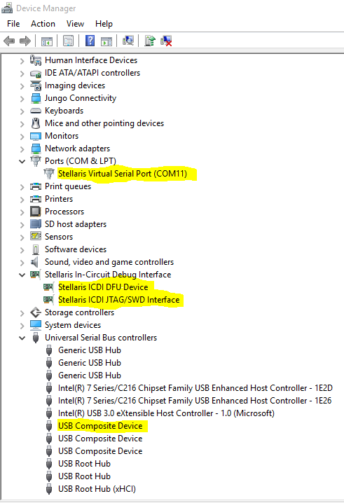

  • I managed to make ICDI drivers work on Windows 10. I am using Stellaris Launchpad Tiva C. Before I was working with Windows 8.1, but recently upgraded system to Windows 10 with automatic updates and lost communication with development board. Code Composer Studio started to display message "Frequency out of range..." error and LM Flash Programmer was unable to find the target. I noticed that driver is displayed differently in Device Manager: it was recognized as Stellaris Virtual Serial Port and USB Composite Device only.
    What I did?
    1. Determined which USB Composite Device is corresponding to the development board.
    2. Uninstalled and removed driver form Stellaris Virtual Serial Port.
    3. Uninstalled driver for particular USB Composite Device.
    4. Installed driver from CCS directory again.
    After this development board was recognized differently with additional section Stellaris In-Circuit Debug Interface in Device Manager (see screenshot below).
    P.S.: I am not explaining how to install unsigned drivers in case if corresponding message appears - it is trivial task described on this and other forums.

  • Hello Pavel
    The additional section has been there on Win7 and Win8 as well.
    Amit
  • Exactly. That's what I am talking about. But initially in Windows 10 it was not recognized this way.
