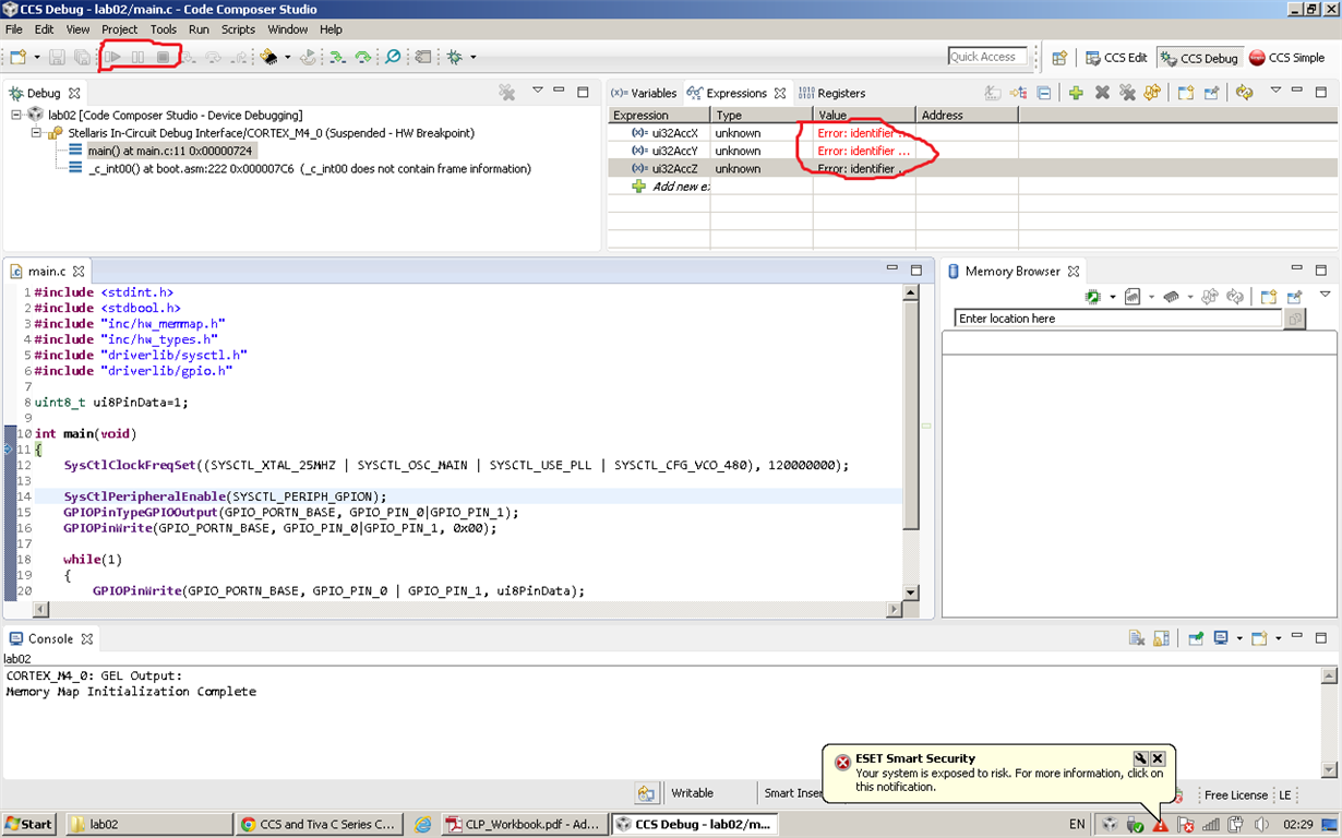

  • I load bin file, but as i understand  air mouse is not for connected launchpad
    i have problem with buttons of CCS6, can't use for example Resume(run) button
  • Hi bode,
    The airmouse is for Tiva Launchpad + Sensor Hub. It will work for Tiva Connected Launchpad + Sensor Hub, provided you made the correct changes.
    Go through the lab 2 workshop procedures again at the workbook.pdf. I think you did not "Add the INCLUDE search paths for the header files". This is mentioned at page 53 of the workbook.pdf.
    - kel

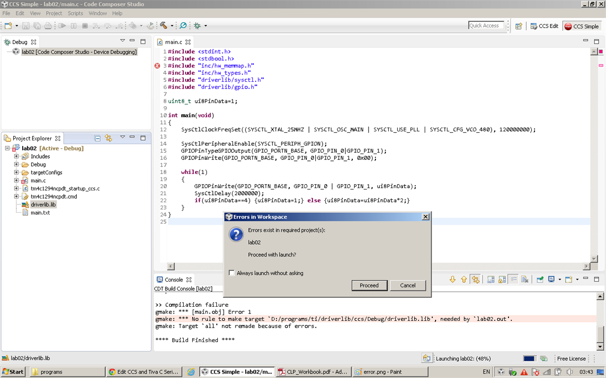

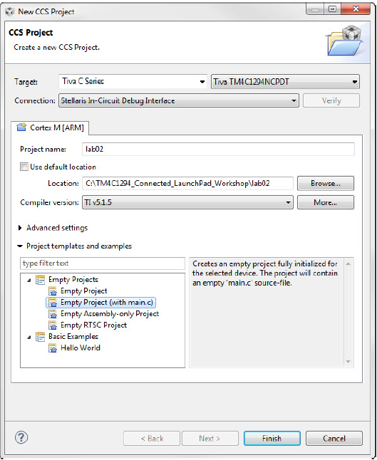

  • now i fix this problems with link  variable "tivaware_install" but still buttons are not available and some red problems, i hope they are not big problems
    The project description file (.project) for 'lab02' is missing.  This file contains important information about the project.  The project will not function properly until this file is restored.
  • Hi bode,
    I followed the Lab 2 procedure before, and I did not encounter this error "The project description file (.project) for 'lab02' is missing" error. Attach your lab02 CCS project here, so others can review it.
    I suggest you delete the Lab 2 CCS project and then start again with the procedures.
    - kel

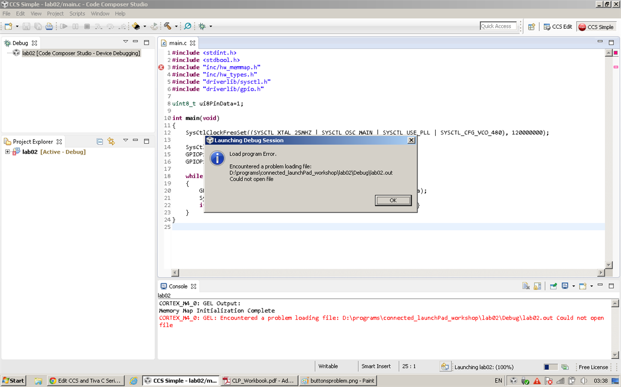

  • I delete files in lab02 folder, because i couldn't finish project(project or folder already exist i am showing it down copy from workbook.pdf).  .project file was on place, but i restore last .project file from recycle bin. When i start to debug program, LED 1 and LED 2 are startink to blink, but after that they stop.
  • Here is my folder
    I have this error CORTEX_M4_0: GEL: Encountered a problem loading file: D:\programs\TM4C1294 Connected LaunchPad Workshop\lab02\Debug\lab02.out Could not open file
    lab02.rar
  • Hi bode,
    I imported your CCS project and the build errors remain as you have earlier mentioned here. I noticed that the project file is named lab01 and within the folder lab02.
    I just tried the lab02 project procedures again and it works. I suggest you delete the lab02 folder at your workspace and start again.
    The TIVAWARE_INSTALL path location at vars.ini should be correct. At my vars.ini this is set below. vars.ini is mentioned at page 41 of the workbook.
    TIVAWARE_INSTALL = C:\EK-TM4C129
    C:\EK-TM4C129 is the folder location of my Tivaware for Tiva Connected Launchpad.
    I encountered an error "#1965 cannot open source file "inc/hw_memmap.h" main.c /labtest line 3 C/C++ Problem"
    After, I set ${TIVAWARE_INSTALL} at Include Options and build, the error go away. Setting ${TIVAWARE_INSTALL} is mentioned at the workbook.pdf at page 55.
    - kel
  • Hi Markel,
    Yes i was select name for project lab01, because else it reject my project(existing name).
    My TIVA_INSTALL=D:\programs\TivaWare_C_Series-2.1.0.12573

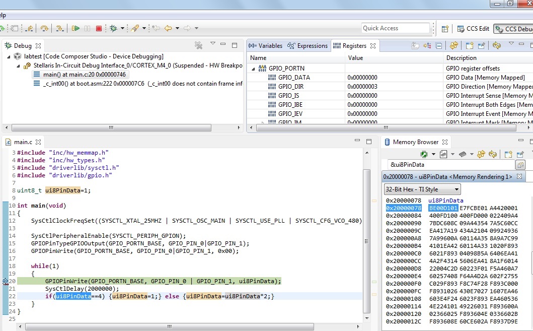

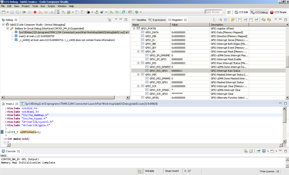

    And now program is working as  you say i make steps for lab02 procedure and now when run program D1 and D2 is blinking. When i push pause button it stop and show me mistake like it is wroten on Workbook.pdf.No source available for "SysCtlDelay() at D:/programs\TM4C1294 Connected LaunchPad Workshop\lab02\Debug\lab02.out:{3} 0x996{4}"
    In Workbook.pdf it is wroten to make breakpoint on row that is GPIOPWrite, but if i make there breakpoint D1 and D2 are lighting like before. When breakpoint is on while cycle first one D is on and on next run another D is on.
    Btw for registers it shows me in value unable to read.
    CCS chapter is ending and i think if it is possible to try some examples for sensor hub.
  • Great to know that you already made it to work.
    The "one D is on and on next run another D is on" is normal.
    Go over the instructions again at the part, to see the register values. Here is my CCS screenshot below showing register values.
    - kel
  • Well i just debug program and when i watch registers they was okay

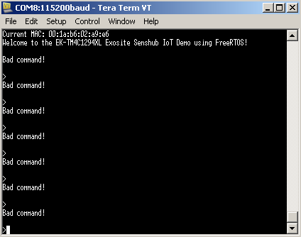

      3. Type help and press the Enter key. You should see a terminal window like the one shown below.
  • Hi bode,
    At Tera Term, you need to set COM Port to Stellaris Virtual Serial Port and set baud rate to 115200, to see the output.
    - kel
  • Here i found settings about it, just changing baud rate. I had done it before but now again have to change it to 115200
    applied-knowledge.blogspot.bg/.../setting-up-putty-or-tera-term-for.html
  • but how to slow down speed that in shows me data, for one sec i have about 100 rows of data for temperature and pressure.
