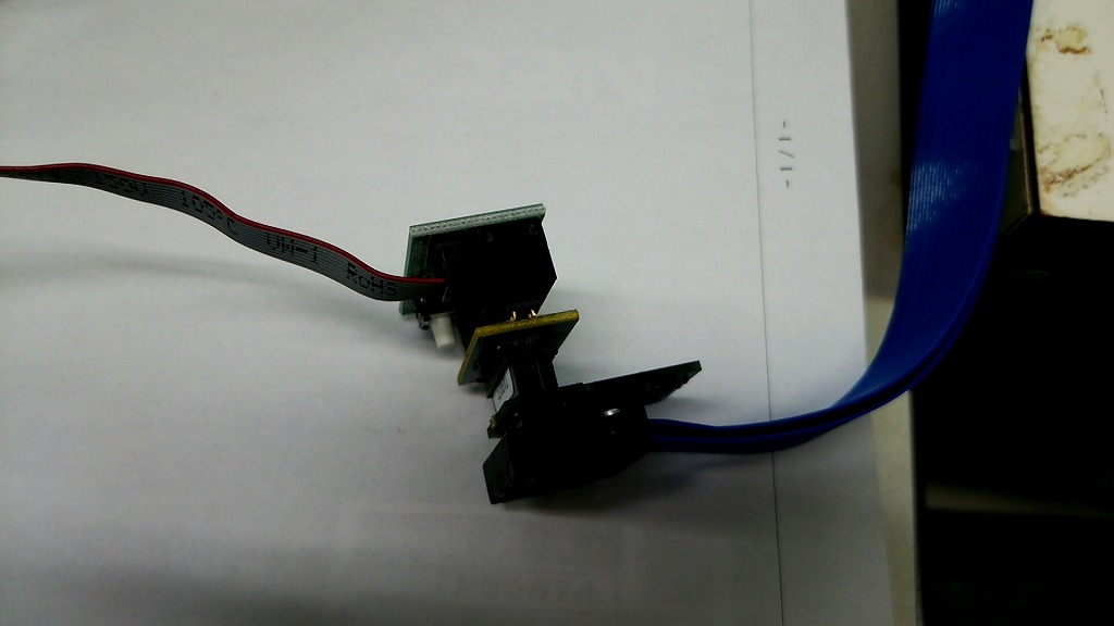

  • Hi, Amit
    We can not connect 10pin Target board with MDL-ADA2 and XDS560.
    I show you picture.
    Is this connection correcct?
    Best Regards
    Hiroyasu
  • Hello Hiroyasu,
    Please note that in my previous post I did mention that the pin compatibility of the assembly must match the final header. Did you do a paper check of the same?
    Amit
  • Hi, Amit
    Yes, We already check final pin out is same.
    but we can not connect.
    We get this error.

    Do you know why it can not connect?
    Best Regards
    Hiroyasu
  • Hello Hiroyasu,
    It means (a) the ccmxl is configured to use a RTCK while we do not support RTCK or (b) the pins are not correct between the header of the debugger and the board.
    Amit

  • Hiroyasu said:
    Can you tell me how to configure to use RTCK
    Based upon a different emulator USB-BH560M I would have expected a lack of RTCK from the target to cause a different error of the form 'Dead JTAG Clock', as opposed to the 'SC_ERR_CTL_CBL_BREAK_NEAR' error you are seeing.
    In the case of a Spectrum Digital XDS560v2 STM USB Emulator, if the target isn't supplying a RTCK try setting the "JTAG TCLK Frequency (MHz)" option in the Target Configuration to "TCLK looped-back with user specified limit" to see if that changes the error. Also, try setting the user specified limit to the lowest frequency of 0.5MHz to see if that helps.
  • Hello Chester, Hiroyasu,
    TM4C does not support RTCK. The option for using adaptive clocking should not be used
    Amit
    Agreed that the TM4C and Stellaris devices do not provide RTCK at the device level. JTAG configuration for CCS and Stellaris and Stellaris Emulator Compatibility have more detail on this.
    With a XDS560v2 class emulator the recommendation on those referenced Wiki pages is "configuring the software controlled loopback capability on the target configuration file", which is the selection of  "TCLK looped back with user-specified limit" with a maximum frequency of 10MHz on XDS560v2 class emulators.
