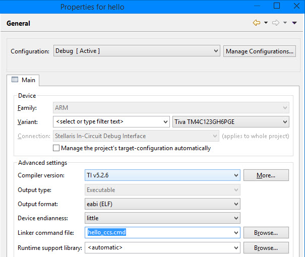

    1. You mean the linker command file in the Project -> Properties -> General -> Main tab -> Linker command file?
    I look in the Hello demo, linker command file is “hello_ccs.cmd” (navigate to C:\ti\TivaWare_C_Series-2.1.2.111\examples\boards\dk-tm4c123g\hello)
    But in the SPPLDemo, it is blank. I went to SPPLEDemo folder but didn’t see any “.cmd” file like in Hello demo(except file “linker_ccs.cmd” at …\SPPLEDemo\NoOS\startup\dk_tm4c123g, but it also appear in the SPPLEDemo in Project Explorer).
    So now I still don’t know how to link the driverlib.lib with the SPPLEDemo. Hope you can instruct me a bit clearer. Thanks a lot.

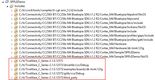

    2. Anyway, I solved the problem by using a trick, I think.
    I took notice of the “Include” path of SPPLEDemo and thought the demo was linking to C:\ti\TivaWare_C_Series-2.1.0.12573.

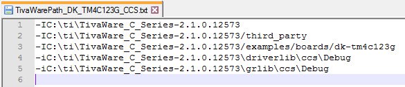

    And in the TivaWarePath_DK_TM4C123G_CCS.txt in C:\ti\Connectivity\CC256X BT\CC256x M4 Bluetopia SDK\v1.2 R2\Cortex_M4\BuildScripts, paths are also TivaWare_C_Series-2.1.0.12573.
    I tried to change them to "TivaWare_C_Series-2.1.2.111"(current version) and build, but it still report error. After that, every path I have just changed was back to initial state(old version). I don’t know why and how to change this totally.
    Finally, I decided to create a new folder name “TivaWare_C_Series-2.1.0.12573”, and copy several folders(including driverlib, examples, grlib, inc, third_party and utils) from TivaWare_C_Series-2.1.2.111 folder into it. Luckily there is no error report when I build SPPLEdemo again. I download this demo into TM4C123G DevBoard and it’s work.(oh yeah!)
