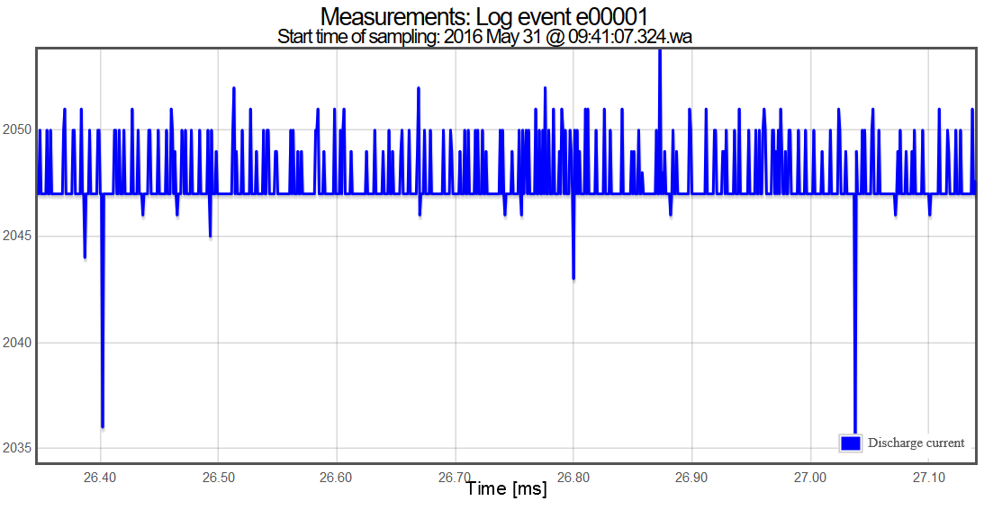

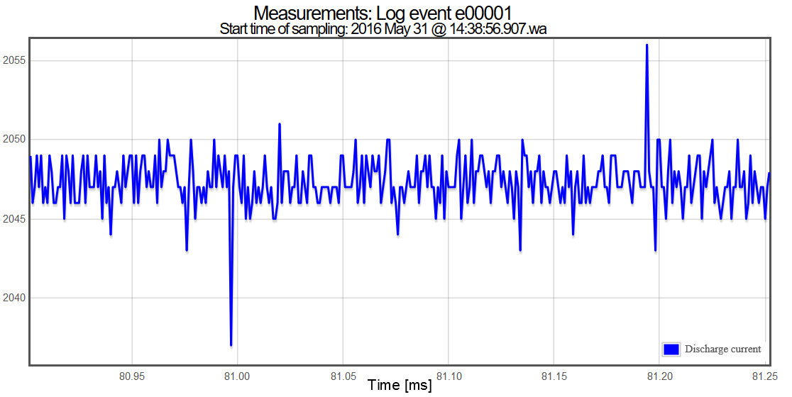

At the Ain2 A/D input, noise spikes are observed at fixed DC input. The device is TM4C129ENCPDT silicon rev 3. See this recording:
When zooming it looks like this:
The input is a resistive voltage division from the separate power supply (3.3V) for the analog GNDA and VREF+/VDDA. The input is filteret by a 100nF capacitor to GNDA and all components are placed few mm from the device pins. VREFA+ and VDDA pins are tied together. The actual test is for full speed 2 MSPS, but the same result shows for 500 KSPS. I have tried 64 clock Sample/hold but it does not affect these pictures. The errata tells about spikes at the Ain0, but not at the other inputs. The PCB is well designed using 4 layers. The processor is running RTOS and Ethernet traffic at the same time. Configuration is 'ADC_TRIGGER_ALWAYS'.
Any ideas if this is an expected behavior or how to make better performance in terms of noise ?

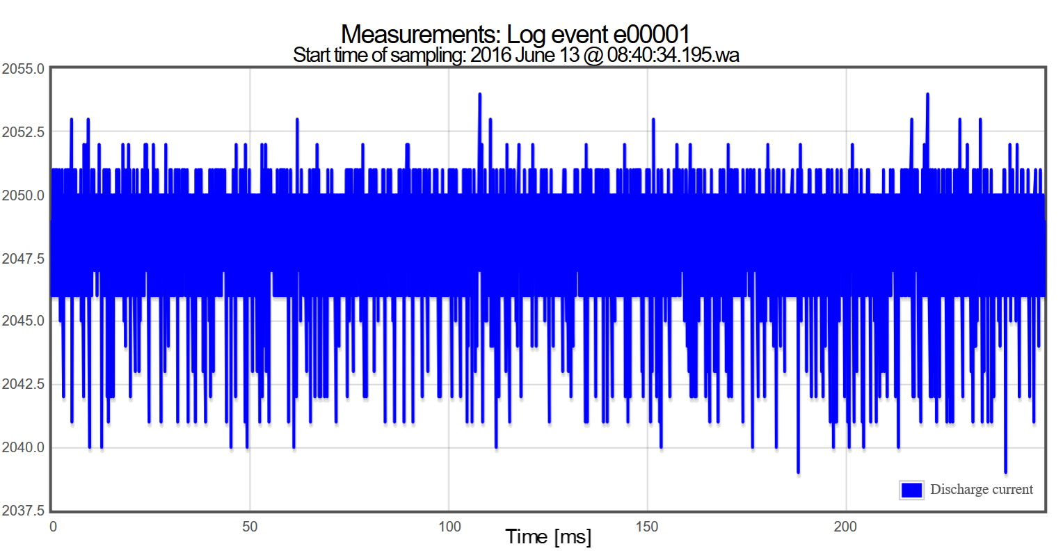

  •  -good point in testing on more boards- Just did, same story, see picture.
    -Power supply is a few mm from the MCU pins (LP2980-3.3)
    -Small ferrite and large filter caps are in place (1uH, 10uF/100nF)
    -The resistor are simply two 2k6 dividing the 3,3V VDDA supply. 100nF in parallel with lower resistor.
    -good idea to extent sampling time - tried 64 clocks, same result
    We are performing uDMA transfer to some big arrays into a combination of internal RAM and external RAM. An internal transfer generates raw wave files (true data) to output through a web interface as download and direct view as shown here.

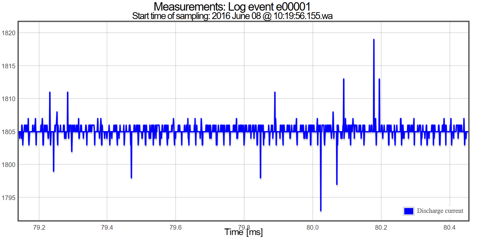

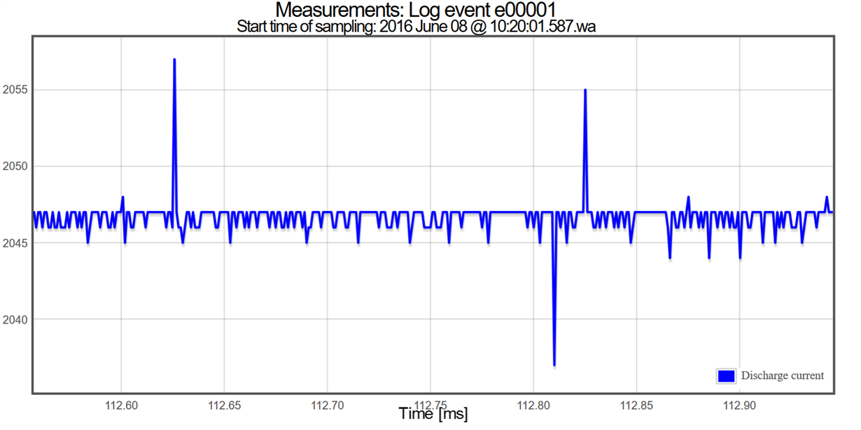

  • Thank you all for your ideas and inputs.
    Latest test have been:
    - Use of small battery in parallel with 100nF and 2n2F as input to the ADC - no change in signal noise:
    - Adding bead in series with digital supply for the processor - no change
    It seems as if some internal noise is disturbing the conversion. The noise seems without a specific frequency. It might be in the SAR itself as an increase in sample/hold time-clocks does not make any change to the issue.
    It could be of interest if anyone have made a similar setup and having good results ?
    Then at least we could try to replicate such conditions.

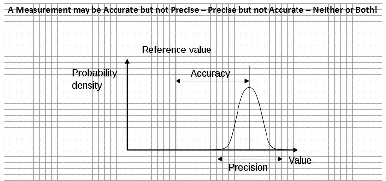

  • Perhaps (surely) time for cb1's (famed) "reach reduction:"
    Our poster claimed, HW averaging "is said" - to reduce throughput - beyond "said" - that IS the case.  (averaging by "n" requires "n" samples to be required & processed - which (clearly) takes longer than individual samples.)
    He then (reaches) with, "...sample range with reduced precision."  The distribution (bell-curve) above illustrates the futility of that reach...
    Note the power of the diagram and the (inspired) language - which "startle" - then assuredly, "drive home the point!"
  • Perhaps precision is not the proper word yet the visual reproduced samples sent for scope plots have far less amplitude swings. For instance the ADC temperature sensor readout and other digital readouts of analog samples are more stable around a central value versus the large swings in the output values otherwise with out hardware averaging enabled.
    Plausible the sample rate average period constrains the range of the SAR stepping capability of capturing the entire spectrum of the analog channel signal. What ever it is doing the ADC sample have far less noise spectrum in the desired signal.
  • Chart above your most recent post provides the "means" to select the "correct" word.
  • Perhaps consider your bell curve is an example of not having Hardware averaging enabled and basic ADC sample periods.
    If the intent is to capture every finite detail of the analog signal then you sacrifice accuracy to achieve greater band width based on precision of SAR following every nuance of the analog input signal.
    If by accuracy the curve infers an exact digital value represents the desired signal output then oversamples will reduce precision, increase accuracy and provide less bandwidth for precision. Turning down the volume (through put) must reduce the input band width (SAR step range) and increase the accuracy as a result.
  • BTW: Notice the value curve goes vertical for accuracy and broad spectrum for precision.

  • That accuracy span ray is a bit ambiguous unless the vertical line (center bell curve) represents the probability density increases as the bandwidth narrows around the reference value. Again the precision density is reduced yet the band width widens around the reference value at the very bottom of the precision span.
    Lots going on in that bell yet where is both precision and accuracy existing together in the bell at the same band width? Seems to me there is a trade off being elaborated in the illustration since probability density is never equal at either end of top or bottom of the curve.
  • My friend - do you not (most always) "shape-shift" and add complexity - where there is little? (or none)
    My drawing delivers exactly as its title states - it (clearly) illustrates the difference between Accuracy & Precision.
    You claim that, "Lots going on in that bell (curve)" yet fail (completely) to list and/or identify a single event! (going on) That bell curve represents the collection of measurements - nothing more - nothing less - thus is (hardly) representative of, "Lots going on!"
    No "bandwidth" - as you introduce - is presented w/in this curve - its entire intent is to address the (almost) chronic "misuse" of accuracy & precision!   (in a memorable and highly illustrative (i.e. educational) manner.)
    If we don't understand (basic) definitions it becomes difficult (if not impossible) to fully/properly/effectively communicate - such deserves (some) consideration - and motivated this cb1 presentation...
  • It's illustrating definitions not tradeoffs. There is absolutely no indication of bandwidth in the diagram, that's all in your fevered imagination.

  • Again that is your opinion and you are entitled to it but there is no context included for the subject matter to suggest neither or both can exist! That is a fevered concept both precision and accuracy can exist top and bottom of the bell simultaneously. Neither infers the measured samples of the input signal does not clearly define the original signal after being digitized at either top or bottom of the bell resulting in poorly digitized signals.
    The probability density of digitizing realistic signals improves as the bandwidth tightens around accuracy. That density increase is observed by increasing hardware averaging 2x, 4x, 8x. If the digitized signal quality does not improve with various level of HWA asserted there is something wrong with the ADC peripheral, programming or pins solder joints to the PCB , copper shorts between traces or other odd ball stuff that occurs with custom PCB design.
    Having nothing to go on regarding that renders nothing results!
  • A little more than opinion, I did teach it. But rather than accept the writing of an internet dog here's a couple of other references that agree with cb1 et al
    First wiki which shows a very similar graph.
    en.wikipedia.org/.../Accuracy_and_precision
    And two others that use a different graphic to illustrate the same point. Maybe you will find their explanation clearer
    www.dspguide.com/.../7.htm
    meettechniek.info/.../accuracy.html
    Robert
  • Some interesting news:
    (@BP101) Applying a 1uF cap in parallel to the 100nF and 2n2F cap on VREFA+ made no significant change (maybe marginal).
    Changing from ADC1 to ADC0 made significant change giving much lower spikes. Any good explanations ?
  • Layout differences?
    uP process variation?
    Have you tried multiple boards?
    Robert
  • - It is all the same layout, as it is a software feature to choose between ADC0 and ADC1 for a specific input.
    - Yes, another board has been tested giving the same high level on ADC1
    That suggests some sort of internal difference and maybe back to process variation. If that is the case there may not be much you can do about it.
    Have you tried other channels on the different A/Ds?
    Robert
  • May I suggest that ALL analog signals input (other than the channel under test) be set to equal values - across (both) ADC0 & ADC1.
    Further - have you thought to monitor (all) key/critical MCU voltages (along w/your ADC data logging)  to see if your ADC spikes may be "power related?"
    Poster Robert's suggestion, "Repeat such test upon a different ADC Channel" receives my strong second!
  • >>Any good explanations ?
    So VDA is again coupled to +VREFA and is quiet on the oscilloscope during sampling?  If not why not try adding a 3.3k series resistor (remove ferrite) or even double the 1uf capacitance if the filter is not sufficient to keep the ADC peripheral quiet. That might give clues to what is really going on as it seems your intuition (gut) is telling you something isn't quite right.
    Suspect you have so far rang out all adjacent pins checked for crosses, shorts and verify proper grounds on ADC/GPIO ports.
    The plating process is not always fool proof and past had via missing any platting or very high resistance top to bottom of PCB. It takes time to find odd things like that and very high visual inspection under 8 diopter or better magnification lens. The good thing is often the very same issue can or may exist in all PCB's.
    Odd thing recently stumbled across POR sets a default 14 ADC channels and can be programmed for less may quiet things down much more effectively. Another thing might be to review the formula used to calculate sample hold time and series resistance is uniquely different for 2MSPS versus 1MSPS. BTW: Tivaware expects us to configure the sample hold time separately from the sequencer configuration. We do that prior to configuring the sequencers. Past had added the hold value to end of sequencers configuration and compiles without error but later found that does not actually set the hold time register as expected it should include.
