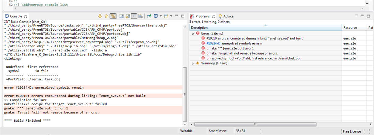

I've tried to rebuilding of enet_s2e example project but I got errors as below
- I'm using TivaWare_C_Series-2.1.2.111 & exmaple of URL: www.ti.com/.../spma072.

  • Hello Amit,
    I replaced the line in the file FreeRTOSConfig.h like you told me. However, I still have some building errors. I uploaded an image to show the remaining errors.
    Alex
  • Hello Alex,
    Yes, I saw it too and this is because the RTOS version has been changed causing the function to be removed. I have reported this to the TI Design author as well, and waiting for an update from him.

  • Hello Alex,
    Sorry for the delay. As noted before the compilation error is generated because the FreeRTOS version in TivaWare 2.1.2 has been updated.
    I did the following modifications and the application builds successfully. Some of these modifications were covered by Amit, but I am including all the necessary modifications in one place here.
    • In the file "FreeRTOSConfig.h" replace the line
    #define configMAX_PRIORITIES                ( ( unsigned portBASE_TYPE ) 16 )
    with
    #define configMAX_PRIORITIES                16
    • In the file "serial_task.c" replace all instances of
    vPortYield();
    with
    portYIELD();
    In the same file, replace the following line
     if(xTaskCreate(SerialTask, (signed portCHAR *)"Serial",
    with
    if(xTaskCreate(SerialTask, (const portCHAR *)"Serial",
    Sai

  • I started having the same problem, I did the changes but the project still does not compile.
    The number of  errors was reduced from 18 to 5, and I still have the following errors:
    Type unresolved symbol portYield, first referenced in ./serial_task.obj
    Type #10010 errors encountered during linking;
    #10234-D</a> unresolved symbols remain
    Type gmake: *** [enet_s2e.out] Error 1
    Type gmake: Target 'all' not remade because of errors.
    Any help would be appreciated.
    Phil
    Code Composer Studio Version: 6.2.0.00050
  • Solved the problem now: in FreeRTOS V8.2.3 all occurrences of "vPortYield" must be changed to "portYELD" (case sensitive).
