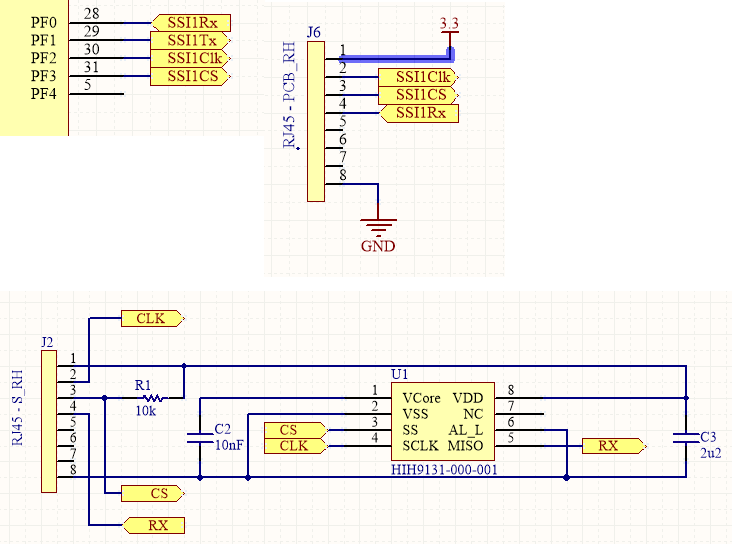

Hi guys! A few month ago I created a post before starting to use Honeywell's HIH9131 sensor (https://e2e.ti.com/support/microcontrollers/tiva_arm/f/908/t/510084 ). I started playing with this guy this week and I can't really make it work, and I need it in order to measure relative humidity and temperature. First of all here's the schematic:
The top part is in one board and the bottom one is another board. I'm using TM4C123GH6PM with TIvaWare, and Coocox with GCC to program. I'm also attaching sensor's datasheet and SPI comms app note to understand how it works.

I probed clock going to the sensor and I'm getting 100kHz (datasheet says clock's frequency should be between 50 and 800kHz), 8 clock cycles to convert, I wait 40mS and then 16 clock cycles.
I probed Chip Select and I get one in the middle of the reading sequence (I think it is because I am sending two bytes at a time instead of four bytes in a roll):
And when I probe Rx I can see something like the next pic. Data is changing, that's good, but it seems to be repeating two times (Again I think that's because I'm sending two bytes at a time).
The thing is I don't get any read data to HR_MSB or HR_LSB, they are always zero. I already tried everything that came to my head, but I always get the same result. I followed Rx path and it's going from the sensor to microcontrolle's pin, so I didn't see any issue here.
I would appreciate every comment or fresh idea to try and thanks in advance!

  • I suspect your conclusions about the problem source are correct for the chip select. I would advise not using the builtin chip select functionality, I've so far only seen one manufacturer's implementation approach being correct and TI is not that manufacturer. Instead toggle the chip select line yourself.
    As far as not receiving input, maybe you have run afoul of TI putting an NMI on the pinout. In order to partially compensate for that they've made it necessary to jump through hoops to change the functionality of some pins. Check the data sheet to see if you are using some of the affected pins. There have been multiple posts here about the incantation needed to change the function of the affected pins.
    Robert
  • Thanks Robert, actually I was about to check "Diagnosing Common Development Problems and Tips & Info for TM4C Devices" and PF0 is a locked pin, so I'll try to unlock it and come back to update.
    About CS pin, I was using it as a GPIO, but I was innocent enough to think that library could take care of it. I think I'll go back to the way it was before.
  • Well, I could fix CS issue and now I can see the first two bytes changing according to relative humidity and the last two bytes changing according to temperature. Manually manipulating CS pin was the answer.

  • Hi guys, thanks to everyone for your support. Code is working now, to summarize:
    - Using CS as GPIO
    - Unlocked PF0
    - Variable for SSIDataGet must match frame size on SSIConfigSetExpClk
    My code in case anyone needs help:
