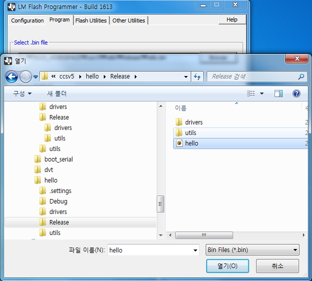

 I' m want   download   image.bin  by UART via Serial Boot.
 I'm read  Serial Flash Downloader in SW-DK-TM4C123G-UG
    Example:
     The following will download a firmware image to the board over COM2 without auto-baud support:
     sflash -c 2 -d image.bin
 I had to 3 Step Sequence  but  image.bin  not be downloaded.
 Please check in attached picture.
What should I do ?
 thanks

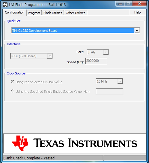

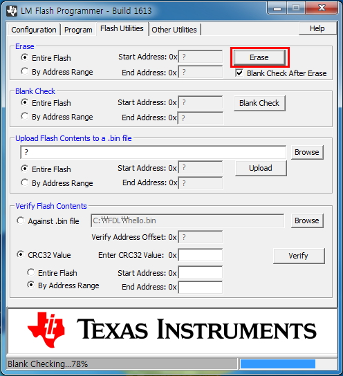

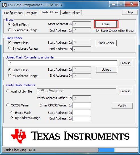

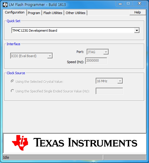

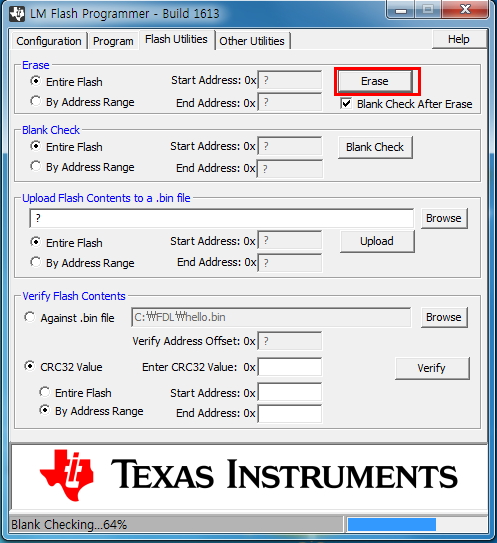

[1 STEP]  Flash Erase Only,  Erase  Select
Blank Check After Erase , Complete

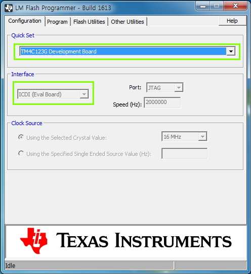

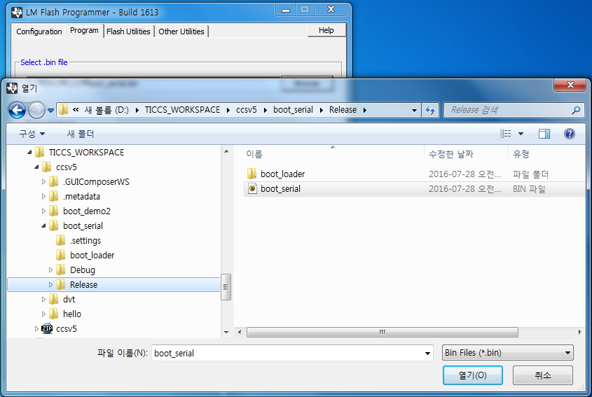

[2 STEP]  Serial_boot_bin Download,   ICDI  interface
Download Complete
[3 STEP ]  Hello.bin Download  by  sflash Dos Mode ( 0x1000 , 1000, 4096 Address 3 type, try) Error !!

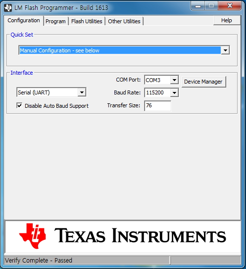

Try  to UART Interface of LM Flash Programmer,

    It's no Problem   communication  serial Port

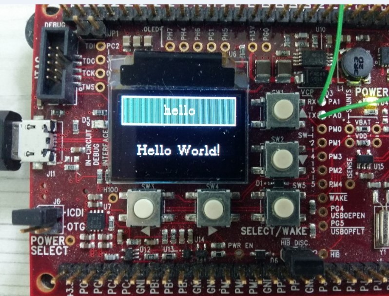

    [    download  via interface ICD  ]
    [ Hello.bin Downloaded]
    [Hello UART Log Message  COM3  Port OK ]

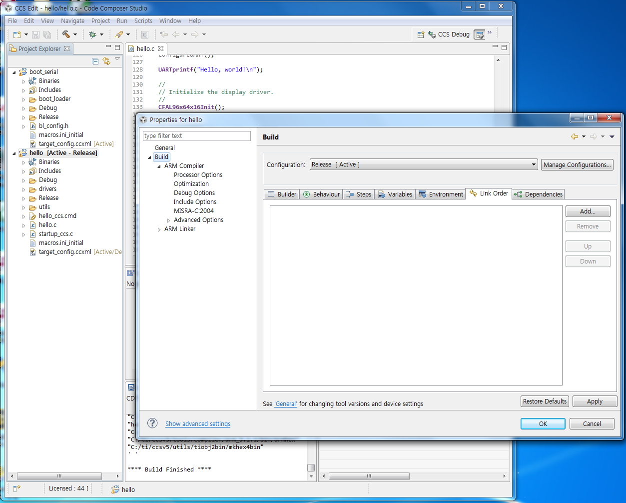

    When compiling hello.bin what is the start address being used by the cmd file in CCS project?
    Amit

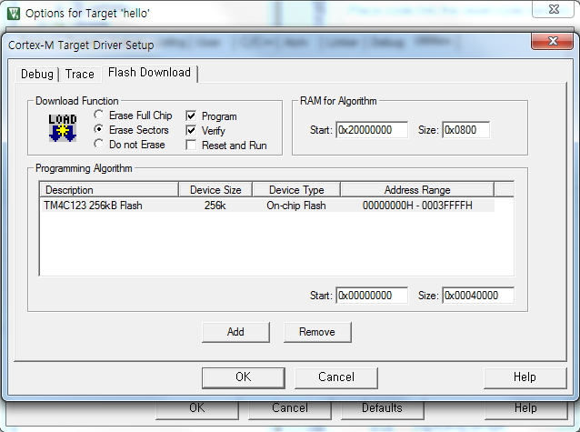

  • Hello Amit

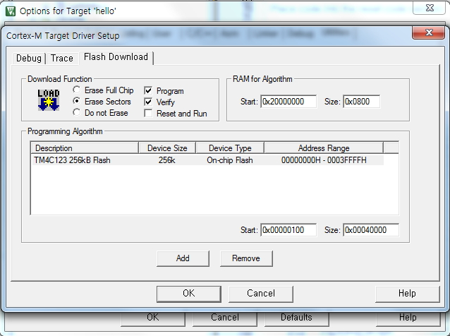

    The image (hello.bin) was compiled 2 weeks ago

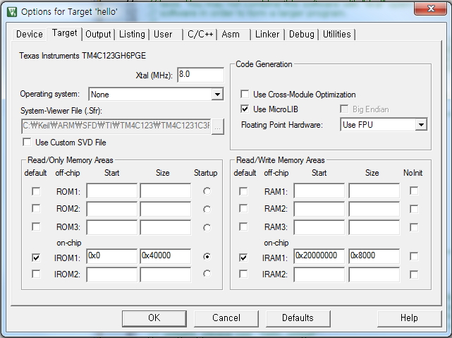

    I'm use Keil Tools , What is the start address ?
     image capture  about start address in Keil tools
    what should i do ?
    thanks.
    [ hello, compile OK]
    [ start address in Target Option]
    [ start Address in Linker option]
  • Hello James
    The Start address must not be 0x0 as you have to flash it to 0x1000. Please change the location of the reset vector and then re-try
    Amit

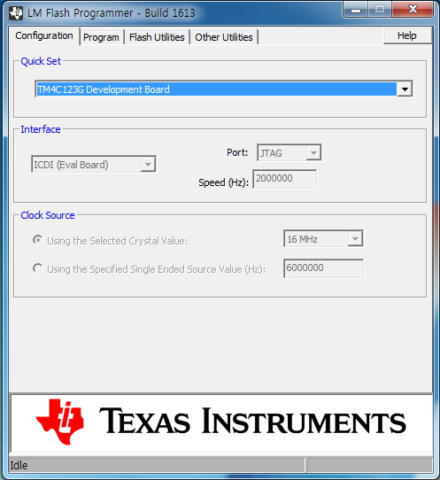

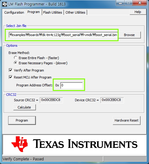

    1.  LM Flash Program  ->   [Confiuration] ICDI interface  -> ,  [Flash Utilities]  Erase     - (Ok)
    2.   LM Flash Program  ->   [Confiuration] ICDI interface  -> [Program] boot_serail.bin  (0x1000) - (OK)

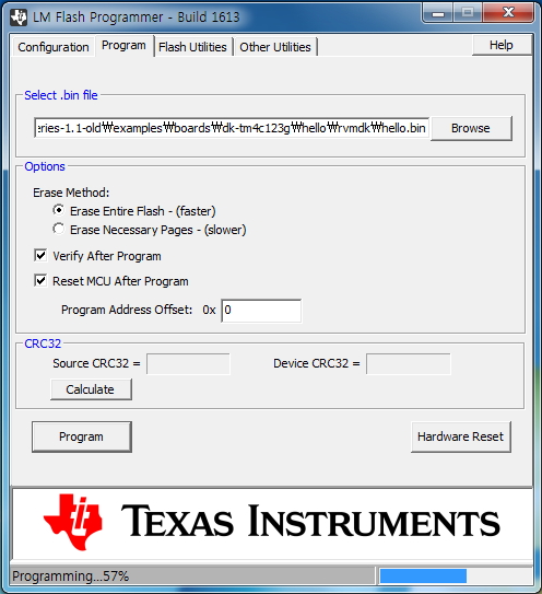

    3.  LM Flash Program  ->    [Confiuration]  Serial(UART)  -> [Program] hello.bin (x0  or  0x1000)  - (No Good)
    3'    (Dos Mode)    sflash -c 3 -p 0x0 -d  hello.bin   or    sflash -c 3 -p 0x1000 -d  hello.bin  -(No Good)
    So, Next  try

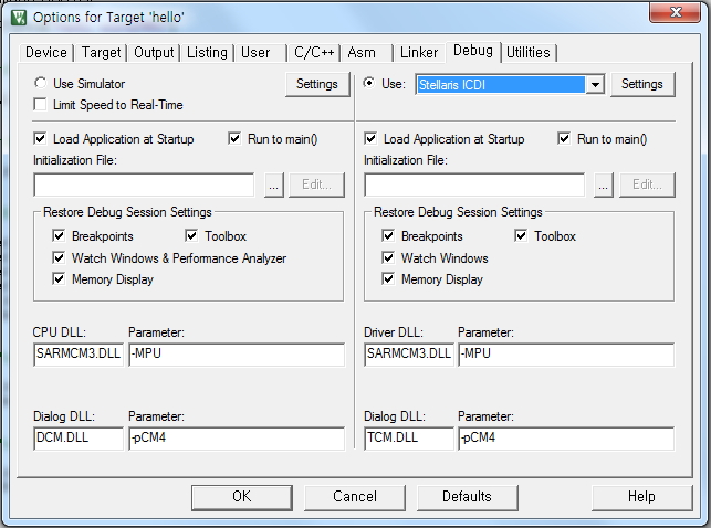

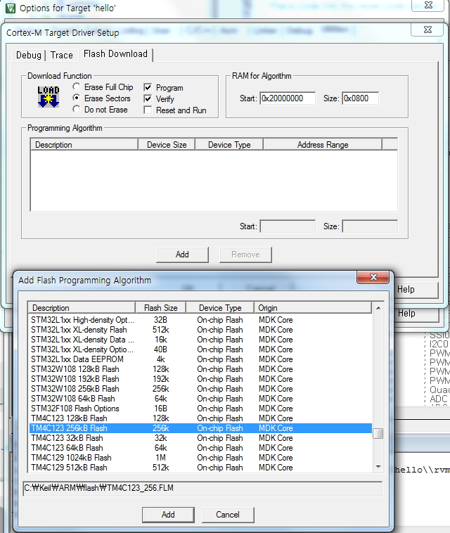

    4.  LM Flash Program  ->   [Confiuration] ICDI interface  -> [Program] hello.bin  (0x0) - (OK) , Log message  Good via UART

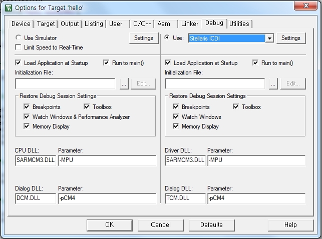

    4'  Keil Tools                  ->    [Debug] Stellaris ICDI             ->   Compile    ->  Download  hello.bin  - (OK)
    What do you think about this status?
    How to change the reset vector location you said ?
    I do not know, I saw the file(startup_rvmdk.s).
    thanks

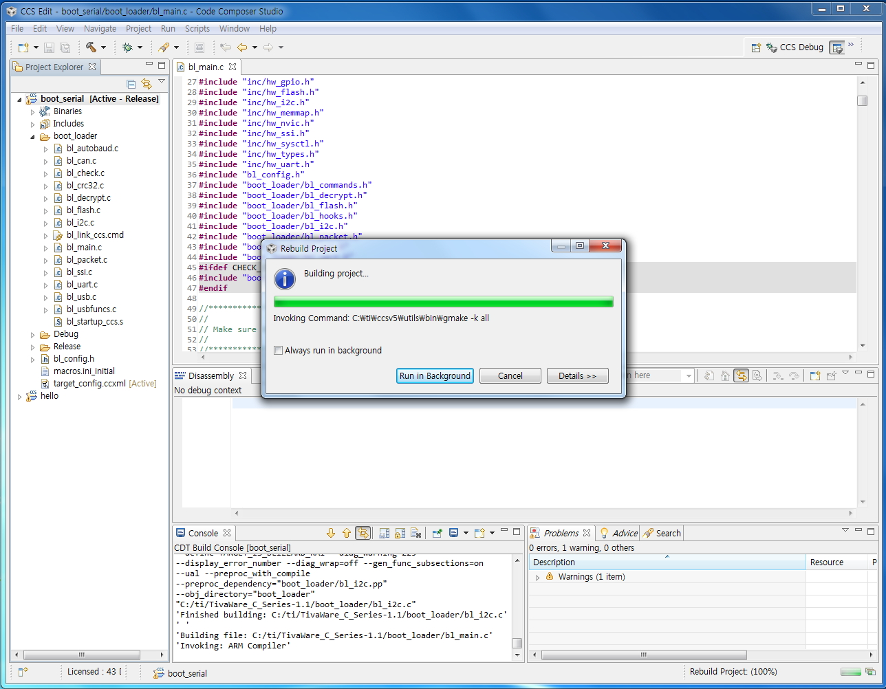

    The is boot _serial.bin (Boot Loader) in " \examples\boards\dk-tm4c123g\boot_serial "
    The is hello.bin (Application) in " \examples\boards\dk-tm4c123g\hello "
    I want to download by UART the application file over the serial boot loader
    What should i do ?
    thanks.

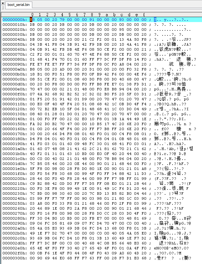

    The serial boot loader resides at 0x0 and the hello.bin you are trying to flash has been compiled and linked to start at 0x0. Even though you specify the program offset as 0x1000, the boot_serial.bin checks if the application is trying to overwrite it and aborts the download. You need to change the start address of the application (hello.bin) in Keil (check the documentation from Keil uVision).
    To confirm that open the hello.bin in a hex editor and paste the start of the file on the forum.
    Amit

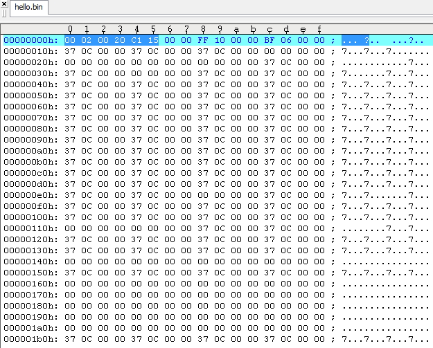

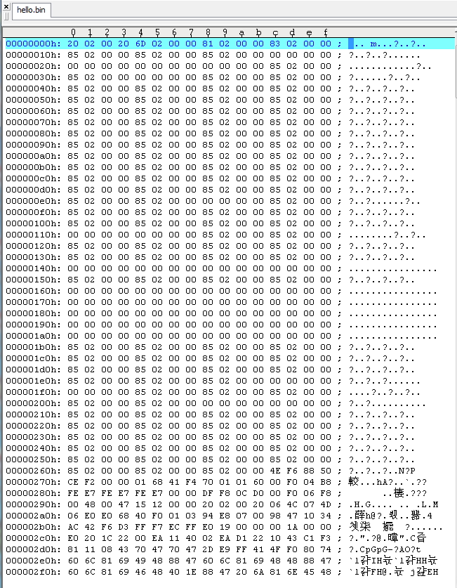

  • Hello Amit

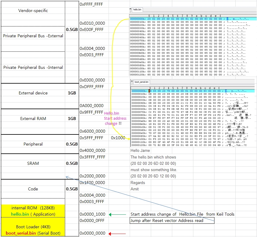

    Let's check in Keil document
    Is that how changes in the CCS ?
    HEX file, do you need to check what position?
    The attached file that  header of the captured image
    thanks
    [ Hex Editor ]

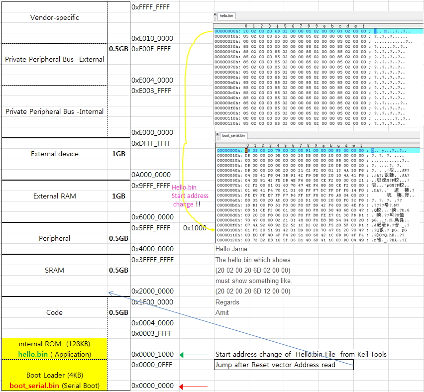

  • Hello Jame
    Just as I suspected. The application binary is given the directive to be starting at 0x0. You need to change that to the correct offset as expected by the boot loader binary during link phase.
    Amit
  • Hello Amit.
    I question with the above information.
    Compare 0x,& 0x1000 address values were between " boot_serial.bin"  and "Hello,bin"
    This is correct?
    0x  " boot_serial.bin"  (B8 05 00 20 79 00 00 00)
    0x  ""Hello,bin":           (20 02 00 20 6D 02 00 00)
    0x1000  " boot_serial.bin" (01 F5 20 51 91 42 01 D9)
    0x1000  "Hello,bin"            (85 02 00 00 85 02 00 00)
    thanks
    Add attachment [ Boot _Serial.bin]
  • Hello Jame
    The hello.bin which shows
    must show something like.
    (20 02 00 20 6D 12 00 00)
    Amit
  • Hello Amit.
    I do not know. More details please. ?
    Set the start address in the 0x0 Keil Tools, and then hello.bin file compile the results
    This is  No Good  (20 02 00 20 6D 02 00 00).
    This is  Good        (20 02 00 20 6D 12 00 00).
    thanks

    I'm checked  the documentation from Keil uVision (   http://www.keil.com/support/man_arm.htm   )
     - Compiler User Guide  &  µVision User's Guide
     Not found a solution.
    How to download into the flash start address is found.
    But , Stellaris ICDI not Support ,  ULINK2 Support (Attach-1.  Capture  image)
    A summarized content to the memory map. (Attach-2.  Capture image)
    what should I do ?
    thanks
    [ Attach-1 ]
    [Attach-2]
    USB to JATG Adapter ULINK2
    Start Address (0x1000)  & Size  modifcable
    [ ICDI not Support ]

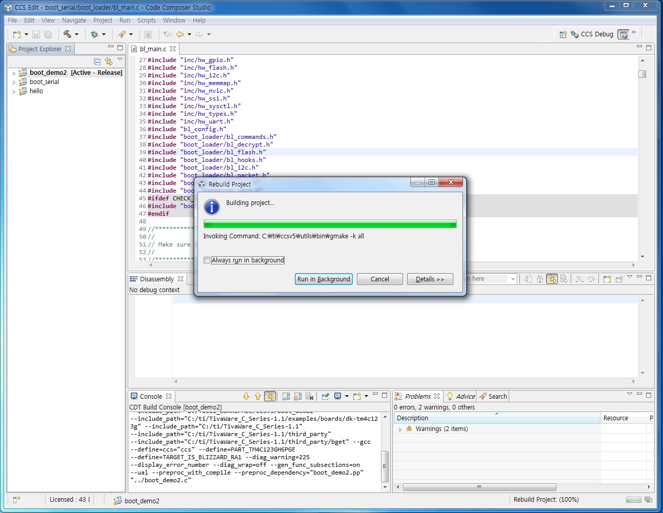

    LR_IROM 0x00001000 0x0003F000
    ; Specify the Execution Address of the code and the size.
    ER_IROM 0x00001000 0x0003F000
    Amit

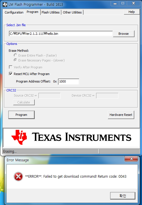

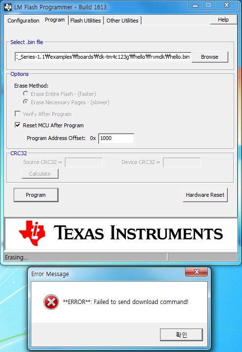

  • Hello Amit

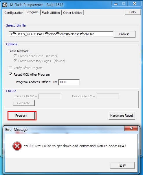

    It has changed.   next  Compile
    This hex value was( 20 02 00 20 6D 12) at  0x Address in Hello.bin

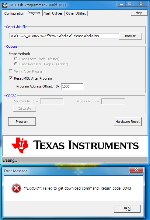

    but  A download error has occurred.
    what should i do ?
    Please check captured images.  [attachment]

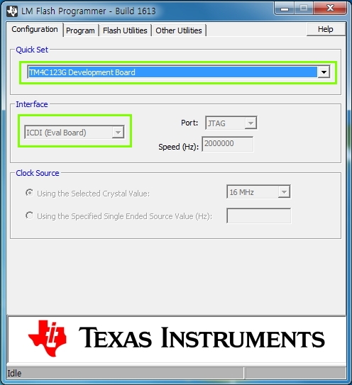

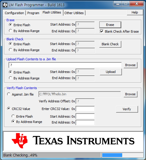

    1.   Flash Erase  , ICDI interfce
    2.  boot_Serial, 0x ,  Download
    3.  UART Interface Change

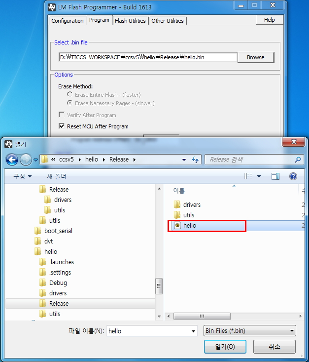

    4. Hello , 0x1000 , Download
    thanks

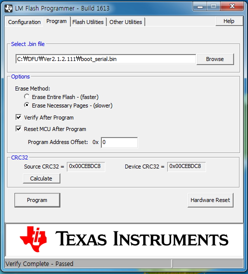

    1. Hex View
    2. ICDI interface configuration
    3. Flash Erasing
    4. Erase Complete
    5. boot Serial Download Complete
    6. UART Interface Configuration
    7. hello.bin Download Error
  • Hello Jame,
    Your binary and steps are correct. Can you please specify the following
    1. Which board are you using? And which TivaWare version?
    2. Can you send the latest boot_serial and hello bin so that I try on my side.
    3. Can you send the latest projects for the IDE?
    Amit

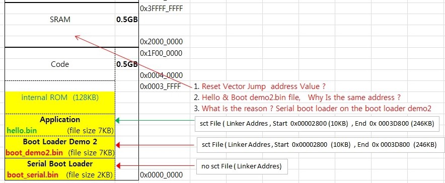

          LR_IROM 0x00002800 0x0003d800
         ER_IROM 0x00002800 0x0003d800
    Start Address (0x00002800)   ~ End Adress (0x0003d800)
                                 10(KB)                                           246(KB)
    What is the status under 10KB ?

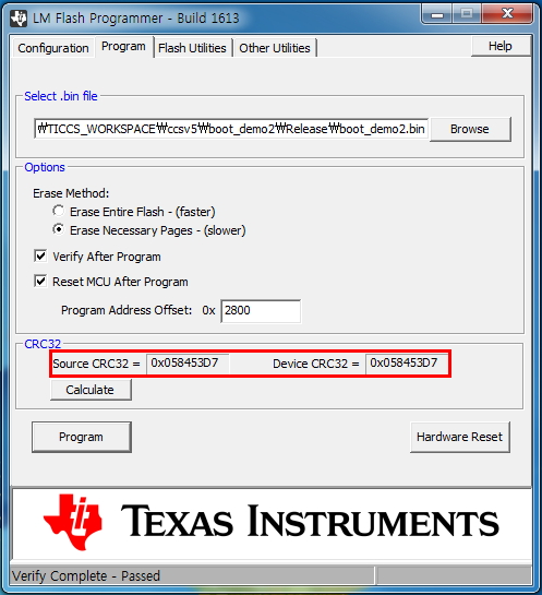

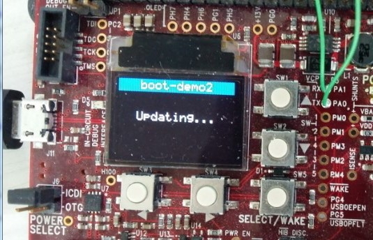

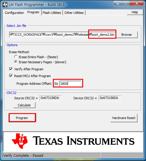

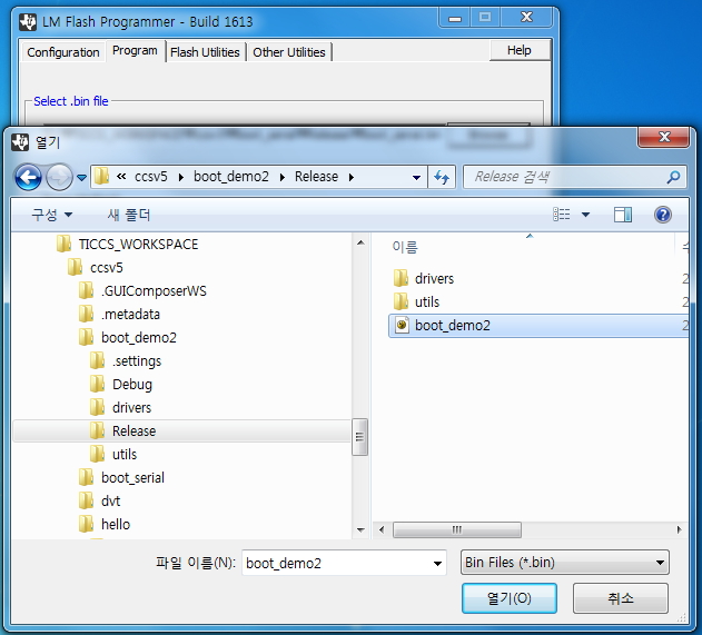

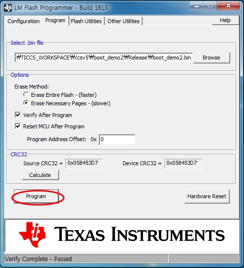

    <Download demo1 / boot_demo2>
    1. Flash  Erase  (OK)
    2 .0x  Download     ,  boot_demo1 or boot_demo2  (OK)
    3. Uart Interface ,  0x1000 Download,   Hello ( Error)
        attachment capture image
    thanks

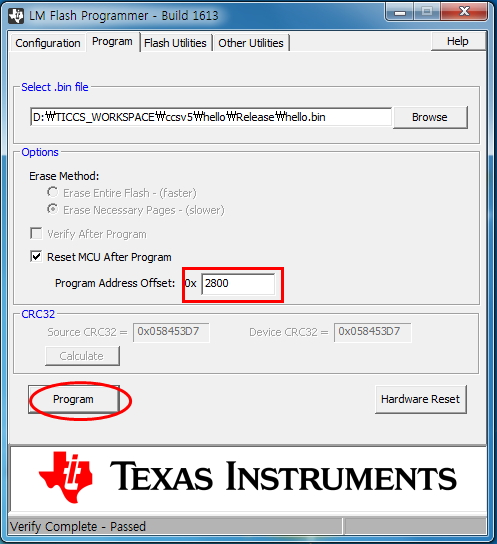

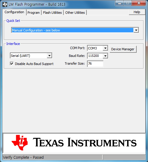

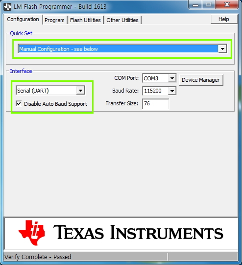

  • Hello Jame,
    The 10KB is the start address of the application. Did you make sure that the device was in download mode and that the Disable Auto Baud check box was checked? This application has been working fine with a lot of other customers....
    Amit
  • Hello Amit

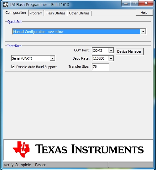

    I had to check.   " [ v]  Disable Auto Baud Support "
    I know. (2800) 10KB  start adress  ,  LR_IROM   [  0x00002800     ~    0x0003d800 ]  of  Boot demo1 & demo2
    My question is what is 0x ~ 0x27FF  ?
    What should I do. ?
    thanks
  • Hello Jame,
    That is the place holder for the flash based boot loader. If the boot loader were to be expanded later on, then it would give the embedded developer free space to use, rather than causing a conflict with the application base address.
    Amit

    Question one meaning
    The difference between the "boot_serial"   and   "boot_demo1 & boot_demo2".
    No sct files in the folder(boot_serial
    There are sct loader files in the folder(."boot_demo1 & boot_demo2)
     Sct file of  boot_demo1. bin   or  boot_demo2. bin
    (notice).  sct File in folder
    LR_IROM 0x00002800 (10KB Start Address)    0x0003d800  (246KB End Address)
    ER_IROM 0x00002800 (10KB Start Address)    0x0003d800  (246KB End Address)
    I question why one has a different error message. ?
    Attach a picture.  boot_serial  &  boot_demo1/2  and  Hello (application)
    1.  boot_serial  +  Hello
    2.   boot_demo1  or  demo 2  + hello
    what should i do ?
    thanks

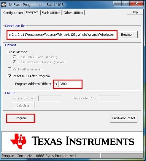

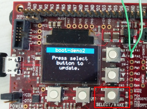

  • Hello Jame
    Boot_demo2 uses the offset 0x2800. You need to put the program address offset as 0x2800 and make sure that the COM port is correct, baud rate is 115200 and disable auto baud support check box is checked.
    Amit

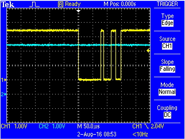

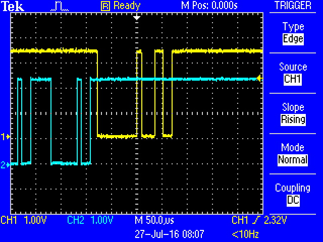

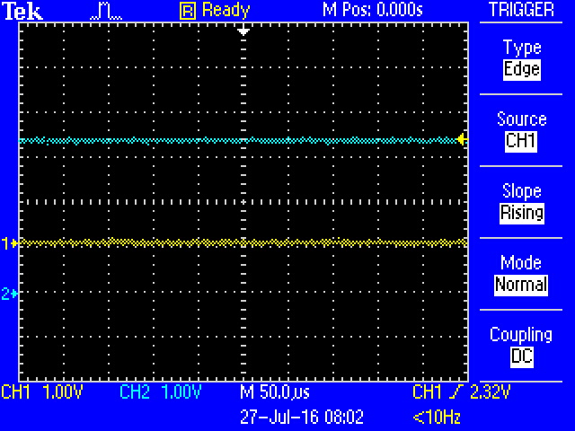

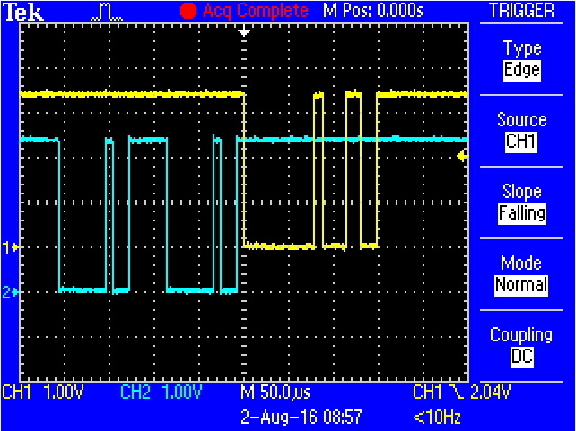

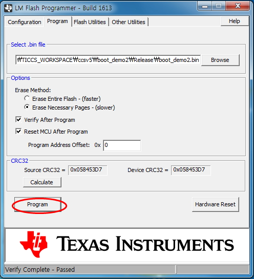

  • Hello amit.
    1.  you said "  Boot_demo2 uses the offset 0x2800."   =>  not operation

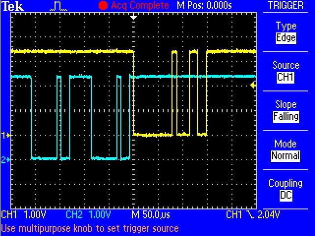

    2. I  has validated communications port operation.  115200 ,  disable auto baud support check box  => No problem
    3. Also , validated differs from the error message Serial between  Boot.bin   and  boot_demo1/2
    Capture images attached
     ## No1  ##    Boot_demo2.bin , 0x0  +  hello.bin, 0x2800
    ## No 2 ## 15200 ,  UART   < ---> PC communication
    Yelow( PA1_TX),  Blue(PA0_RX)
    ## No3 ##      Boot_serial.bin , 0x0  +  hello.bin, 0x1000
    Board and the communication port, no problem.
    what should i do ?
    thanks
  • Hello Jame
    boot_demo2.bin @ 0x2800 works with boot_serial.bin @ 0x0. I think you have the experiments done incorrectly.
    I would urge you to run boot_serial.bin with boot_demp2.bin as per the readme instructions in the file readme.txt of the two examples.
    Amit
  • Hello Amit
    I'm read instructions in the file readme.txt .
    What's the problem?
    I'm try  change by  CCS Tools
    it is Compiled files (boot_serial.bin & hello.bin)
    LM Flash Programmer download.
    The result is the same problem. " Error ........ Return code: 0043 "
     Hello. bin Hex 0x0 ( 00 02 00 20 C1 15)
    Why the difference  Keil Tools (20 02 00 20 6D 12) ?
    what should i do ?
    thanks

  • Hello Amit.
    Are you able to get this step working first of all?
     --> Only captured image attached.
    --> Please check.
    thanks
    Boot_serial.bin (0x0)   +  Hello.bin (0x1000)
    compile  (boot serial +boot_demo2 + hello)
    Boot_Demo2.bin (0x0)   +  Hello.bin (0x2800)
  • Hello Jame
    In the first experiment
    Did you try just
    compile (boot serial +boot_demo2)?
    Amit
  • Hello Amit
    -> I do not know what the reason. !!!
    -> Ok  I'm just Try
    thanks
    1 STEP
    2 STEP
    3 STEP
    4 STEP
    5 STEP
    6 STEP
    7 STEP
    8 STEP
    9 STEP
      --------------------------------- [ add] Hello .bin  ---------------------------------
  • Hello Jame,
    The serial boot loader is expecting that the application always be at 0x2800. So compile hello project with the change in the startup offset to 0x2800 and then try the same step of loading the hello.bin with Program offset at 0x2800.
    Amit
  • Hello Amit
     it is correct. !!
    I have  some questions in STEP 3/ 4
    1. Step 3   0xCC00  values in which the source code?
                  [ DK-TM4C123G Board ] Yellow : PA1/TX  0xCC00  ------  UART i nterface  ------->>  [ PC(LM Flash Program) ]
                  [ DK-TM4C123G Board ]  Blue :   PA0/RX  <<----------------- UART i nterface  ---------  hello.bin , Application  [ PC(LM Flash Program) ]
         I can not continue to download Hello bin via a UART interface.
          what shlold i do.?
    2. Step4   please answer about my question in picture
    attached [ Capture images ]
    thanks
    1. SETP
    2. STEP  ( Yellow : PA1/TX ( 0xCC00)  , Blue:  PA0/RX)
    3. STEP
    4.STEP
  • Hello Jame
    As per the diagram given, the hello.bin must be at the same place as boot_demo2.bin. Can you please attach hello.bin source code and binary to the forum?
    Amit
  • Hello Amit.
    Source code and binary  is the same to the address below.
    C:\ti\TivaWare_C_Series-2.1.2.111\examples\boards\dk-tm4c123g\hello
    thanks.
    i'm used  keil tools
    [reference attach]
    8270.hello.zip

  • Hello Jame,
    I updated the linker option to use 0x2800 and it now works with the DK-TM4C123 boot_serial when using the offset location 0x2800 in the LMFlashProgrammer.
    4606.hello.zip
    Amit
  • Hello Amit
    The attached file was downloaded.
    I checked the linker option to use 0x2800  (Linker R/O Base in Keil Option)
    I'm the same as a previous question on the contents.
    How do I continue to download the only application?
    thanks
    STEP 1
    STEP 2
    STEP 3
    STEP 4
    STEP 5
    STEP 6      Select Button,  Yellow (TX ( Board --> LM Flash Program)
    STEP 7
    STEP 8
    STEP 9
    STEP 10  Application(Hello.bin),  Yellow (TX) , Blue (RX) (Board  <<--  LM Flash Program)
    STEP 11
                     ###########################(   Download OK   ) #######################
    STEP 12
    How to continue only download applications over the boot serial  + boot_demo 2  ?
    i'm try  only download applications
  • Hello Jame,
    That is because there is no call for an boot update in your code. Please check boot_demo2 or boot_demo1 to see how UART can be re-invoked for the boot loader interface.
    Amit
  • Hello Amit
     I'm checked  boot_demo2 or boot_demo1 to see how UART can be re-invoked for the boot loader interface.
    I do not know . explain it to me please.
    thanks.

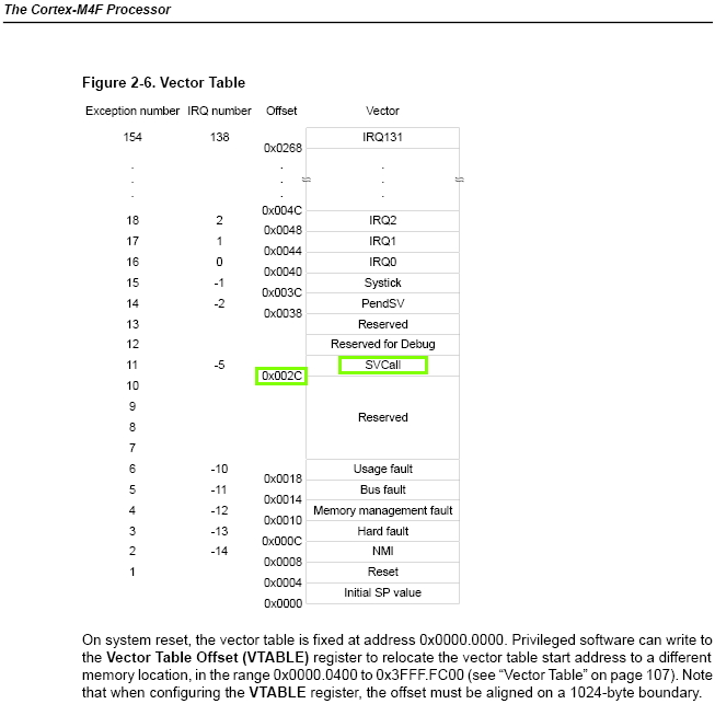

    I have seen a source code ( boot_demo2.c)
    [question 1]     image of a STEP 6 in  previous posting.
                             Yellow waveform,  which  send in any section of the source code ?
    [question 2]     I do not know  "   (*((void (*)(void))(*(uint32_t *)0x2c)))()   "
                              Why jump to this address?
    ( boot_demo2.c)
    void
    JumpToBootLoader(void)
    // We must make sure we turn off SysTick and its interrupt before entering
    // the boot loader!
    ROM_SysTickIntDisable();
    ROM_SysTickDisable();
    // Disable all processor interrupts. Instead of disabling them
    // one at a time, a direct write to NVIC is done to disable all
    // peripheral interrupts.
    HWREG(NVIC_DIS0) = 0xffffffff;
    HWREG(NVIC_DIS1) = 0xffffffff;
    // Return control to the boot loader. This is a call to the SVC
    // handler in the boot loader.
    (*((void (*)(void))(*(uint32_t *)0x2c)))();
    ------------------- Main  ------------------------------------------------
    while ((ButtonsPoll(0, 0) & SELECT_BUTTON) == 0)
    ROM_SysCtlDelay(ui32SysClock / 1000);
    GrStringDrawCentered(&sContext, " ", -1,
    GrContextDpyWidthGet(&sContext) / 2, 20, true);
    GrStringDrawCentered(&sContext, " Updating... ", -1,
    GrContextDpyWidthGet(&sContext) / 2, 30, true);
    GrContextDpyWidthGet(&sContext) / 2, 40, true);
    // Transfer control to the boot loader.
    JumpToBootLoader();
    // The previous function never returns but we need to stick in a return
    // code here to keep the compiler from generating a warning.
    return(0);
  • Hello Jame
    The JumpToBootLoader call branches to the SVC handler for the boot loader, invoking the boot loader.
    Amit
