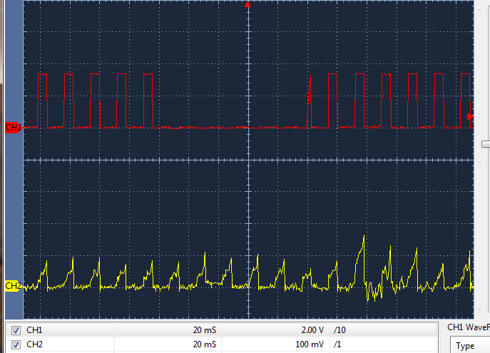

What could be causing 150ms nulls on the PWM output control block configured local updates? Note ADC sequencer (BEMF sample) holds highest priority over all sequencers, same is true for GPTM-0?
A few microseconds is acceptable Null time; 150ms = 1875 PWM pulses at 12.5Khz are randomly missing.
Note scope rolling 500ms 100ms/cm and 20 seconds of PWM pulses (CH1) occurs prior to Null and phase burst current follows (CH2 trigger source).

  • Robert:
    "The measurement of any gap is meaningless."
    Disagree, as you will notice CH2 has no Null gap and to blame the scope ADC sampling seems wrong. Scope sample window (not shown) is 500ms and CH1 only 1000 samples deep this capture.
  • BTW Robert how do you explain the phase current spikes after the PWM null void. Theory explains phase current spike would occur if suddenly PWM stops commutating the inverter.
  • Irrelevant. Take a look at the observable PWM frequency, the aliasing is painfully obvious. You cannot make any valid measurements of gap or current pulse. And there is absolutely no reason the two channels should show the same gap behavior under aliasing.
    The oscilloscope capture is meaningless, there is no useful information in it, you cannot say there is a PWM gap, you cannot say there is a pulse. If anything the current waveform argues against a PWM gap, but I'd not want assert that was the case.
  • Absurd speculation once again!  Perhaps you didn't read the Null void widens with forced changes in pulse width.
    What is the sampling frequency of the oscilloscope?
  • Never should be any gap at all and that is the point 500ms/1Ksps, 1000 deep or 10k deep. Yet it don't matter the current is spiking when it should be relatively steady.

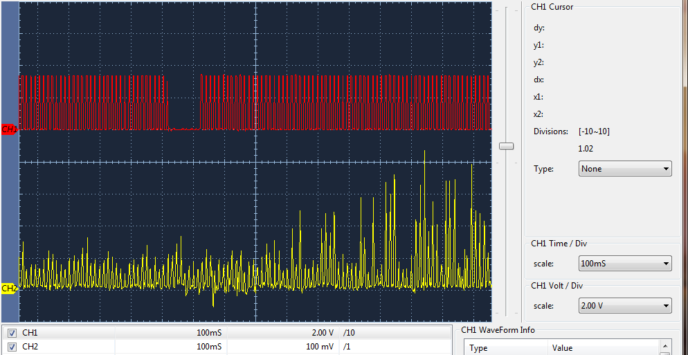

  • Again current monitor sagging before peaking are direct indicators PWM stopped, phase current sags then suddenly PWM started again mid cycle and phase current jumps. How much more simple does capture need to be to indicate PWM stops for some time in CH1 null void.
    CH1 is an 80us period and scope LCD retrace so fast the human eye would miss the real time Null event and not show CH2 peaks in the same capture. That is sort of the point to show them together in the same capture.
    Do you mean the oscilloscope has been set to collect at a rate of 1000 samples per second?
    If so, sampling a 12.5KHz PWM signal at 1000 samples per will WILL give you an aliasing problem, such that oscilloscope misses pulses.
  • The channel scan rate is 525-1000 SPS and 1k or 10k samples deep storage acquisition, independent from 500ms horizontal roll. The pulses are squashed together and runs for 10-20 seconds with average current CH2 then CH1 PWM voids and CH2 current spikes result. Explains random occurring faults being tripped from missing PWM pulses not the scope is missing pulses for 150-275ms. That would be like the grand canyon of scope error even at 1k storage acquisition.

    To review the evidence in the capture you presented
    • Switching Frequency 12.5kHz
    • Displayed frequency ~50 to 60Hz
      • Conclusion: very heavy aliasing, signal shape and magnitude presented are likely not to represent the actual signal. If it were not aliased you would see a solid band on the display rather than the squared waveform you presented.
    • Gap in the voltage waveform
    • No corresponding gap in the current waveform
      • Conclusion: no gap exists, the voltage waveform gap is confirmed to be an aliasing artifact.
    If you want to eliminate aliasing, then put a low pass filter on your probe. A little RC filter with a bandwidth of 1kHz would do wonders. If there is a gap it would still be obvious but the 12.5 kHz components would be considerably reduced.
    Robert

  • BP101 said:
    >Balderdash. Stuff and nonsense. Utterly and completely ridiculous. The fact that aliasing is occurring means you cannot depend on the sample to accurately represent the shape or magnitude of the waveform.
    If that void amidst aliasing is an artifact ADC sampling all scope engineers need to post markers on CRT sample dead time start/end periods.
    It's not dead time, it's aliasing. The 'scope is sampling low portions of the PWM
    It's the nature of the signal that it is not possible for the 'scope to determine that there is a gap produced by aliasing. It might be possible to detect that aliasing is occurring by comparing the frequency content of the signal to that of the sampled data but the result would be to mark the entire sampled data as invalid.
    Given that your current signal confirms there is switching occurring in the gap it seems a trifle odd that you persist in insisting that there is no switching activity.
    BP101 said:
    So It AIN'T about the operator rather more about  engineers ignoring design limitations of their product in public disclosure according to your reasoning.
    Nope. User's of instruments MUST be aware of their limitations and when/where they are appropriate to use. Full Stop. It is your responsibility to understand, it is not the manufacturers responsibility to point out every possible misuse (that is certainly impossible in any case). This is a scientific/technical instrument, the user is expected to know how it works.
    I might like the manuals to contain more theory of operation for new users but manuals are expensive to write so I can understand why that's been set aside.
    BP101 said:
    I will be calling Tenma and Tektronix today and get their reason as to why never disclosed such an anomaly would occur.
    If all you ask is if a gap can occur in the sampling you will be told no. If you describe that you are attempting to measure a 12.5kHz signal at 100ms/div and ask if the result will reflect the 12.5kHz signal you will get a quite different answer that more accurately reflects your usage.
    Robert
    If you ask the right question you will get the answer you want. The answers relationship to your situation may be non-existent.
  • Robert your trying to make analysis far to complicated and not offer any answers on what could be causing the void condition. That is the point to fix the dang issue not continuously debate alias signal being valid. The question was vague not specific and calls for speculation and think outside the box.
    Could it be the current is actually spiking repeatedly when the PWM frequency falls instantaneously below 12.5Khz. There are 3 phases so expect analog feed back CH2 even when no PWM signal is present on CH1. We use SW to select the phase sampling being valid.
    Seems there is a pitfall in all digital scopes producing aliased signals the horizontal alias rate can not shift up in frequency. That is the channel being tied directly to the horizontal time base can not capture a pulse above the set frequency of the time base. This case the 100ms/20ms horizontal rate can not capture a 400us pulse stream once it is triggering on the primary aliased and locked in frequency 100ms/20ms. A standard scope would easily capture a 2.5khz pulses inside 12.5Khz pulses at 100ms. Not sure what has gone wrong along the line to keep the basic functionality the same when storage was touted to have so much more ability!
    I've been telling you consistently (and others have suggested it as well) that what is causing the void is aliasing. There is no void, the current signal quite nicely confirms that.
    You could easily check this by putting a low pass filter (an RC with a 1kHz corner would do nicely in your setup I think). That would show the gap if it existed and a steady quasi-DC line if it did not. You might have a little ripple aliased on it but you'd have removed most of the alias-able frequency power.
    This is a DSO limitation that's been known for 30 years (and the major reason some people kept buying analog 'scopes).
    DSOs have a lot of advantages compared to analog 'scopes. This is one of the prices you pay for those advantages.
    One of the advantages with your setup is that you already know what the PWN frequency is. If you capture is showing a different frequency then you know you are aliased, so you have a simple check.
    Robert
  • Robert:
    BP101: The roll feature even with aliasing can reveal odd things easily escape the eye at higher sample rates.  This case the evidence shows said void effects +24v dc switching power supply current limiting. Same spike CH2 occurs zoomed in but can not capture IF (2.5Khz)  at higher horizontal rates.
    CH1 PWM trigger source and CH2 +24vdc with 2v bridge ripple when the spike sources hard current.
  • BP101 said:
    Robert:
    Introducing roll doesn't suddenly make the signal valid.
    Well, this is just wrong.
    Robert
  • I really find it complete wrong that you would disregard all indications of some kind of undesired PWM disturbance. That phantom disturbance even effects the power supply steady ripple every 12 seconds.
    Why on earth would anyone in this forum believe that is proper electronic behavior. Higher sweeps indicates the same disturbance has taken place at 80us, some kind of flashing PWM crash occurs spewing 80us pulses upon DC supply rail. The odd part is 12 seconds with all non-essential interrupts disabled. The only interrupts left enabled during PWMENABE register output are PWM zero count and commutation one shot timer.
    The idea is to have clean PWM and not spewing a phantom disturbance on the DC supply rail in 12 second intervals or more.
    There are no indications of undesired PWM influence. Again aliasing.
    Nope. Again aliasing.
    So show us some properly triggered scans at 20uS/Div. Now 80uS is about the PWM frequency so you would expect signal at that timescale.
    Using a DC supply to run a motor is fraught with problems to begin with. But that's a separate post.
    Robert
  • Seem you are trying to relate alias results from scope ADC slower sample of a faster time slice (80us pulses) being squashed compressed in a 20ms sample window produces useless information. So the current peaks CH2 were actually only a compressed sample of a much wider signal profile. The bad part is the trigger level set near or just above 100mv CH2 @20us-200ns sweep will not hold off rolling but only at 500mv peaks or above. That makes CH2 +500mv peaks appear in my mind as some king of current surging and does not represent the average current profile. Agree +24 DC off line supply complicates and the 2KW linear (22,000uf caps) 470uf near inverter B+, produces three dv/dt rings/pulse @130 VDC 9 amp load. Sadly 150 volt batteries were not included by Santa's helpers, future lists asked 300 volt batteries but even spending millions $$ R&D he must need more time. Though Toyota Incite runs 600 volts, data sheet omits how produced but suspect AC generator hybrid or yet another battery monopoly.
    What was causing CH1 void:  The watchdog timer being punched several times every 80us in the closed loop PWMENABLE register. Same watchdog timer was again punched every 40us in another GPTM producing 25Khz PWM cooling fan speed control. Even with dogs priority set below GPTM one shot commutation timer (closed loop) the application was repeatedly branching into dog timer peripheral leaving numerous voids in PWM. Single stepping (F5) with several break points through out closed loop did not reveal SW branching dog timer, CCS debug interrupts enabled. Had to put extra dog punches in SW when GPTM edge count was past configured to interrupt every 2 edges of fans tachometer signal. GPTM edge count for taco signal now does match interrupt every 50 - 940 edges per second. All but 1 dog punch (timeout 333ms) could be removed in the closed loop.
    Things are much better but seems Santa has been naughty.
