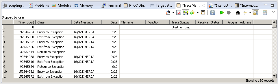

3 PWM generators (GEN_MODE_SYNC) will suddenly stop or perhaps only PWM control block outputs Null for 150-275ms (CH1). The result is all 3 phase currents CH2 randomly burst to catch up to the current lag. Have noticed this current burst LM3S8971 MCU and thought it was normal inverter noise.
Motor commutation just stops then picks back up where it left off. FOC use GPTM-0 (one shot mode) to trigger PWM control block pin state changes from ADC samples of BEMF motor phases crossing zero to commutate 3 phases. Nulls occur on all 6 PWM control block outputs in some order that does not stall a running motor yet disrupts current in a bad way. The more time spent to examine older motorware the more things discover that were not so obvious at first.
What could be causing 150ms nulls on the PWM output control block configured local updates? Note ADC sequencer (BEMF sample) holds highest priority over all sequencers, same is true for GPTM-0?
A few microseconds is acceptable Null time; 150ms = 1875 PWM pulses at 12.5Khz are randomly missing.
Note scope rolling 500ms 100ms/cm and 20 seconds of PWM pulses (CH1) occurs prior to Null and phase burst current follows (CH2 trigger source).

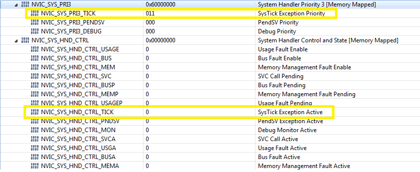

  • BP101 said:
    >NVIC does not have a priority. It makes no sense for it to have one. SYSTICK priority is not set in stone either. Depending on how you are using it there is a very good argument for making it one of the lowest priorities in the system, certainly it should be lower priority than those interrupts that occur more frequently.
    Disagree - NVIC has local bus priority over (any peripheral) on the MCU local bus
    http://www.keil.com/support/man/docs/gsac/gsac_nvic.htm
    The NVIC does integrate tightly with the core but as near as I can tell it is never a bus master, as such the question of bus priority never comes up except as a function of the priority of the associated core. In any case the NVIC design would ensure it does not interrupt a higher priority interrupt with a lower priority interrupt.
    BP101 said:
    SYSTICK timer holds highest of priorities in that it has no priority assignment other than fault handler being SYSTICK exists at the NVIC level!
    That's nearly incoherent but I think you mean that the systick priority is not programmable but to quote
    http://infocenter.arm.com/help/index.jsp?topic=/com.arm.doc.dai0179b/ar01s02s08.html said:
    The SysTick can be polled by software or can be configured to generate an interrupt. The SysTick interrupt has its own entry in the vector table and therefore can have its own handler.
    So Systick has it's own entry in the NVIC
    Interrupt priorities
    Each individual interrupt can be assigned a priority level via the Interrupt Priority Registers.
    And it appears its priority is programmable
    SYSTICK is interrupt 15 and we find on page 104 of the following
    and on page 170
    So it doesn't have a fixed priority (and indeed FreeRTOS suggests it be given the lowest priority). It doesn't even need to drive an interrupt.
    Robert

  • >So it doesn't have a fixed priority (and indeed FreeRTOS suggests it be given the lowest priority). It doesn't even need to drive an interrupt.
    Not sure datasheet fully explains function of SYSTICK masked interrupt vector handler behavior. That is when timer exception occurs the vector address must change to the non-maskable exception address at of applications interrupt priority assignment.
    Systick timer is built into NVIC has no interrupt priority assignment for timer time out since it resides in NVIC it PENDS at highest priority for SYSTICK timer expirations, RTOS claim is simply wrong. Datasheet shows INT15 is registered for exception Fault handling of timer errors and NVIC must handle INT PEND of a (non exception) type event interrupt for timer timeouts. Though not directly written NVIC seems to act as bus master of the private peripheral bus and reports bus status errors and faulting memory addresses in NVIC registers. Therefore it perhaps acts as a (logical) bus master and interrupt controller of all peripherals located on the advanced peripheral bus.
    Like I stated earlier it don't always matter priority of an interrupt in a single priority grouping, after INTPEND has been serviced the application can divert and later return to finish that same interrupted routine. Reason why SW should disable any interrupt sources that reference the output invert state of PWMENABLE control register or any other interrupt source that might otherwise cause a premature branch. GPTM taco edge counter was interrupting NVIC so often at 2EPS the PWM closed loop was acting very clunky or at times crashing. That edge count timer loop SW rewrite now acts dynamic and matches a variable edge count in the same 1 second one shot timer interval interrupt handler. There you go 2 reoccurring interrupts at a much lower priority were reeking havoc on PWM zero counts during the updates of pulse width periods. So want to go dual core after seeing this NVIC behavior but may be a simpler solution to help NVIC with house keeping tasks outside the closed loop.
    However as it seems that was no guarantee watchdog timeout period being extended by HW beyond the set expiration time if NVIC some how intercepts arbitrates bus control and asserts wait states on any peripheral INT PENDS. Perhaps a good reason to configure more than one interrupt priority group or building several priority groups and levels of interrupts to control NVIC behavior in the application loop. Priority grouping part of datasheet is a bit vague in details of what several priority groups might accomplish for NVIC logical arbitration of the advanced peripheral bus.
    The NVIC does not get interrupted any more than an OR gate does.
    Nonsense

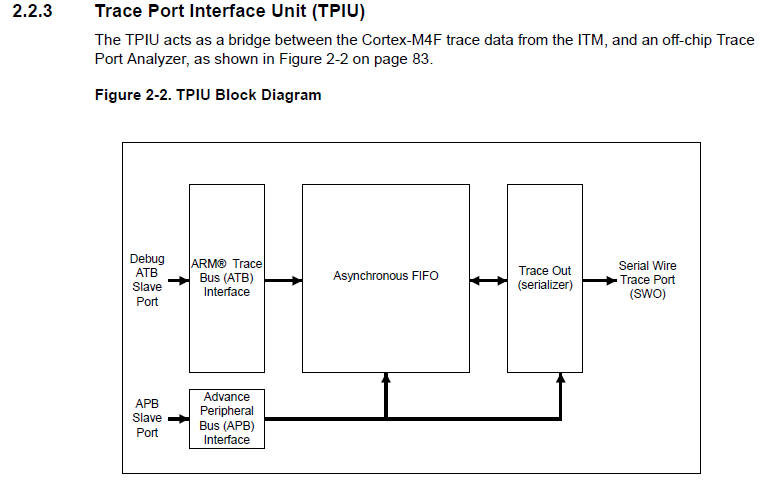

    Actually the documentation is very clear and the APB has naught to do with it.

  • >There is no such thing as NVIC priority.
    That is a matter of opinion. It is also said SYSTICK has the highest default INT priority in that it exists at the NVIC level in HW, therefore NIVIC alone holds highest nested priority over any peripheral or SW configured interrupt priority. All other GPTM and peripherals are on the vendor advanced bus and not on the NVIC private bus with SYSTICK, that alone says a lot for the argument of a default and highest HW priory level of NVIC as he is the boss.  There is No INT priority SW assignment required for normal SYSTICK timer timeouts having the highest default HW priority of NVIC himself.
    >Exception and interrupt are generally synonymous. No one suggested an error occurred.
    Disagree -  Exception and Fault are synonymous terms. Silly for ARM to claim an error free INT source when C+++ programmers are being taught processor exceptions are not normal SW flow, rather fault events to capture and write error trap handlers for.
    2.3.5 Exceptions and Interrupts
    The Cortex-M4F processor supports interrupts and system exceptions. The processor and the Nested Vectored Interrupt Controller (NVIC) prioritize and handle all exceptions. An exception
    changes the normal flow of software control. The processor uses Handler mode to handle all exceptions except for reset.
    SYSTICK: A SysTick exception is an exception that the system timer generates when it reaches zero when it is enabled to generate an interrupt. Software can also generate a SysTick exception
    using the Interrupt Control and State (INTCTRL) register. In an OS environment, the processor can use this exception as system tick.
    Otherwise in an non-OS environment Systick priority might behave differently if the INTCTRL register is left intact 0x0 after POR.
    >You do realize that the grouping is fixed in hardware don't you?
    Texts states Multiple NVIC Groups are configurable via SW and a group seemingly can be given a priority 0-7. That seems to imply lower level priority interrupts could divert interrupt processing even from a lower level if highly persistent callers are not placed outside the more persistent interrupting peripheral group. There is a reason to have multiple groups and perhaps one is to keep tail chaining granular when lower priority interrupts must be serviced at some point diverting away from higher level priority SW loops when or if that occurs.
    2.5.6 Interrupt Priority Grouping
    To increase priority control in systems with interrupts, the NVIC supports priority grouping. This grouping divides each interrupt priority register entry into two fields:
    ■ An upper field that defines the group priority
    ■ A lower field that defines a subpriority within the group
    Only the group priority determines preemption of interrupt exceptions. When the processor is executing an interrupt exception handler, another interrupt with the same group priority as the interrupt being handled does not preempt the handler.
    So you are saying the advanced peripheral bus interrupts are all considered exception level events and handlers even when there is no raised fault event? So why does Only the group priority then determine preemption of  interrupt exceptions? To me that infers only a fault preemption occurs for exception events, could it also infer tail chaining might otherwise be preempted if an exception occurs for all normal interrupts?Terms do matter and calling an exception event normal SW flow interrupt waters down the definition as defined by 2.3.5 above an exception changes the normal flow of SW. Our SW normal flow is mostly nterrupt driven and very little exception fault hanlder driven.

  • Debug capture below proves Systick (Non OS) does not set bits PENDSV or UNDPENDV in REG56 INTCTRL nor ever post Systick INT15 address in VECTPEND. Likewise it seems very unlikely setting a Systick priority has any effect in Non OS exception handlers. Still don't like the word exception being tied to handler interrupts as that seems to confuse 3 types discussion somewhat. An exception priority can be preempted by higher exception but topic is vague on the required exception condition regarding tail chaining inside sub priority groups that might over ride interrupt exception priority handling. More on that below.
    No
    Since Systick has the same priority structure as all other interrupt source I don't see what you are getting at. I also don't see what you are getting at with NON OS exception handlers. It's certainly possible for an OS to have it's own exception structure (Windows and Unix come to mind) but that seems a little overkill for an RTOS for a chip this size. Could be done though. In any case Systick will have a greater effect of the HW interrupt sources than any OS exception (unless the OS uses the underlying HW interrupts for exceptions which is certainly possible)

  • More proof Systick INT15 is not used for INT handler entry: Disable (Fault_Systick) priority INT15 and the bits in NVIC_SYS_PRI3  change from 3 to 0.  No matter what priority is assigned INT15 it defaults to internal level 4(Priority 0) after Reset, NMI. TICK bit never indicates activity even at 500ms debug refresh and 10ms Systick interval time.
    SysTick. A SysTick exception is an exception that the system timer generates when it reaches zero when it is enabled to generate an interrupt  (Unfounded claim). Software can also generate a SysTick exception

    Obvious you didn't bother to look at the NVIC debug registers I posted above and are baffled by (NVIC_HND_CTRL_TICK). In my opinion If you are not using CCS or one of the TI supported IDE debug engines you really should not be responding to this Systick issue in such contrasting detail.
    Robert: The flag would be on normally for what, maybe 1/10 uS? Every 10mS?
    Ok but my argument is that several other GPTM 5-10ms interrupts are toggling normally in same CCs debug, yet system exception 15 (NVIC_HND_CTRL_TICK) never toggles. TI needs to keep consistent behavior in CCS debug register simulator or there is no real truth to any of it that includes ARM knowledge base links. Again TM4C1294 uses an M4 core not M3, many of the links referenced M3 core not M4. Please confirm Non-OS SW platform (NVIC_HND_CTRL_TICK) activity on your TM4C1294/123 launch pad before disputing what is occurring in CCS debug register view.
    Robert: Nope. There is no interrupt for systick timer errors, there are no such errors detected.
    Agree at this point they appear to be separate. You don't know the architecture of the silicon and are making unfounded assumptions that your knowledge of the M4 core is accurate based on literature that might not be updated or is even flawed. Again there are two modes M4 core (thread & handler) reason for OS several times Systick behavior likely is not the same in either modes. The RTOS might flag PANIC if an Systick 15 system handler exception occurs but not via INT-1 rather it perhaps can raise an exception 15 flag through HW OR's access wired into exception 15 alone. That's the way it appears to indicate Systick function in CCS debug. BTW you can disable NMI from the vector table by removing NMI INT handler replace it with (0, Reserved) and disable PD7 NMI.
    Robert: These voids exist as the result of an invalid measurement.
    Perhaps not and with reasons you are not considering such as BLDC motor regeneration can cause current bursts and not effect DC bus voltage ADC readings. The logical explanation is the AC generator driven by the BLDC is pushing momentum back into BLDC rotor and SW compensates by rapidly adjusting PWM duty cycle. The rotor speed change is not of the BLDC or SW origin and reverse current is produced in the phase coils disrupting PWM. Your wrong in this case that aliasing is causing AC sine wave like current bursts and that even shows up at 100ns though is less revealing to the human brain.
    Being pedantic, the field is actually named NVIC_SYS_HND_CTRL_TICK, not NVIC_HND_CTRL_TICK :
    [/quote]
    Thanks Chester.
    OK, no particular reason to expect that to toggle, or to expect it not to toggle. It'll change too quickly to be sure of catching it.
    After all if using a 10mS tick it will toggle briefly on 50 times during a 500ms refresh cycle. If it were to latch on you would never see it toggle and it it does not there is only a small chance of reading it when it was on. You need some odd logic in the micro to ensure you saw toggling and that logic would probably not be generally useful since it would hide the actual state in other situations.
    Robert

  • TM4C1294NCPDT datasheet table 1-1 state JTAG (SWO/SWD) are integrated into one module. That seems to indicate figures 2-1, 2-2 have not been updated to show them together. CCS can also profile application performance and UAI package trace take advantage of ITM if it could ever map an endpoint. Seems CCS Profiler requires SYSBIOS to function and might also be required for UAI. The CCS debug data trace filters into SWO and seems to originate from APB flowing into JTAG inside the same module. A debug data trace would include APB registers by the looks of figure 2-2 yet is never real time data of the SWV(CCS debug).
    2.2.2 Integrated Configurable Debug:
    The Cortex-M4F processor implements a complete hardware debug solution, providing high system visibility of the processor and memory through either a traditional JTAG port or a 2-pin Serial Wire
    Debug (SWD) port that is ideal for microcontrollers and other small package devices. The Tiva™ C Series implementation replaces the ARM SW-DP and JTAG-DP with the ARM CoreSight™-compliant Serial Wire JTAG Debug Port (SWJ-DP) interface. The SWJ-DP interface combines the SWD and JTAG debug ports into one module. See the ARM® Debug Interface V5 Architecture Specification for details on SWJ-DP.
    For system trace, the processor integrates an Instrumentation Trace Macrocell (ITM) alongside data watch points and a profiling unit. To enable simple and cost-effective profiling of the system trace events, a Serial Wire Viewer (SWV) can export a stream of software-generated messages, data trace, and profiling information through a single pin. The Embedded Trace Macrocell (ETM) delivers unrivaled instruction trace capture in an area smaller than traditional trace units, enabling full instruction trace. For more details on the ARM ETM, see the ARM® Embedded Trace Macrocell Architecture Specification.
  • As stated earlier - CCS and its "ICDI delivery vehicle" have spectacularly LAGGED the JTAG/SWD community in providing robust (often even ANY) SWD capability. Has that now changed? Have you (really) monitored "SWO" to confirm that it is providing ALL (or even any) of your (claimed) simulation data?
    I don't know perhaps you can clarify. Yet TM4C datasheet seems to indicate all APB peripheral data exists into SWO (serial wire output) data filters into JTAG's SWD (serial wire data) port and trace data means debug registers to me.
    Not yet that familiar with System Analyzer UIA configuration setup for CCS debug engine or SWO used for the graphs trace data. I've only been able to indicate UIA uses M4Core but it also seems to want a memory address for the endpoint mapper. Not sure what to put for the endpoint address or if a NON-OS platform will even work with System Analyzer but would be helpful in this case.
  • Nothing wrong with the register view, just your expectation that you will be able to see microsecond pulses in register values.
    Robert
  • Re: "one must actually set a HW breakpoint inside the Systick INT handler for ... register ... to indicate "
    Yes! Exactly, now you are catching on.
    Robert

    After some thought about Systick HW break point raising exception 15 debug flags; how do I really know it wasn't the result of a halting Systick interrupt cycle that actually raised an exception flag in the automatic looping counter? That was reason to ask if others were seeing the same issue, being CCS5.4 and CCS6.0 might not have the same issue. Again other RAW interrupt sources configured for 10ms GPTM periodic mode are toggling RAW bits INT source and register bar into yellow highlight when they fire at the very same interval as Systick is programmed for.
  • BTW Below are what all the SA graph tab names and there is an extensive RTSC tutorial and UIA examples which seem to require parts of Sysbios repository. It would be nice if the UIA repository could be used to add a parts of DVT into the existing project without Sysbios being loaded. It even has a CPU load graph and some other ways to test for HW/SW interrupt concurrency, etc...
  • BP101 said:
    INT -1 and exception 15 have always been the same, they are the same memory location aliased to different names.
    Perhaps so but...
    [/quote]
    Because that's something you made up out of whole cloth? After all, how do you know it doesn't increase cockroach fecundity?
    At some point you simply have to accept that it is behaving the way it is documented because the documentation is correct.
    Robert

  • BP101 said:
     It would seem NVIC only reports Systick INT-1 to the TMC upon JTAG stops, much like the MCU core registers and Sysbios mandates for CCS debug System Analyzer monitors.
    The CCS "Interrupt Profiling" option of the CCS Hardware Trace Analyzer is designed to allow the program to run at full speed while using SWO trace to capture when the program enters / exits interrupt handlers. As an example the following output is from a program which uses two timer interrupts:
    Note:
    1) The SWO trace has limited bandwidth, which means that if interrupts occur in quick succession some interrupts may not be reported. If the SWO trace has to drop messages the trace output warns the user that the "Exception Counter Overflowed" so at least you know which sections of the trace may be missing interrupts.
    2) A debug probe which supports SWO trace is required, such as a XDS110 or XDS200.
    [While a Segger J-Link supports SWO trace, CCS doesn't yet support SWO trace with a J-Link - see Segger J-Link support appears to be incomplete in CCS 7.0.0.0002]
  • Chester - thank you - this borders upon "inspired" and the completeness of your post (ID of SWO's limited bw - handling of "dropped msgs" - and the listing of (proper) debug probes) is very much appreciated.
    You, Robert and I all have access to J-Link - and Robert/I (only) employ it - and avoid CCS.
    I'm wondering if the, "Increase in JTAG speed setting" - (just) prior to the (expected) use of "SWO Trace" - may reduce such message, "drops."
    We know that you (sometimes) employ IAR & your J-Link - have you compared this SWO Trace performance under J-Link & IAR - and if so - might you comment?
    Again - your efforts are appreciated.
    I haven't fully studied the SWO trace documentation, but believe the SWO trace uses a UART for which the baud rate is derived from the core CPU frequency rather than the JTAG speed. In the CCS setup for SWO trace the CPU clock frequency is selected:
    If the clock frequency specified for the SWO trace receiver doesn't match the actual CPU clock frequency then the SWO trace shows garbled messages.

  • Chester Gillon said:
    ...believe the SWO trace uses a UART for which the baud rate is derived from the core CPU frequency...
    Yet it seems we must have RTOS or RTSC configured in our project properties order to trace the GPTM interrupts you posted. You didn't indicate how that trace was done IE: XDS110/200 yet with SYBIOS loaded a JTAG XDS100 will produce similar interrupt trace output but only after stopping JTAG does CCS debug report SWO trace data to the graph.
    The trace of the GPTM interrupts was from the TivaWare timers example, i.e. SYS/BIOS wasn't in use.
    The trace was taken using the CCS Interrupt Profiling, which configures the Cortex-M4 DWT (Data Watchpoint and Trace) unit to output the tracing information without any software involvement on the running target.
