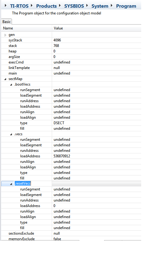

  • The above screen capture shows the Program view from the .cfg. I see the .resetVec, and is configured to start at 0x0... I don't see any corresponding field for .intvecs. Is that supposed to be in this "page" of the RTOS config and if so, where (I poked thru everything in the cfg viewer...)

  • erik skullerude said:
    It looks like the .resetVecs has the same start addr as intVecs? Why is this and how should I fix it?
    .resetVecs are the interrupt vectors from the TI-RTOS start-up code. .intvecs are the interrupt vectors from the start-up code added by CCS when a new empty project is created. Having these two sets of interrupt vectors causes the linker error.
    Since TI-RTOS has it own start-up code, if you delete the <device_name>_startup_ccs.c source file and <device_name>.cmd linker command file which were added when an empty CCS project was created that should remove the linker errors about trying to place .resetVecs and .intvecs at the same address in flash.
