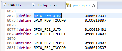

I need to use UART1 to send AT command to Sim800A module but it doesn't work. I know it because I didn't receive the message from my sim module. I need your help, I have to finish this project at the end of the week. It's urgent. This is my code:

You have the wrong constant in the calls to GPIOPinCongure().
GPIOPinConfigure(GPIO_PB0_U1RX); GPIOPinConfigure(GPIO_PB1_U1TX);
