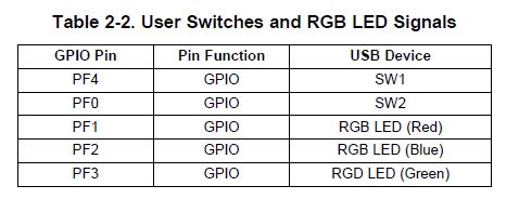

3.Tried to build it again,now there i am getting some errors that,LED1,LED2  etc are not defined.
I know the problem is there with board.c and board.h files of the program because no functions are defined for tiva leds under these files.
I tried to define those leds but i am not able to find where Led1 has to be defined as PortF pin1 and Led2 as PortF pin2.
If possible suggest some resources to go easily with the whole thing.
