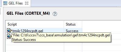

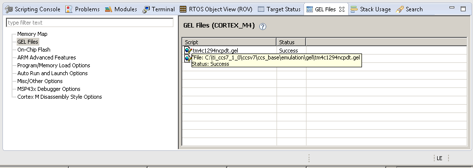

  • Hello all,
    I've confirmed that the Watchdog reset is the cause of the problem. But I'm not sure how to proceed with the GEL file (never worked with that).
    I've opened tm4c1294ncpdt.gel and placed the lines that Chester's mentioned, but the problem still remains.
    The code inside the file looks like that:

  • I know nothing about GEL - or any other hair styling products for what it is worth. But would it work if you enable the watchdog as late as possible into your initialization process, just before the main loop?
    I omitted to mention it, but CCS has a separate General Extension Language GEL file for each Tiva device, and the GEL file is specified in the Target Configuration File (.ccxml) file for the project. On creating a new target configuration for a Tiva device CCS will default to select the GEL file for that device in the CCS installation. However, the user may change the GEL file used.
    If you look in the GEL Files view in the CCS debugger and hover the cursor over a file name, CCS will report the absolute path of the GEL file in use so you can confirm the correct file has been changed:
    I tried to insert the OnPreFileLoaded() function in both files, one at a time like you suggested, but Watchdog is still interfering in the debug process.
