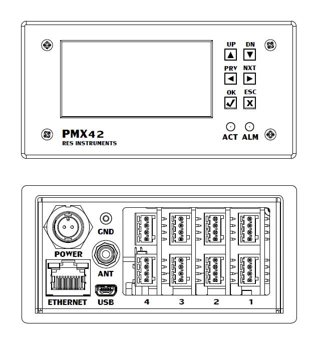

Fellows,
A colleague of mine designed a "multi-purpose" industrial meter based on TM4C129, with buttons, oled display, power supply, ethernet and slots for general daughterboards.
He created it "just because he can". The basic FW runs TI-RTOS, and there are daughterboards for optos, relays, RTC, ADC and I'm not sure what else at this point.
I SWEAR this is not advertisement - he does not even know I'm posting it, and it is not even a commercial product. Just thought I'd throw it in here, to hear if anyone has suggestions, application ideas, comments and what not.

  • Wow, neat application!
  • That's a nice slab of aluminum - carved to accommodate the OLED.    (and a nice-sized OLED - as well.)
    As to: "Suggestions, Applications, Comments" - without knowing the target market (there must be one), competitive postures, price-points and "Regulatory agency requirements" - meaningful input is difficult.     Numerals on display signal "RF" - particularly the VHF/UHF frequency spectrum - which often require agency testing/approval.
    Staff/I did note - especially for client ease - a 3x4 keypad (or larger) trumps the 6 panel switches - there (for now.)
  • Thanks Bob and cb1.
    Totally agree to your "(there must be one)", but I suspect that my buddy skipped that step - he has yet to really explain me what are the applications and markets he had in mind - and I don't think there is one. It was probably more "because he can".
    Also the carved aluminium was subject to discussion - I would run from it for cost, but he has a friend with the mechanical resources who has done a batch for free, so be it.
    Any examples of what you refer to as 3x4 keypad?
    Still, it is a cool concept - maybe something that the launchpad environment could consider... no, nothing beats the simplicity of 2.54mm spaced headers...
    My marketing question remains - what can that be used for? Colleague (also named Bob) is a master of analog audio and a great hardware designer, but he knows there's room for improvement on business steering (right Bob, if you are reading this?)

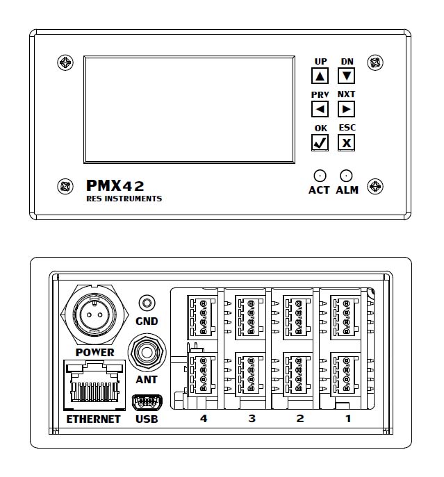

  • Thanks Bruno! The meter is a concept thing I've been playing with the past couple years on the side. Partly it's been a learning platform for the Tiva TM4C1294 and TI-RTOS. The motherboard and bus is fairly generic and the I/O cards will define it's applications. Currently I'm working on a dual channel RTD 3-wire temperature probe board using the AD7793, but still in progress. The first card on the left hand slot is the RTD card. The second is a dual small signal relay board with three opto-coupled inputs. Third card is a RS232/RS422 card and fourth is a Bluetooth module. Other than that it has the Ethernet, USB and SD card stuff supported by the Tiva. There's an Atmel serial number eprom and another generic eprom for storage also. The -12V switcher supply has problems unfortunately, but none of my card are currently using this rail.

  • Greetings - newly arrived - "concept thing" producing (w/excellence & attention to detail - I'd say) Robert.     (aka Bob II)     In Hollywood - where we are now - "aka" morphs to "pka" (professionally known as)
    Our small Tech firm has long designed/sold to: Studios: "TV, Movie, & Recording" - the fact that "Bruno's clandestine photo" - and your neat additions - overlap our current "studio meetings" may prove fortuitous.    (while skill/effort/experience are important - "luck" plays a key role too!   (though hard to "count upon")
    The use of, "6 switches" is the major weakness - to my mind - of this prototype.      I suggested a 3x4 keypad (i.e. telephone style) as this (far) better accommodates numeric entry.    (2 non-numeric keys may serve "Clear & Enter.")    If space allows - a 4x4 keypad enables Scrolling (line & page) & "dual valued" keys (via a shift key) nearly doubling the keypad's direct entry capability!
    I'm also fan of RTDs (over thermistors).    It would be interesting to learn how you chose (and qualified) the RTDs.     (Bruno can advise how he/I "PM" here - for material (beyond) general forum interest.)
    Many may be intrigued by your (relatively) big, bright OLED.    I'm estimating that as a graphic - 128x64 - possibly even larger.     Perhaps you can supply that OLED's spec - and comment upon your connection method to your TM4C?      And - as we are "at/around" Vendor's space - might you describe, "How you chose the TM4C?"     (note to Bruno - "tiva" est passé)     There are (many) ARM MCUs - even different categories: M0, M0+, M3, M4, M7 - and our new, "Autonomous Auto Destined, "R-52."
    Your "card-slots" are described as "generic."     Does that mean they follow some connection "standard" - so that "boards from others" may be accommodated?     (i.e. simply plugged in - Great Sales Aid!)
    Finally - did your screen shot list various RF frequencies "in play" for "ISD" and other, general use?    As your "slot population" did not include RF devices - my earlier "sense" of RF capability has diminished.
    And ("finally # 2") while there is undeniable "coolness" to Aluminum slab for front panel - firm/I have long found that "Delrin" is easily machined - and far "quicker & easier" carved/cut to (always) changing - client spec requirements...    Good job - while Bruno (likely) has your European rights - others (somewhat active here) (may) warrant your USA consideration...
  • Hi cb1_mobile, thanks for the feedback, comments, info and kind words!  The display is cool and I chose it for it's high brightness and ease of viewing as my vision fades with age. The display is from FEMA Electronics part number G12864F-24-OC3Y. It's sorta fragile mounting and won't take more than a bend or two on the flex, but works great otherwise. I'm not that good of a bit banger coder, but I managed to get a driver working following examples in the grlib source. The driver is not optimized and prints to the offscreen buffer and updates pretty quickly over SPI. I'll be glad to share the grlib driver if anyone wants it and wants to improve it. I think FEMA is located in CA somewhere near you, give'em a search on the web.
    I guess six switches would be nice, but space was limited as I was trying to keep it in a standard DIN meter sized case. Originally my hope was to find a niche for some sort of industrial type applications. My first thought we temperature monitoring, logging and ability to monitor/control across the web. Thus I was drawn to the TM4C1294 with it's strong communications capabilities and features. Originally I started out playing with the Stellaris parts from Luminary on another project, then TI bought them out and I eventually landed in the Tiva world. I was working with FreeRTOS on the Stellaris, but soon moved to TI-RTOS since it readily supported all the Tiva hardware and I wouldn't have to spend my life coding/debugging device drivers for Ethernet, USB, serial, etc, etc. I like to code RTOS environments and have been looking for a solid small form factor RTOS for years and TI-RTOS seems to fit the bill.
    Yes, it has four slots. The first two slots share one quad SPI bus and the second two slots share a second quad SPI bus. The last two slots have a number uart pins and the rest of the GPIO's are spread out across the connectors. I think I have only one GPIO left on the CPU. I envisioned other processors on the I/O cards communicating via the SPI bus if needed. Should be lots of room to do tricky things coding if needed.

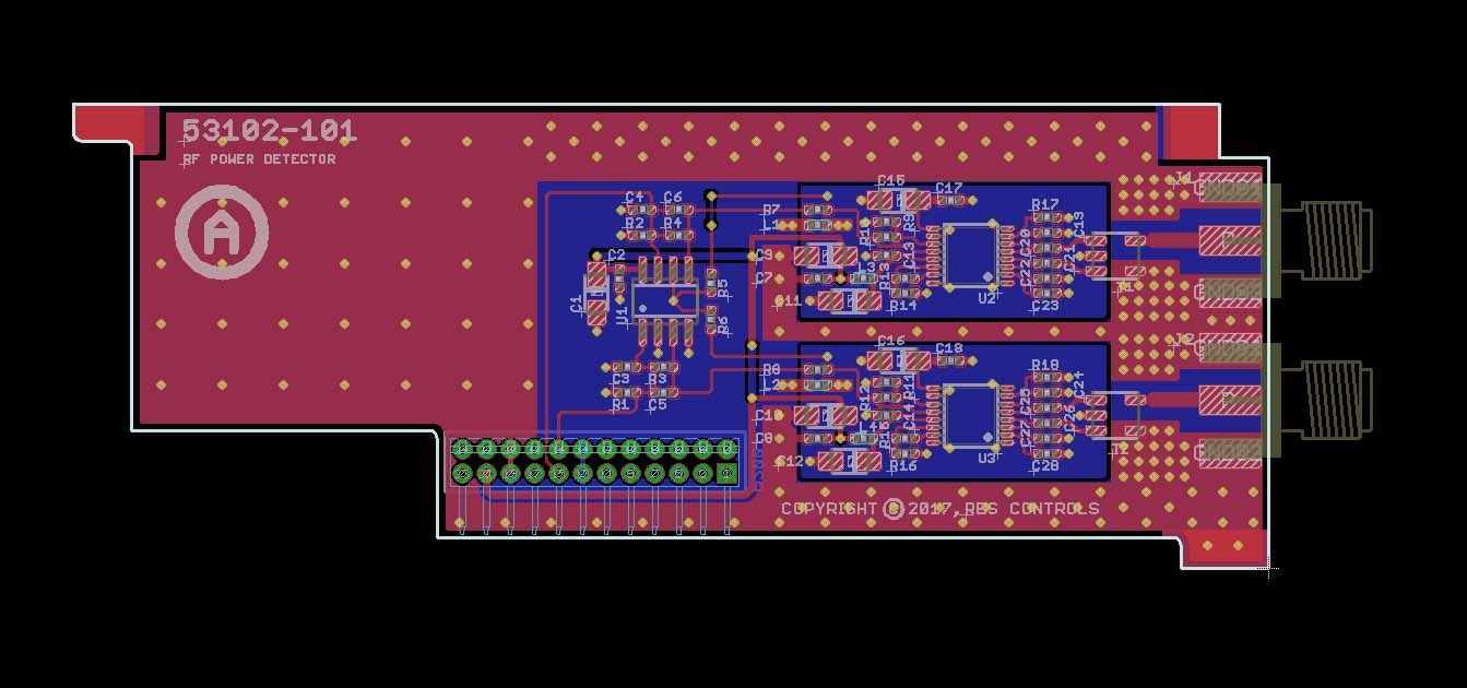

    Lastly, regarding RF possibilities, I have another I/O card I've designed but not build for small signal RF power measurements using a AD8362 part. Thought of making an SWR monitor for tower sites to monitor transmitters of some sort. It could send alerts and such over the net and log SWR readings and data to SD drive.

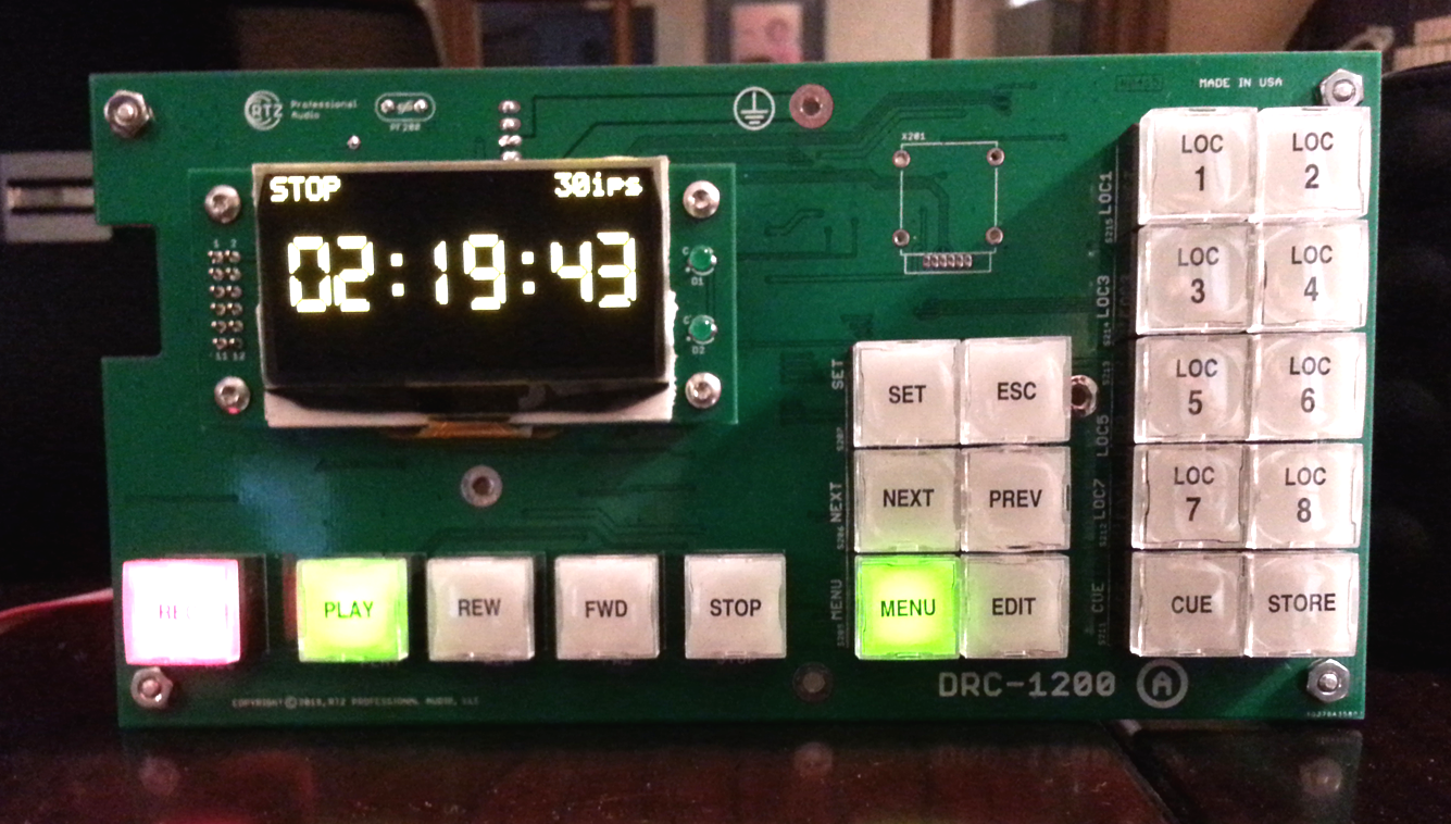

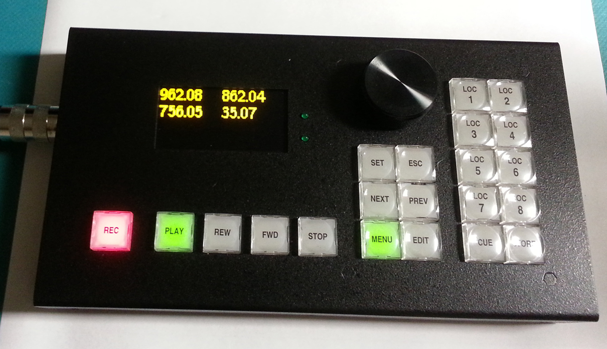

    Oh, here's another project I'm working on with Tiva 123 ARM. It's a tape transport controller for vintage Ampex 2" tape machines. I've been working on this for many years learning motion control and servo loop stuff. I recently got this board working and will be selling these soon, but it's a very limited market. This board is running TI-RTOS also and is working great!

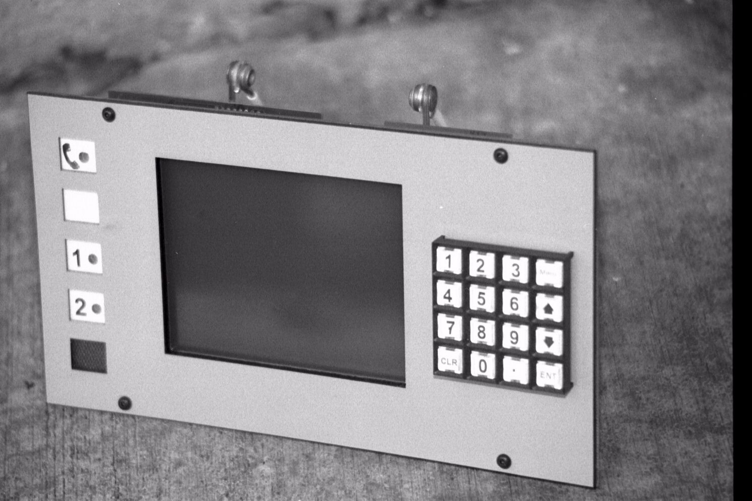

    Here is a (past) panel design - produced for and sold to multiple sectors w/in the "ISM" market.     (Industrial, Scientific, Medical - I "know" that you know - this for others)
    The Display is a high-contrast, CFL backlit, QVGA (320x240) - that's a "User Legendable" (4x4 keypad) which enables scrolling, menu recall, clear & entry - and multiple, audible & bright visual warning/alarming ports.     Panel is 228x127mm, display is 4.7" diagonal, "Legendable Keypad" is 51mm square.     Some of these panels saw "service" (in the desert) during hostilities.     Two photos reveal the Graphic Lcd just having been removed from the "Shake-Bake" chamber (after having been abused - (far) above spec) and the Lcd's Frit seal has suffered - Lcd fluid has "migrated" - and (still) the LCD worked!      More than 10K of these panels were built & shipped - and (still) today - replacement units are ordered.     (these units have exceeded their warranty periods by (more) than 20 years!)     Note that NO ARM MCUs were hurt or abused - during the "taking" of these photos.     (these designs preceded the arrival of ARM - employed 8051 & Z8 (not Z80) as central MCU.)

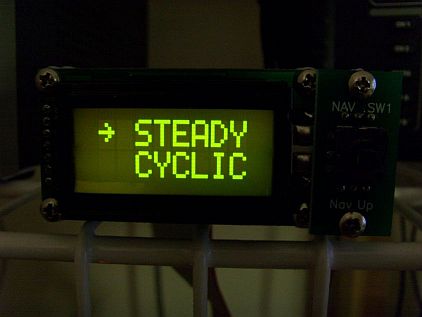

    Shown as well is (at that time) what we believed to be the world's smallest, "Intelligent I/O System."     A 2x8 Lcd (later replaced w/2x12 - same size) and a 5-Way Navigation Switch.     (four compass directions AND a "center" (enter) position)
    May serve to "note" that these designs were built to "accommodate" multiple (other) boards & key components - sourced by clients (a "free" Search/Find/Qualify/Augment source (i.e. client) is (the best such source!)- and this proved greatly helpful in, "Exceeding our (and our investors') Sales & Profit Expectations."
    FULL GRAPHIC, SUNLIGHT READABLE, WIDE TEMPERATURE, SHOCK/VIBRATION RESISTANT - MULTI-INDUSTRY/PURPOSE: SENSING, PROCESSING & COMMUNICATING DISPLAY PANEL    (Keypad may be Legended - in the field - by client - optimizing value/flexibility!)

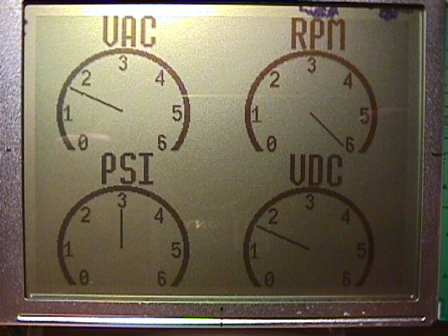

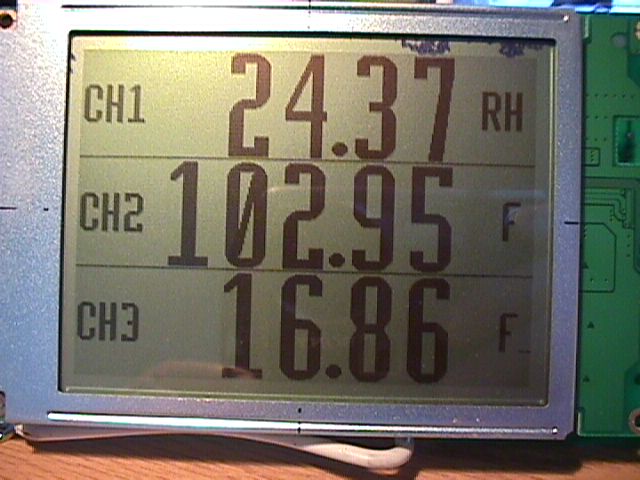

  • Yet more photos - revealing continued operation success - even AFTER sustained ABUSE!"    (Client's simply LOVED this robustness...)
    Beyond "spec" (by 20% - both shock/vibration and temp.) yet (still working)     Frit Seal failed (top right)
    Full Graphic Display & (inspired) software enabled ANY SIZE Text/Numerals - to ease reading (especially) during (stressful) conditions!)     Frit Seal "murder" again revealed.
    World's smallest (at that time) I'O system - 2x8 Char Module & 5-Way Nav Switch.    Note:   (LCD's "normal" 6 wire (4 Data) interface accommodated (BOTH) the Lcd & Nav Switch!)
    World's smallest I/O operating in (near) total darkness.    (backlight brightened - better revealing the Nav Switch - when the Switch was "active!")

  • Here's another remote control I'm working on using the same OLED and Tiva 123. I communicates to the machine via high speed RS422. The legends in the switch are replaceable also, but the switches are expensive. I'm using the QEI modules in the Tiva's for quadrature encoders. On the other transport controller board I'm using AMS magnetic based encoders that Bruno recommended and uses in his products - these work great!

  • Here's one last picture of the meter with a 7-segment style font loaded. The display and code is purely demo at this point. I do have a RS422 task running that blasts the display contents out to my other remote control unit for testing remote display capabilities over RS422 at 1mb/s.

  • Yes, 7-segment is old. But it looks cool on the tape machine remote control so I loaded here just as an example. It's a very limited and tired as you've noted and not likely I'd use it on the meter, but it's an option. I was testing out the font import tools with CCS/grlib and this was the first font I tried out of curiosity to see how'd it look. I don't think it even has a decimal point!

  • Just checked my drawing and found that UART0 and CAN0 are on the same pins. UART0 is available on SLOT-3 of my design, but looks like the USB is using the other pins that CAN1 would require. I'll have to investigate this further. One option might be to put another small Tiva on an I/O card for dual CAN support and talk to motherboard via the quad SPI bus if needed, then this card could go in any of the slots.
    The unit will run from DC 18V-30V currently and has a bridge rectifier at the input as well. A TI simple switcher provides system 5V for up to 1A, don't recall the range of this. Not sure what the absolute ranges are off hand, but there's another 7812 LDO regulator on board that provides the +12V from VIN for the display and other slot power rails. Another switcher provides -12V but this has some issues to be worked out still. Not knowing what power is required for the various I/O cards complicates things. Each slot also has a dedicated 3.3V LDO regulator for 200mA to each slot.
    Have to run out, but will I'll study your other comments and respond later. Would you mind if copied/pasted your suggestions to my blog also? I'd like to keep a copy of these notes there as well.
    Many thanks for the suggestions and input!
    Bob

  • I have a RF engineer friend that had mentioned make an RF power detector I/O card using the AD8362 part. This might be useful for SWR or other RF measurement applications. I might spin a couple prototypes of the board shown below at some point for testing. The outputs would feed two of the A/D inputs on the Tiva. Calibrating things would be the difficult part though.

    I do believe one of the pictures showed an SD card socket.
