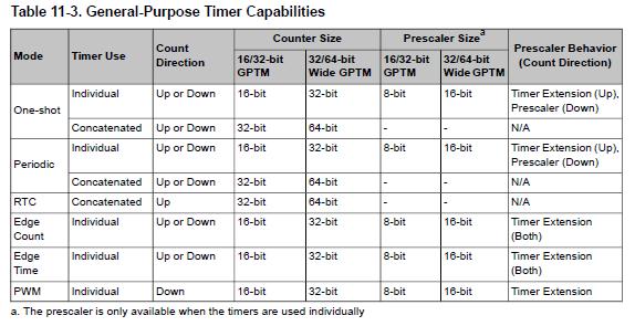

    My experience overlaps yours - here's a quote from my MCU manual: "16-bit input-edge count- or time-capture modes with an 8-bit prescaler" - now that's not especially telling - but the chart (below) is!
    Edge time appears 2nd from the bottom - and the Prescaler is listed as an "extender" and contains the high-order 8 bits.    Thus the Timer contains the lower 16 bits - the Prescaler the upper 8 bits.    Some Timers - to include the very one Bruno chose - "can & do" accommodate 32 bits - and the Prescaler then expands to include the upper 16 bits!     Had the Timer been forced into "wide Timer mode" - the rollover potential is significantly reduced.     That said - I believe it best to clear the Timer/Prescaler combo just prior to Enabling that pair.
    You've asked about the "timer read" - Timer_0A's lower 16 bits are the only ones valid - the full 32 bits come into play when config'ed as wide timer.     And yes - when that timer can be (via program)  "split from 32 bits into 2 16 bit timers.     But the Prescaler is NOT in the top order - it resides in a separate (prescaler) register.     The "independence" of the Prescaler from the Timer is why I believe separate "clears" are required for both.     (firm/I do not use 129x - so this all results from my 4C123 experience & manual read.)

    3) The rollover is not inevitable NOR expected. The ENC_PRESCALER is set to decimal 37. The "excessive number" was on purpose, exactly to try to obtain a timeout after 20ms (well calculated, cb1!). The timer0A free running value is zeroed before each capture cycle, via HWREG(TIMER0_BASE + TIMER_O_TAV) = 0 right before the timer is enabled. Then, another question arises: is it REALLY not possible to obtain BOTH the DMA transfer for each capture event - which is (almost) perfectly happening - AND the timer timeout, using the settings presented?
    4) Which values matter? Yes, I am concerned with the elapsed time between events, not with the values from timer start. And yes, they are exactly H-L-H-L (or L-H-L-H) counts.
    5) Where is the rollover? Precisely where cb1 marked red on his post. Values [3] and [4] of the "bad" sequence. The prescaler is set at 37, so the timer runs all the way to 2424832 before coming to zero. Let's look at the numbers again:

  • Well, I've got some more news...
    The rollover is INDEED due to the fact that the Prescaler counter has not been zeroed. Consecutive register visualizations of TAPS after each capture cycle shows that the counter keeps going up all the way to the 0x25 load value stored in TAPR.
    Despite the fact that the TAV register has both the prescaler (bits 23-16) and the timer counters (bits 15-0), writing 0 to TAV does not zero the prescaler counter (fair enough, the actual counter register is somewhere else, named TAPS...)
    BUT, the register TAPS register IS READ ONLY, writing to it causes no change. In other words, this seems to be a dead end, there is no way to zero the prescaler. TEXAS INSTRUMENTS folks?
    I can easily solve my issue just loading the Prescaler all the way to 0xFF, and checking for a rollover on the captured measurements... but still I'd like to see if I'm missing something here!

    I believe I have. TAPR is the one set to decimal 37, and it sets the maximum count of the prescaler. I tried a bunch of combinations, but this one has failed to be on my notes - still, for all I can see here, setting TAPR to zero and then back to 37 before I start the timer again did not bring TAPS to 0.
    As mentioned, the program is properly running with a trusted setting now, and "far different" now for a quick test. I might get back to doing a test when I have time for that - in which case, I'm planning to use a bare launchpad generating the PWM in a port, and wiring the signal across to the TCCP pin to measure an easy and known signal.
    cb1_mobile said:
    imposed by the (somewhat cryptic) "timer extension" label...
    Mostly ALL of the terminology on the Timers instructions are cryptic. Writer does not keep a consistence across chapters, registers, comments. Words like counter, current, load, extension, value, prescaler, true, divider, get conflicting and confusing. I guess that's their problem, somewhat not mine anymore as I got (most of) the real behaviors... Would have of coursed save valuable time, but well... I feel like vendor here knows all that and has "certainly decided to publish an ultimate version 'next year'"!
    cb1_mobile said:
    Use of this GPTM Reset appears, "beyond Brutal"
    I strongly believe THAT would clear the prescaler count - and indeed that's brutal. Certainly not something I want to do 400 times a second or so...
    In the end, I'm using the prescaler at full 8 bits, so I have a 24 bit timer. If I need to eventually check rollovers for 24-bit, that's the same for 32, so it won't make a difference - I can live with the extra 2 cycles of load/compare... If I had'n done that, the "absurd values" protection would still catch it - at the cost of a dismissed read cycle. Anyway, pros and cons for all choices...
    Only sour taste here is that we still have zero input from our official fellows! Other than that, this post became a nice timer study for victims of the future, don't?
    That should be a precaution you take in any case. No?
    Robert
  • Robert Adsett said:
    Bruno Saraiva
    It's also a simple masking operation after subtraction. Quite easy in C, you should try to deal with it in ladder logic :)
    Robert
  • True enough!
    With the advantage that, when using only 24 bits for the timer, you don't risk messing the "left" bits that deal with signal. Not in the mood for thinking right now, but I believe it ain't that simple if controlling 32 bit rollover...
    You're right, it's simpler.
    As long as you have a 32 bit data type the compiler will deal with it automatically. Technically it has to be unsigned but I've never seen signed cause a problem. In the case like Cortex where 32 bit is the native size the hardware takes care of it. You don't even need a mask.
    Robert
