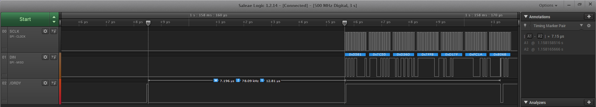

Hi Everyone,
I've been trying to receive SPI signals from my ADS1274EVM to the TM4C1294XL. To do this, I have configured the Falling Edge of the /DRDY signal from the ADC as the interrupt (at GPIO port F) for the microcontroller. While doing this, I found that the latency is unusually large, i.e. 6-7us, whereas it is supposed to be in the neighborhood of 1us (12 Cycles of a 120MHz system clock). I also set the interrupt priority to the highest, although it shouldn't make a difference as the GPIOF Interrupt is the only ISR I have defined. My code is given below, and I'd appreciate if anyone has any suggestions. Some code snippets and outputs from my Logic Analyzer are given below.
Setting Up GPIOF for Interrupts:
// Pin F4 setup for DRDY-Inverse
    SysCtlPeripheralEnable(SYSCTL_PERIPH_GPIOF);        // Enable port F
    GPIOPinTypeGPIOInput(GPIO_PORTF_BASE, GPIO_PIN_0);  // Init PF0 as input
    // Interrupt setup
    GPIOIntDisable(GPIO_PORTF_BASE, GPIO_PIN_0);                // Disable interrupt for PF0 (in case it was enabled)
    GPIOIntTypeSet(GPIO_PORTF_BASE, GPIO_PIN_0, GPIO_FALLING_EDGE);                          // Configure PF0 for falling edge trigger
    GPIOIntClear(GPIO_PORTF_BASE, GPIO_PIN_0);                  // Clear pending interrupts for PF0
    GPIOIntRegister(GPIO_PORTF_BASE, GPIOPortFIntHandler);      // Register ISR for port F
    IntPrioritySet(INT_GPIOF, 0);                                // Set Interrupt Priority Level
    GPIOIntEnable(GPIO_PORTF_BASE, GPIO_PIN_0);                 // Enable interrupt for PF0

Logic Analyzer Output
  • May I note the following?
    • You interrupt upon the falling edge of D_RDY - yet if you switched to rising edge - your interrupt would occur sooner!   (by D_RDY's pulse width)   Goal is response - not true measure of latency!
    • You "register" the interrupt - rather than placing it w/in the MCU's "Vector Table" - which I believe - achieves faster response
    • You impose the time for the interrupt to "clear" - PLUS the time for function, "SSIDataPut()" to execute - and class "those two delays" as interrupt latency!      Would not a GPIO toggle - as the very first instruction w/in said handler - provide a "truer picture" of interrupt latency?
    When running above certain speeds - does not that MCU suffer expanded number of  "wait-states" and/or other "crippling effects?"
    Beyond the above - I would switch (ideally) to a different port - and determine if there may be a "latency penalty" extracted by your chosen port - and pin.
    I agree w/your calculations and believe that you can improve results...

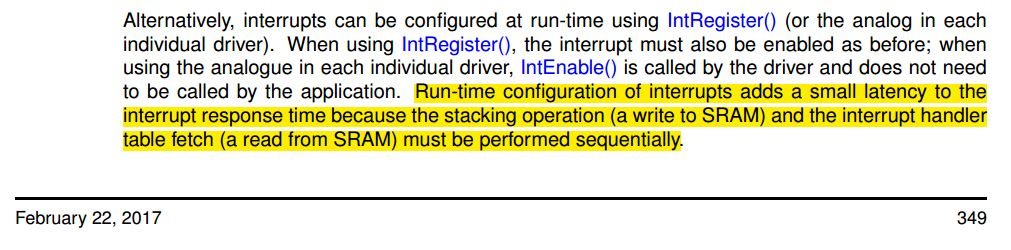

    Looking at the TivaWare_C_Series-2.1.4.178 source code shows that the GPIOIntRegister() function does place the interrupt handler in the Cortex-M4 "Vector Table"; GPIOIntRegister() updates the Vector Table in RAM. Where the first call to an IntRegister function copies the Vector Table from flash to RAM. Therefore, use of GPIOIntRegister() does't account for the observed large interrupt latency.
    Chester,
    It appears that you will have to argue with your colleague who's written the Tivaware User Guide:
    So, which statement is true? I would love to adopt only run-time registrations in our company's codes, but the text above has been making us edit the startup file for each project.
    Bruno
    Thank you for pointing me at that part of the Tivaware User Guide. To be honest, my comment about the use of GPIOIntRegister() was that function didn't add any extra software overhead to the interrupt handler. I.e. GPIOIntRegister() doesn't add any software interrupt dispatch logic. As you mention I didn't consider any hardware overhead in moving the Vector Table from flash to ram.
    Also, since I am not a TI employee am unable to directly talk to the author of the Tivaware User Guide.
    The statement from the Tivaware User Guide makes a vague statement about a small latency without quantifying the expected value of the latency.
    The ARM Cortex-M4 Interrupt latency documentation says:
    There is a maximum of a twelve cycle latency from asserting the interrupt to execution of the first instruction of the ISR when the memory being accessed has no wait states being applied. When the FPU option is implemented and a floating point context is active and the lazy stacking is not enabled, this maximum latency is increased to twenty nine cycles. The first instructions to be executed are fetched in parallel to the stack push.
    The ARM documentation that the first interrupt handler instructions are executed in parallel to the stack push implies that the interrupt handler table fetch has occurred before the stack push occurs, which is at odds with the Tivaware User Guide. That discrepancy between the ARM and Tivaware documentation suggests a measurement should be performed to see what the difference in interrupt latency is for a vector table in flash .vs. ram.

  • Hi! Thanks for your suggestions, those are good points. Sorry it took so long to reply, I was trying out all suggestions on this post (which are a lot! :-) )
    The DRDY rising edge in this case only occurs at the negative edge of the SCLK provided by the MCU- which is a part of the ISR. This is why the falling edge is necessary for the interrupt.

    I tried the GPIO toggle; what I found was that the latency is still around 5us. The time for the SCLK to start after the ISR is entered (that is, the delay due to Clear and DataPut) is only around 0.5us. Therefore, I presume the problem has something to do with the process of actually calling the handler.

    Does the "registration of interrupts" cause even "more latency" than we (long ago) measured - while proving more complex and resource demanding?    (slows response, demands SRAM & adds code - "such a deal!")      (Might it be that the 74 ADDED SysClks you've noted are the "gift" of your RTOS?)      Does not (something) here - "smell rotten?"
  • cb1_mobile said:
    It would be hoped that poster's Slave Device employs (normal for SPI) "push-pull" output - avoiding the need for "pull-up."
    I refer to the logic signal trace which tells the MCU that a new measurement is available, not to the SPI communication traces.
    cb1_mobile said:
    what's happened to, "12 System Clocks between Signal Arrival and Entry to ISR?"     (you've just reported 86 SysClks)
    This reported 86 cycles is a "real life measurement" in a system with lots of other interrupts enabled. On our systems, while one interrupt is being serviced, the others wait to completion. My point is that, even in a more complex system, with other peripherals working at the same time, the "latency" is still much shorter than what poster is facing in his system. Hence, in his case, I would check the three points suggested:
    - System clock
    - Trigger signal not raising/lowering as fast as poster believes
    - Other very long interrupts running while the signal triggered.
    There was no RTOS involved on these numbers. Again, they are not a scientific experiment, but rather just real numbers measured from signal transition to first line of interrupt. We are not trying to prove that 12 cycles is achievable, but rather to point that numbers obtained by poster, around 2ms, are simply too long.
    Bruno
