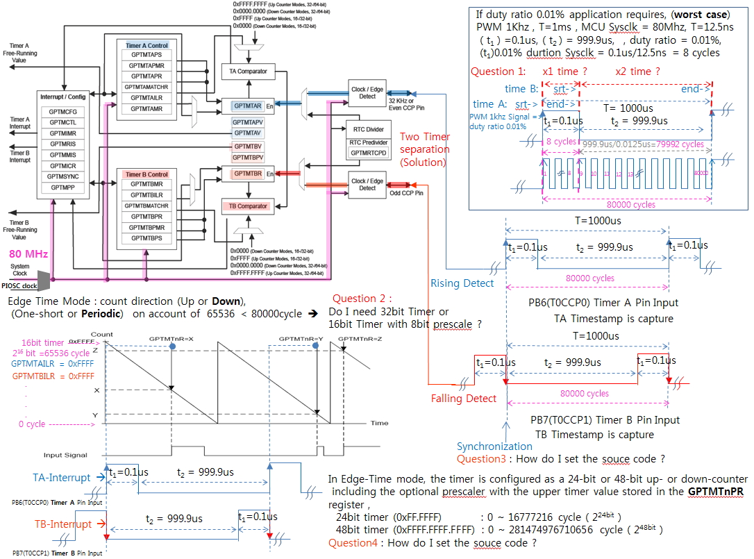

    I have a few questions.

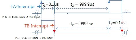

    Why does Mr. Amit use Timer B (T0CCP1) together?
    thanks

    There are two important PWM measurement parameters: PWM frequency (or its inverse, period) and Duty Cycle.   Duty Cycle may be defined by the application - but most usually represents the, "Percent time "Active" scaled against the PWM period.
    While your drawing is nice - it appears (to me) in error.     In terms of your diagram, Duty Cycle is that portion of the waveform which is at/around logic High and then "scaled" by the signal's period!     (i.e. Duty Cycle = Signal's time "high" / Signal's Period)    PWM Period is the time between back to back, like-polarity, signal edges.   (that designated by "T" in your drawing)    Your drawing neglects the scaling required between "Signal's time high & Signal's Period)
    Should highest accuracy be your goal it may prove best to capture the "time delta" between "n" such "like-polarity" signal edges - which will reduce the effect of "timing jitter" upon your measurement.    (you would then divide that "total duration" by "n" - to determine the signal's period.)
    The beauty of such an MCU and closely coupled IDE system is the ability offered to perform such code development experiments.      The "feedback" you'll require is immediate - which enables you to move systematically toward YOUR (more proper) GOAL of, "Jame's created code" - which (of course) does NOT have errors!"
    So James - time for you to develop YOUR "error-free" code - and provide it here for your "helpers."

  • I am not being sarcastic, Jame - I'm being sincere. Maybe in the near future, "harsh" comments like this will challenge you and make you a better professional. High class professionals on any activity don't become such without a lot of push, sweat, dedication. Again, if it was that easy to ask for "a working piece of software for my application", even I would probably need a better job! It is constructive criticism, don't understand it the other way.
    Do you want a few more minutes to try to figure out why the use of two timers? Then stop reading, close this message.
    ... (spoiler alert)
    When you configure a timer on capture mode, you need to choose the transition border that will trigger the interrupt: either rising, falling, or both. Once inside the ISR, there is no way to tell which was the direction that triggered it if you had chosen "both". Hence, you can measure 3 consecutive transitions, but you can't tell the difference of a 30% cycle from a 70% cycle. If you divert the signal to two timers, and configure one for rising transition, and the other for falling transition, then you can tell the difference.
    There is a workaround: if your signal is not tooooo fast (there are discussions elsewhere here as to the practical limits), you can use only one timer, set the interrupt to either falling/rising, and once in the ISR, read the pin status to tell if it is high or low. A second, faster workaround - but more complex - is to set a DMA transfer of both the GPIO and the TIMER counter when the transition occurs, so that you record "the whole picture" on transition instant, and evaluate it later on.
    Don't get too desperate - this whole comprehension of all the timer's nuances will not come in a week's study. It naturally takes time to mature.
    Bruno

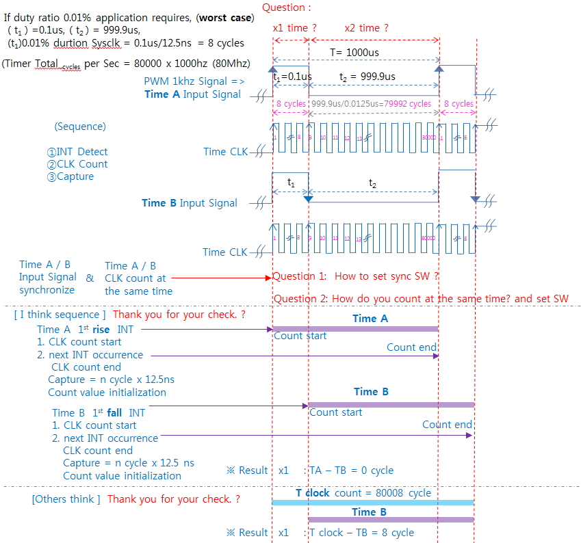

  • Hi Jame,
    Your PWM period is 1Khz according to your diagram. But what will be your duty cycle?
    Let's do some calculation. 1Khz means 1ms period. if you need to capture a 1% duty cycle then it means the duty cycle width to capture is about 10us. Let's say you only use one timer and enable both edges to generate interrupt for capture. If you are running at 80MHz then the CPU clock period is 12.5ns. The 1% duty cycle is then equal to 10us/12.5ns=800 CPU cycles. At the rise edge an interrupt is generated. In the ISR you will record the timestamp put into a temp variable. At the next fall edge you will generate interrupt again. In the ISR you will again record the timestamp. The difference between these two timestamps is your duty cycle length in terms of # of cycles.
    If you don't have a lot of code in your ISR then there should be no issue to serve two interrupts within 800 cycles.
    But, what happen if your application requires your to capture a duty cycle that is 0.01% of a period? 0.01% means you need to capture a duty cycle width that is 100ns. This translates to 8 CPU cycles. This will be kind of too short for the CPU to service two interrupts (one for rise edge and another for fall edge). The reason is that the first time the CPU sees a rise edge interrupt it takes some time to enter the ISR. By the time the CPU is in the ISR trying to read the timestamp the timer capture register has already been overwritten with the timestamp for the falling edge. You cannot measure your 0.01% duty cycle if this is your application using one timer.
    If you have two timers then you can capture the timestamp for the rise edge using let's say timerA. After the rise edge interrupt is generated the timestamp is captured. When the fall edge interrupt is generated, even though it comes very fast in about 8 CPU cycles, the timestamp for the fall edge is captured into the timerB which does not overwrite the capture register in timerA. This is the reason that two timers are used.
  • Hi Charles,
    It should be noted as well that the "Two Timer" method (which "sprang" from my far earlier suggestion of "KISS") proves far simpler & faster to program & implement - and that (always) should be a strong consideration.    The time for "absolute optimization" is NOT during, "First Pass Code Development" - instead should only be attempted when it has been "proven" that any such "optimization" answers a "real need" or yields a measurable "saving."    (thus justifies the required extra time/effort/cost.)
    I wrote - rather clearly for Jame - that one timer captured "Rising Edge" - the second "Falling Edge" - his "miss of that" may indicate that "several slower readings" of  detailed, "helper response" will prove helpful.
    Again - the "demand" for "error-free" code is highly unusual - and is outside the purpose & intent of this (and to my mind) "ANY" forum!  Each/every forum user - in pursuit of such - must employ (their own) time/effort/diligence - in that pursuit!        It is NOT something to be "commanded" - and/or "ordered up" - which appears to be poster's (improper and/or misunderstood) desire...

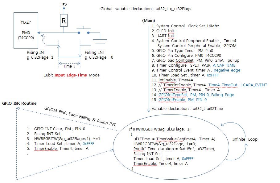

  • Hello Charles.
    Thanks for the detailed explanation.
    I analyzed it with what you said.
    I have figured out what I understand.
    Is it right ?
    thanks.
    [Attached Images]

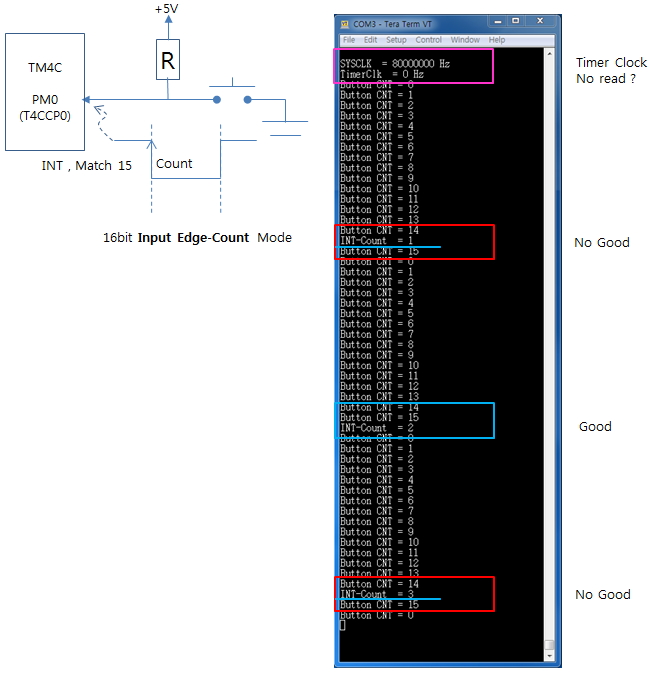

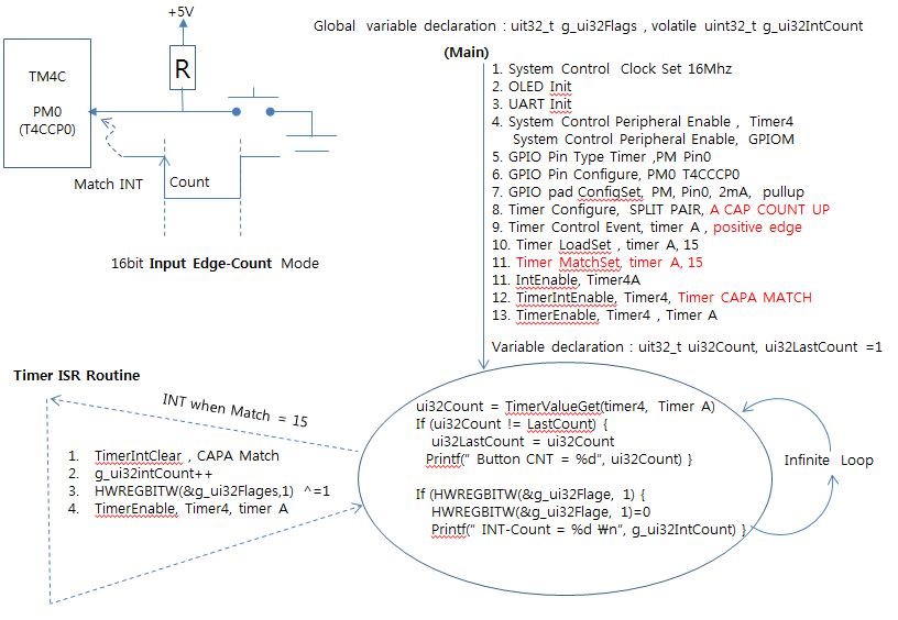

  • Charles.
    Go back to the first question
    I have two worries.
    1.  Can not read the clock of the set time module?
    2. The order of the Printf statements depends on the position of the interrupt routine.
        How do I change it?
    Thanks.
    [Attached Images]

  • Hello Jame,
    You did a great work with these diagrams and on your understanding. Well done! A few more notes to help you achieve your goal:
    1- If it was not clearly said, your timers will need to run synchronized. Here's a thread about it as guidance:
    e2e.ti.com/.../587248
    2- You don't have to permanently monitor the timer value in the main loop, just let the interrupts do it for you. Here's an idea (this is untested, just wrote it as an example...)
    void Timer1A_ISR(void)
        uint32_t ui32Status;
        ui32Status = ROM_TimerIntStatus(TIMER1_BASE, true);
        TimerIntClear(TIMER1_BASE,ui32Status);
        if (ui32Status & TIMER_CAPA_EVENT)
    	  pwmRisingCountLast = TimerValueGet(TIMER1_BASE, TIMER_A);
    	  flagNewCountAvailable = true;
    3- Same applies, of course, for the other timer
    4- Inside your main loop, you can make new calculations only when needed. Something like this:
    while(1)
        if (flagNewCountAvailable)
    	  MakeCalculations();
    	  flagNewCountAvailable = false;
    5- For the calculations, you need to mind that the 16-bit timers are actually smaller then the expected period (unless you want to wire the signals into two 32-bit timers, which is a good idea)
    void MakeCalculations(void)
         * period = the clock difference pwmRisingCountLast - pwmRisingCountPrevious,
         * BUT accounting for rollover and timer width
         * dutywidth = the clock difference pwmFallingCountLast - pwmRisingCountPrevious,
         * also minding rollover and widths
        duty = dutywidth / period;
        pwmRisingCountPrevious = pwmRisingCountLast;
    6- If you are seeing your values on a console via UART, or on a screen, there is not much point in seeing then 1000 times per second. So you may want to determine a more convenient moment to send the current result. Also, you may want to use some filtering or averaging on your readings, depending what your sensor is.
    By the way, what editing program do you use to create those schematics?
    Bruno
  • Hi Jame,
    Very nicely drawn diagram. Your understanding is correct on the behavior and how to handle such a situation using the robust two timer solution.

    I have one question.
    Why can not I read the timer clock?
    - UARTprintf("TimerClk = %d Hz \n", TimerClockSourceGet(TIMER4_BASE));
    thanks
  • Jame,
    What are you trying to read?
    TimerClockSourceGet() will return either one of two defined macros: TIMER_CLOCK_SYSTEM or TIMER_CLOCK_PIOSC, not a "numeric value". That's explained on 29.2.2.3 of Tivaware Driverlib User Guide.
    Are you looking for the frequency value of the clock driving the timer (as in 80000000)?
    - you could use that TimerClockSourceGet() first to confirm that the timer is being driven by the System Clock
    - if so, read the system clock - in your case you are using TM4C123, so that can be done via SysCtlClockGet()
    - Otherwise, then the value is PIOSC, which is a less precise 16000000 Hz clock.
    But you don't usually need to read that frequency during runtime calculations - you just better make sure you configured the timer with the clock that YOU want, and save that value in some variable.
    Bruno
  • Bruno
    In the above edge counter source, the timer clock is set to system clock.
    TimerClockSourceSet(TIMER4_BASE, TIMER_CLOCK_SYSTEM); // TIMER_CLOCK_PIOSC or TIMER_CLOCK_SYSTEM
    So I want to read the timer clock.
    thanks
  • Jame,
    I believe that is exactly what I just replied and explained to you. Please read my previous message again and let me know.
    Bruno

  • Jame,
    Running at 80MHz, each systemClock takes 12.5ns. The period evaluation is pure math - you have to discover how many clocks passed between events and convert that to an amount of time.
    Bruno

  • Hi Jame Shin,
    Bruno is correct that syntax only returns the source clock used for GPTM module not the value of counter registers relative to source clock time.
    So we must read the GPTM register count after an interrupt to get the value for edge time examination. The datasheet explains each GPTM configuration mode in great detail yet document GPTM errata may effect method or count direction depending on usage. Be sure to check errata document for GPTM modes effected.

  • Hi Jame,
    Sorry for the late reply. What Bruno meant to say was that the API simply returns the register value which indicates what the clock source is, not the frequency of the clock source. Please take a look at the API function where the timer control register is read to return the API function.
    uint32_t
    TimerClockSourceGet(uint32_t ui32Base)
        // Check the arguments.
        ASSERT(_TimerBaseValid(ui32Base));
        // Return the timer clock source.
        return(HWREG(ui32Base + TIMER_O_CC));

    It has changed to the amount of time Mr.Brono said.
    To apply the source code to multiply the total number of counters by 12.5 ns
    (calculate)
    x1 time = 12.5ns x 8 cycles (count detection) = 0.1 us
    x2 time = 12.5ns x 79992 cycles (count dection) = 999.9 us
    But there is something I want to ask.
    What procedural method does the x1 timer value detect?
    Because of the very short 0.01% duty ratio, ISR jump processing problems
    I understand the reason for separating the timer.
    2 Timers are synchronized, starting with different edge interrupts and counting to the next interrupt.
    How do you know the counter value of X1?
    thanks.

  • Hello  charles.
    Please let me know 4 questions in the attached image.
    thanks
    [ attached image]

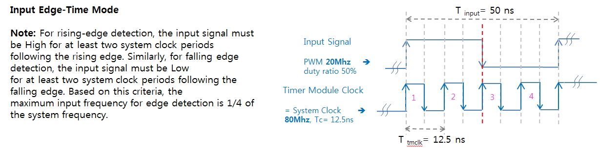

  • Hi Jame,
    Jame shin said:
    In the attached image, please explain why the timer clock is at least 4 times the input signal ?
    The GPTM source clock does not have to run a SYSCLK speed and can depending on the application use PIOSC 16Mhz internal precision clock source gives timer a 62.5ns tick.
    Sorry for confusing your edge time example software request, it seemed you were requesting to calculate the rising edge time and not specifically concatenating the time between two different edges which has nothing to do with rising edge time. To keep it simple try to calculate edge times for CCP inputs as a total number of GPTM ticks relative to SYCLK or PIOSC using the formula 1/F. Not sure why exactly the need to use two CCP inputs interrupts when a 24 bit edge timer should easily determine the frequency of a single input signal relative to GPTM timer ticks.
    There is a formula in datasheet use to determine GPTM source clock rate relative to CCP input frequency GPTM might be expected to measure.
    BTW 1Khz = 1ms does it not.
  • Hi Jame,
    A1: I thought you already had your answer in the diagram. x1=0.1us or 100ns. x2=(1ms or 1000us)-0.1us=999.9us
    A2: You can do with 16bit+8bit. 2^24=1677721*12.5~=210ms which is more than enough for your application.
    A3/A4. I don't understand your question about setting the source code. Are you looking for the APIs? Please refer to TimerPrescaleSet and TimerLoadSet if you want to use 24bit timer.
  • Hello Charles.
    I have not correctly communicated the key questions. Sorry
    A1 Answer the question again ..
    In the block diagram, the time values of x1 and x2 are displayed.
    I first asked the edge time question to refer to the post address e2e.ti.com/.../1676315. .
    In the course of the question, x1 and x2 are preset values to account for the worst case.
    If the time value is detected with a very fast time (0.1us) of duty ratio of 0.01% for only one timer,
    there is a problem that the time stamp is overwritten.
    So the problem is that we do not know the time value of x1.
    As a solution, I explained that one timer is not used as a timer and two timers are used.
    Timer A also sets an interrupt on every rising edge.
    And Timer B sets the interrupt occurrence every Falling.
    Therefore, the MCU can not know the x1 and x2 time values
    I think I will detect the time value in procedural sequence.
    The timer starts when the first interrupt occurs and ends when the next interrupt occurs
    How can I detect the time value of X1 because Timer A is interrupted only when rising and Timer B is interrupted only when it is falling?
    thanks.
  • Hi Jame,
    Sorry, I'm not sure I understood your question. You will synchronize both timer A and timer B so they will start counting at the same time. In the interrupt for timer A (when a rise edge is detected) you read the captured timestamp value from timer A. In the interrupt for timer B (when a fall edge is detected) you read the capture timestamp value again from timerB . The difference between the two is your x1.
  • Hello Charles.

  • In defense of vendor's Charles - we do not know how he could "write any more clearly!"
    Is it possible that your drawing contains too much - thus overwhelms the thought process?
    Charles described the use of TWO Timers - one configured to capture rising edge - the second to capture falling edge.    The input signal is routed to BOTH Timer pins.   (i.e. it is the SAME signal)
    You ask, "How to implement "Sync" between these two timers.    That's a standard function - available w/in the API - unknown how you've "missed" that.
    The "beauty" of the TWO Timer method is its simplicity - again as Charles (clearly) wrote - the "difference between the Two Timer's latched values, "IS your x1.""
  • Hi Jame,
     I prepare a simple example to demonstrate using two timers to calculate the duty cycle. I was able to measure a duty cycle that is is 0.01% of 1kHz PWM. The timer measures  the duty correctly. You need to modify/adapt to your application. The example calls TimerSynchronize(TIMER0_BASE,TIMER_0A_SYNC|TIMER_0B_SYNC ) to synchronize the two timers. However, since timerA and timerB shares the same timebase, the synchronization should not be needed but you will need if you plan to use between different timer generators. For timerA and timerB that I use from TIMER0, I don't see any difference in the duty cycle with sync or without sync.
    3124.tm4c123_timer_edge_time_mode.zip
  • Hello Charles
    Thank you very much for your answers so far.
    I have corrected the wrong idea.
    Finally, there is two question.
    It was previously described.
    I thought I needed at least 8 cycles to process the ISR jump.
    1. How many cycles do you need to handle the ISR?
    2. What is the maximum period time of detection in input edge count / time mode?
        -  when time module  clock 80 MHz or 40 MHz
    thanks.
  • Hello again Jame,
    First, let me recommend you change one section of your drawings to represent the real signal into two timers. In a few places, you've drawn offset signals going into timers A and B. I have dragged one of them to represent what will actually happen, so that other readers don't get misguided:
    Next, to answer your questions:
    A) How many cycles does the interrupt routine take?
    There are a few manners you can count that:
    1) By measuring the time externally: configure a GPIO pin as output, and before the code block you want to measure, raise it high; right after the block, raise it low. See the signal in a oscilloscope. The time difference is the period those instructions took, PLUS the commands to raise and lower the GPIO (TOTAL_CYCLES). Then, use the same raise/lower instruction right next to each other, and measure that amount of time (TOGGLING_CYCLES). If you subtract the toggling cycles time from the total, you'll get the STUDIED_CYCLES time. Note that code optimization will affect it, so you can measure with optim turned off for a worst case.
    2) Looking at the assembly code of your complete block, and adding by hand the instruction cycles taken by each assembly instruction.
    3) Instead of using GPIO, configure a wide timer to run continuously, sourced by system clock. Before the code block, read the free-running timer value. After the code block, do it again. Note the difference in cycles. As with the GPIO concept, subtract the amount of cycles taken by two adjacent timer read instructions.
    4) Some more powerful IDE's have features that tell you how many cycles a given block requires.
    B) What is the maximum period of detection that the system can measure:
    I'd say this is a good question for you to calculate and respond. Given that this thread has been a extensive study of timers for you - and maybe to others in the future - do you agree that this answer will serve as a final exercise? Do your maths and propose an answer here, I'm sure we'll be able to take a look and guide a correction if needed.
    Bruno
    Common misunderstanding: new programmers tend to confuse the value returned by TimerValueGet(). That can be partly (fully?) to blame on the TivaWare User Guide, which says:
    "This function reads the current value of the specified timer." - such is UNTRUE! The code for that function is:
    return((ui32Timer == TIMER_A) ? HWREG(ui32Base + TIMER_O_TAR) : HWREG(ui32Base + TIMER_O_TBR));
    Register TIMER_O_TAR (or in other words GPTM_TAR) full description:
    "This register shows the current value of the Timer A counter in all cases except for Input Edge Count and Time modes. In the Input Edge Count mode, this register contains the number of edges that have occurred. In the Input Edge Time mode, this register contains the time at which the last edge event took place"
    It DOES NOT MATTER how many cycles your system takes to get into the ISR. When you get there and obtain the timer value, such value will reflect that "old" instant in which your signal transition happened.
    Bruno
  • Hi Jame,
    1) I never said it takes 8 CPU cycles to get to the interrupt. I took your application use case (1kHz input PWM) as a reference and tried to derived how many cycles would be if the duty cycle is 0.01% which is 8 CPU cycles. Then I said 8 cycles will be too short if for the CPU to service the interrupt before the next edge is detected and then overwrite the captured value that has yet to be read by the CPU. If you want to measure how many cycles it takes for the CPU to enter the ISR, this is what I will suggest. You use the same rise edge interrupt. When the edge is detected the timestamp is saved into the GPTMTAV, Immediately in the first instruction inside the ISR you will read the GPTMTAR register. The GPTMTAR is the free-running counter. The difference between these two registers is roughly the time it takes to enter ISR. Note that Bruno has very suggestion too.
    2) The maximum period depends on your source clock frequency and whether you use 16bit, 24-bit, 32-bit or 48-bit. You simply multiply your CPU clock period by the timer resolution you are using.
    Charles,
    You might be inducting further confusion here... If using the split signal into two timers as suggested, this is NOT a limitation.
    Bruno
  • Hi Bruno,
    Yes, you are correct. Perhaps the poster (or anyone who is following this thread) needs to go back to my original reply for my analysis. When I said it was too short, certainly I meant if one timer solution was used then the captured timestamp for the rise edge will be overwritten by the captured value for the neg edge before it is read.
