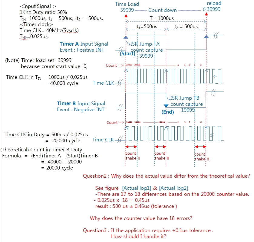

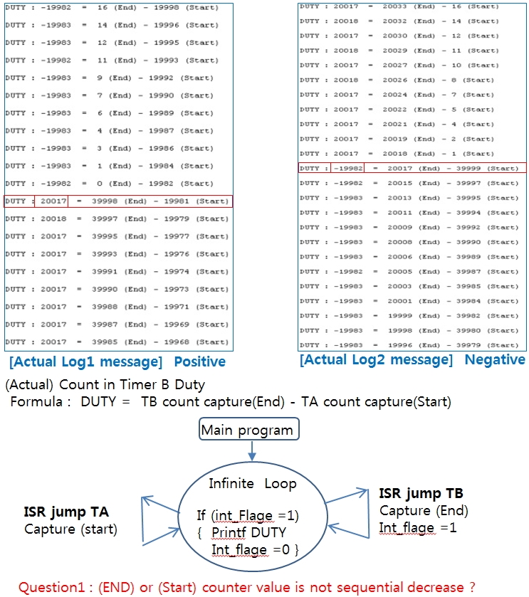

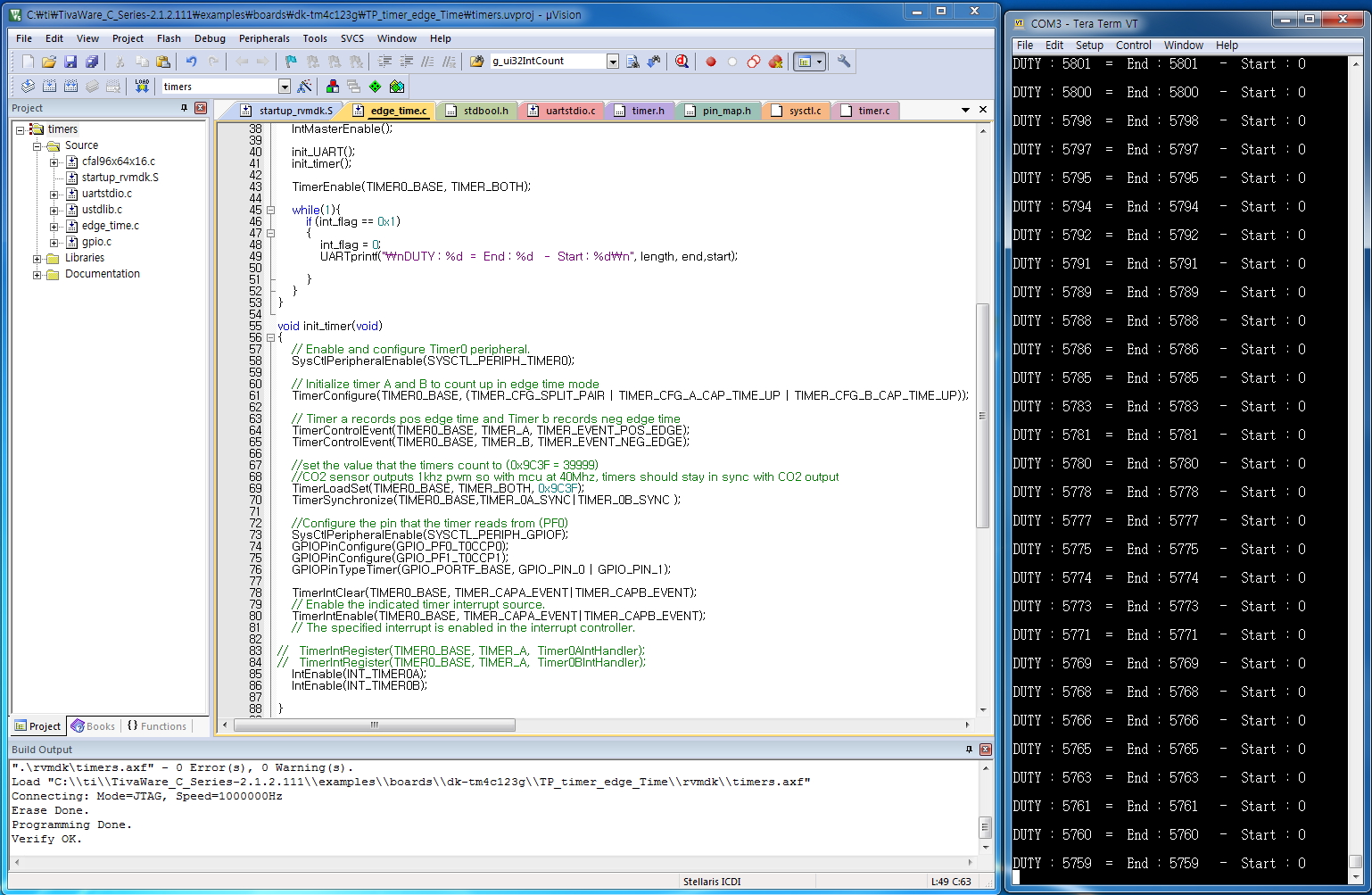

  • Hello Charles.
    I have been studying the source code you designed. (3124.tm4c123_timer_edge_time_mode.zip)
    Input condition is 1Khz duty 50% signal. (TM4C123gh6pge, Port F, Same signal , Simultaneous input PF0(T0CCP0), PF1(T0CCP1) )
    (Timer0AIntHandler, Timer0BIntHandler), only Timer0A does not jump to ISR.
    I am worried and I am going to ask questions.
    Q1> Let me know what's the problem. ?
    I thought of the output of the log output below.
    timerLoad vlaue , 39,999 ( 40,000 - 1 count) ,
    Q2>  why is 1 minus ?
    - timer module  clock 40MHz ( T_clk : 0.025us)
    1Khz, duty 50%  T_input : 1000 us,  t1: 500us , t2: 500us
    (Result ) DUTY =  500us / 0.025us = 20,000
    Q3>   Is this correct, duty = 20,000 ?
    thanks
    [Attach image]
    1. CCS Tool
    2.  Keil tool
  • Jame shin said:
    (Timer0AIntHandler, Timer0BIntHandler), only Timer0A does not jump to ISR.Q1> Let me know what's the problem. ?
    The problem is that pin PF0 is special, and you did not notice it. You need to unlock it before changing its configuration. Read this.
    e2e.ti.com/.../374640
    Because after the timer initialization, the first value is zero. Although that's not too important on the overall precision of the involved signals, it is reasonable to use the correct concept.
    Jame shin said:
    Q3>  it's correct , duty = 20,000 ?
    Duty is expressed as a relation between the up time of the signal and the total time of the signal, or TimeON / (TimeON + TimeOFF). It is a value between 0 and 1. Since you don't show the ISR code, we can't say what you are reading for now, but 20000 is certainly only one of the values involved.
    MORE IMPORTANT:
    Do NOT try to synchronize your sensor output to your MCU's timer, as you are doing (aiming at 40000 clocks). There is nothing that guarantees that they are in sync, and you will have very weird results. The method to measure the duty is to use a continuous timer all the way to it's maximum size (most people prefer counting down); store the previous up transition count, store the down transition count, and from then on, one every up transition, perform the calculation using the three values. Pay attention when the timer rolls over - if you don't treat that, you might have false negative duties some times.
    Bruno

  • Hello Bruno.
    Let me know about three questions.
    Attach images to help you understand.
    thanks.
     [Attach images]
  • Jame,
    1) Read again my message from two days ago, the part which starts with MORE IMPORTANT. You seem to have ignored it.
    2) You are still confusing duty with period. Google for PWM and try to really understand those.
    3) Your signals certainly varies 18 CPU cycles, simple as that. If you need better tolerance, you need to check if the sensors you use are able to deliver that, you need to check the capacitance of your traces, the healthy of your signal, all the details that bring measurements to the next level. It is not unusual in measurement science that 10x better accuracy costs 100x more time and money to be achieved.
    Bruno

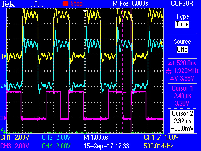

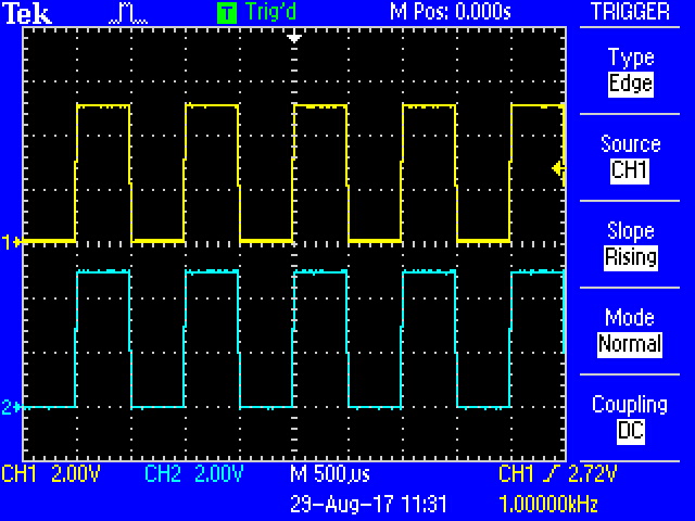

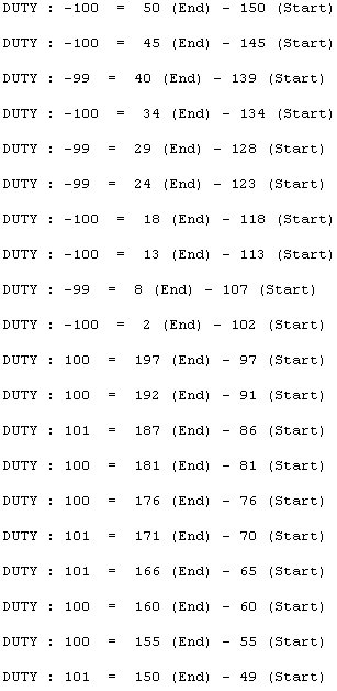

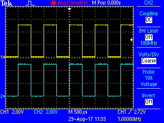

  • Hello Bruno.
    Before I first asked the question e2e.ti.com/.../2286628,   I thought about several things.
    Line capacitors from previous answers, input signal status checks
    What I think is as follows.
    1. It is a counter error to jitter inside the MCU chip.
    2. The Timer Module clock inside the MCU chip shakes.
    3. Detection input signal shakes
    The input signal is not shaken to the scope as confirmation.
    The input signal uses the PROBE COMP 5V & 1KHz signal in the oscilloscope.
    Re-question 1> Why does not the counter value on the log picture go out sequentially?
                          - I do not know the previous contents. Please explain in detail.
                         - Ask question 1 in your previous reply.
    Question 2> Is the 1Khz signal fast?
    The ultimate goal is to detect the 20Mhz input signal at an edge time of 80Mhz
    However, due to the edge time error of 1Khz input signal, we can not go to the next step.
    Question 3> Is it possible to detect edge time of 0.05us and half period of 0.025 us?
    -  The datasheet details the possible edge time or counter capture.
    - The input detection signal is described as detecting up to 1/4 of the system clock.
    thanks.
    Based on my experience, there is zero chance of either of the above
    While "shakes" is too much of a generic description, that's what myself and others suggested: the sensor signal is probably not precise to 12ns - does the vendor guarantee that precision? Do you need that precision for your application???? What DUTY variations are you getting??? You have not yet informed such.
    Can you provide evidence to such? How many samples did you log with a oscilloscope? Do they all show the very same duty cycle? I don't think so... Even on a reasonable 100MHz scope, if you apply a "typical PWM 1KHz sensor output", you will see variations at least on the 0.01% scale.
    To measure duty of that signal, your CPU needs to perform VERY SIMPLE CALCULATIONS after every rising edge transition. It has almos 80 thousand clock cycles to do that. I'd say that those calculations don't consume more than 200 cycles, leaving +79,000 clocks for a good rest! While there is no such thing as an official designation for "fast signal", do you think 1KHz is fast?
    There are a few posts on this forum discussing the minimum capture period of a timer on TCCP mode. They all show the 1/4 cycle. You have been repeating and/or adding new questions to this already long thread, and this is just getting confusing and not really helping either yourself or anyone else. I'd suggest you reorganize your thoughts, read about the PWM signal definitions, apply the full-width counting approach mentioned before, and also read the "minimum period capture" posts available around here. Then, if still doubts remain, post a new, separate, concise question.
    Bruno
    No. That's unlikely. There is an inherent precision measure of +/-1 count with a digital devices but that's really all you are dealing with.
    I believe the word you are looking for is jitter. Shaking involves physical movement.
    However this does raise a question. What are you using for a clock source?
    How have you taken this measurement? Note that you measure on the IC 18 counts in 20000 or 0.09% so whatever technique you use must have better accuracy, precision and stability than this.
    On a cycle by cycle basis!?? Not going to happen. That would leave 4 cycles between cycles for all your setup and calculations.
    If you have the simpler task of verifying frequency every few ms or so there are much simpler techniques.
    Robert

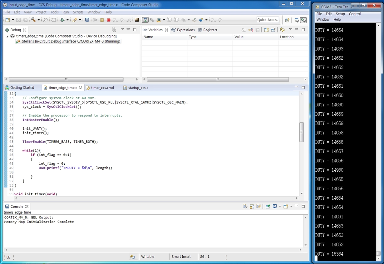

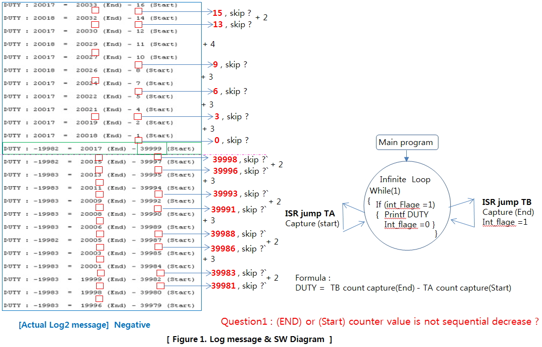

  • Hello  all.
    Thank you for your reply.
    How do I resolve this jitter? ?
    I will ask the attached image and concise again.
    1. Why skip instead of sequential?
        [ Figure1. Log message & SW diagram]

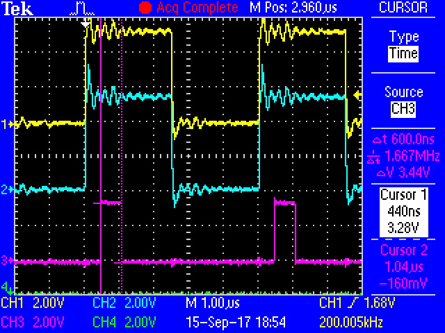

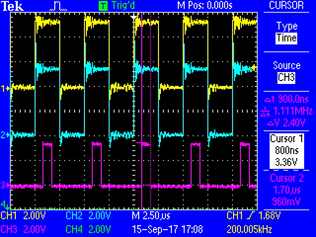

    2. Attach the image to the input signal status.
        Oscilloscope sample rate 1GS/s (CH1: T0CCP0 , Ch2 : T0CCP1) ,
        How do you view the image?
       - Is the count error generated by the external input signal not the internal MCU
    Finally,  How do I resolve this issue?
    After solved, I want the final target to detect 20Mhz of input signal.
    thanks
  • Jame,
    The good news is that your 1KHz duty cycle measurement is very easy to be done. I have already given you two suggestions that will solve these details and produce reliable and consistent readings.
    The first piece of bad news is that I will not waste my time repeating them. You can read the previous posts and try to figure it out.
    The second piece of bad news is that this story of measuring 20MHz has nothing to do with the original goal, and as said before, it is not possible to measure a continuous 20MHz signal with a TM4C123.
    Bruno

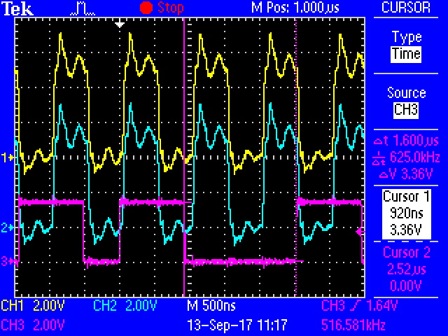

  • Bruno
    Q> Please let me know why. ?
    " Input Edge-Time Mode "
    Note: For rising-edge detection, the input signal must be High for at least two system clock periods
    following the rising edge. Similarly, for falling edge detection, the input signal must be Low
    for at least two system clock periods following the falling edge. Based on this criteria, the
    maximum input frequency for edge detection is 1/4 of the system frequency.
    thanks
  • Jame, can you agree that "the detection of a signal transition" is not the same as the "measurement of a signal's period and duty"?
    I already did.
    This, however, leads to a more basic question. What are you trying to do? You've spent a lot of time of this method only to raise this 20MHz spectre. It seems unlikely to me that you are trying to measure the cycle by cycle duty cycle at 20MHz so what are you trying to measure and how frequently?
    Robert

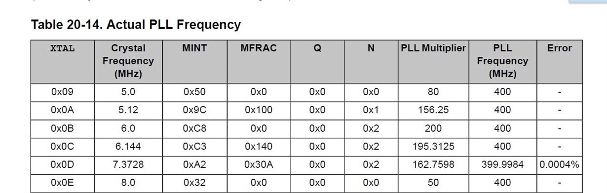

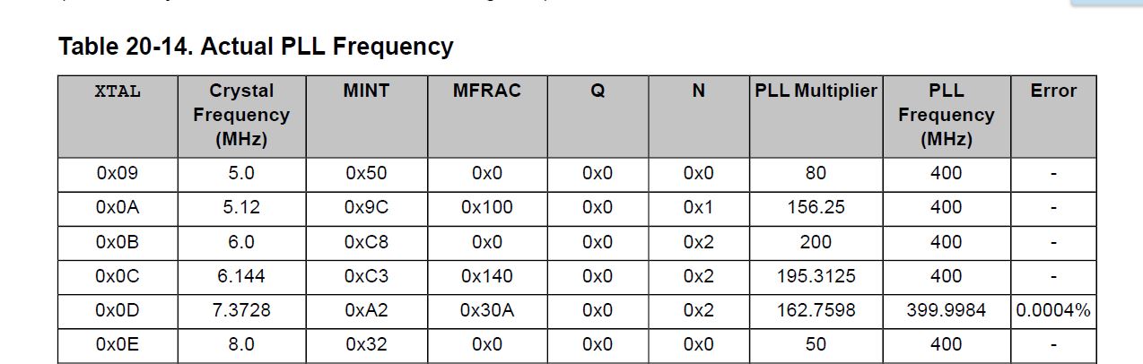

  • Jame shin said:
    2. It's a jitter problem.
    3.2 MCU internal PLL was designed incorrectly.
    -M4C, Phase Locked Loops (PLL) design failure of MCU.
    Please review Section 5.2.5.5 of the Datasheet which specifies the PLL Frequency Configurations:
    "If the main oscillator provides the clock reference to the main PLL, the translation provided by hardware and used to program the PLL is available for software in the PLL Frequency n (PLLFREQn) registers (see page 274). The internal translation provides a translation within ± 1% of the targeted PLL VCO frequency. Table 24-14 on page 1431 shows the actual PLL frequency and error for a given crystal choice."
    Perhaps this documented information is related to this 'jitter' you are concerned with? Of course, if you think that the 1% translation is poor design, that is your opinion and you are free to do so, but for a Cortex M4 MCU that is hardly a critical design flaw. We unfortunately aren't going to have 0.01% accuracy for a 400MHz PLL on a chip that costs $6.

  • Ralph,
    As cb says this needs a like. I do, however, think you are wrong about one thing.
    This is not jitter. The table referred to does not show the error column as the text states. However, the  '123 documentation does appear to have a more complete table in this regard.  It's the equivalent table 20-14 and does show the error term.  It's consistent with my interpretation that this is referring to the error that comes from non integer relationships between the PLL and the crystal frequency. As such it is a fixed error, and could be calibrated for unlike jitter.
    Jitter is a potentially important PLL characteristic but it's different from this translation error (that's rather badly named I think and certainly not properly explained) and I haven't been able to find figures for either the instantaneous jitter or the longer term jitter average (say over 50 cycles of the PLL frequency).
    Robert
    Maybe I have a different version of the manual?
  • Is it not "poetic" that "translation" (itself) requires translation?       (don't believe staff nor I have (ever) seen "translation" used in such "tech" manner - it is (likely) a rushed (& non-explanation) - highly notable as such!)
  • Or perhaps ironic
    Robert
  • Hi Robert,
    I 100% agree, I should have been more clear about what I meant. The ' marks around the jitter was intended to indicate that I didn't mean that 1% jitter is there, but rather that the translation error needs to be considered as well. I.E. perhaps what measurements and calculations he made that are leading him to claim the PLL is poorly designed with notable jitter aren't accounting for the translation error and thus giving him a false impression of jitter. Hindsight is 20/20 in that the ' marks can't possibly have relayed all the thoughts I just typed out!
    I didn't find any precisely spec'd jitter variables for the PLL either, so you don't have a different version or missed anything.

  • Hello . cb1 &  Ti engineer
    As you have told me " Relax -> again post reading -> thinking -> analyzer  !! "
    I looked at the previous post and thought about it.   https://e2e.ti.com/support/microcontrollers/tiva_arm/f/908/p/610275/2257664#2257664
    cb1 post A>  Should highest accuracy be your goal it may prove best to capture the "time delta" between "n" such "like-polarity" signal edges - which will reduce the effect of "timing jitter" upon your measurement.
                         (you would then divide that "total duration" by "n" - to determine the signal's period.)
    A_Q> for example from an previous post that was a jitter problem.
    sysclk 40Mhz Tc 0.025us , input signal 1Khz, Duty 50%, Ts=1000us  t1(H) 500us, t2(L) 500us. when if application requires a duty 0.01%.(0.1us)
            Time Load value = 1000 us / 0.025us = 40000 (0 ~ 39999 (0x9C3F)) setting,  H duration cycle = 500us/0.025us= 20000
            Jitter occurred :  H duration +- 18 cycle ( n ?)
           - total duration / n =   40000 / 18  = 2222.222...
         I do not know if I want to set this value to the Time Load Value or how to do it
         Please give detailed explanation. ?
    Q1>  The input signal was changed and tested.
            The problem 1Kh has changed the PROBE COMP (cailibration) 5V, 1Khz in Oscilloscope to crystal Oscillator.
        Q1-1> Input signal 20Mhz, Duty 50%, Ts=0.05us t1(H) 0.025us, t2(L) 0.025us / Sysclk 80Mhz Tc 0.0125us,Time Load Value 0.05/0.0125 = 4 (3(0x3))
        Q1-2> Input signal 1Mhz, Duty 50%, Ts=1us t1(H) 0.5us, t2(L) 0.5us / Sysclk 40Mhz Tc 0.025us, Time Load Value 1/0.025 = 40 (39(0x27))
        Q1-3> Input signal 500Khz, Duty 50%, Ts=2us t1(H) 1us, t2(L) 1us / Sysclk 40Mhz Tc 0.025us, Time Load Value 2/0.025 = 80 (79(0x4F))
        Q1-4> Input signal 200Khz, Duty 50%, Ts=5us t1(H) 2.5us, t2(L) 2.5us / Sysclk 40Mhz Tc 0.025us, Time Load Value 5/0.025 = 200 (199(0xC7))
    •    ISR  process cycle :   (Measure H / L output duration by oscilloscope)
                    when Sysclk 80Mhz,  duartion 0.6 us,  cycle : 0.6 / 0.0125 = 48 cycle
                    when Sysclk 40Mhz, duartion  0.9 us,  cycle : 0.9 / 0.025  = 36 cycle
          [Test Result ]
          Q1-1,2,3> : "No Good " , (Reason) Can not execute printf statement and ISR processing cycle is not enought
                                                                   (because, H duation 4cycle & ISR 48 or 36 cycle)
         Q1-4> : " Good " , (Analysis) execute printf statement but skip sequence counter value. (Reason) Printf statement processing time is 3.5ms.
                                                      - H duation 200 cycle / ISR 36 cycle = 5.5 enought
                                                        [note] The accuracy of the log contents is +- 1cycle 0.5%(1/200=0.005))
    Q2>  How do I printf statement it sequentially?
            Under see  "[Figure 3]  200Khz Input , System Clock 40 Mhz,  Log  Message " count value .
    Q3> I'm confused 11.3.2.4 Input Edge-Time Mode in Datasheet
          If you look at the above, System Clock 80Mhz, Input 20Mhz Edge Time Why does datasheet explain this possibility?
    thanks.
    [ Attach related images]
    Ch1 :T0CCP0,   Ch2 :T0CCP1,  Ch3 : ISR process time duration (use GPIO)
    [Figure 1]  1Mhz Input , System Clock 40 Mhz, " No Good"
    [Figure 2]  500Khz Input , System Clock 40 Mhz, " No Good"
    [Figure 3]  200Khz Input , System Clock 40 Mhz,  Log  Message  " Good"
    [Figure 4]  200Khz Input , System Clock 80 Mhz, ISR  process duration time  0.6us
    [Figure 5]  200Khz Input , System Clock 40 Mhz, ISR  process duration time  0.9us  " Good"
  • Jame shin said:
    Q> for example from an previous post that was a jitter problem... I do not know if I want to set this value to the Time Load Value or how to do it
    Your Subject Line (properly) lists "Edge Time" as your chosen, "Problem-Solving" method.    I suggested that you present the signal to be measured to TWO Different, Timer Input pins, one set to "Interrupt upon RISING EDGES - he second to Interrupt upon FALLING EDGES."    Then - within both (separate) Timer Interrupts - you "log that Edge Time" into RAM.  If you encompass "n such interrupts - then subtract the "time delta" (difference) between the "nth RAM value and 1st RAM value" (those values "Saved to RAM by each Edge Timer) and then, "Divide that "time delta" by your chosen "n" (8-16 should work) your result is a "reduced jitter measurement of (both) "Rising and Falling, Edge to Edge, duration."    To be clear - this process is followed upon the SAME, RAM stored data - one specific Edge at a time.   (i.e. you may first calculate the "average time duration between "Rising Edges" - followed by the same for "Falling Edges."    The use of such "averaging" serves to null deviations - raising your measurement's accuracy.
    Now you seek to set a "Time Load Value" - may I ask, "Why is that a requirement?"    If you've followed my instruction (repeated just above) your employing TWO Timers - both in edge time mode - is essentially "Fully Automatic!"   Recall that you seek to "Capture multiple Edge Events" from TWO Timers - each one responding to Different Signal Edges.   (of the same input signal - and both "collection of edge-time values" logged together.   Again - this eliminates your "need" for Timer Load Value - as your writing seeks.   Is this (now) clear?
    As the "printf" requires reasonably long, "MCU attention" - that presents (added & unwanted) challenge/demand upon the MCU - and w/little benefit!   Your real "Data Logging" must occur via the "Collection of Edge Times written to RAM" - and (only) viewed & recorded, AFTER the "Collection of n signal edges has completed!"    That "printf" may add errors or cause certain edges to be missed - neither acceptable!   Is this clear?
    This post has gone "on & on" for so long - few here (surely not I) can recall what's being done w/in both Timers' ISR.    You show (just one) ISR w/in your caps - you do (perhaps now) realize that there must be TWO separate ISRs - each ISR "Logging to RAM" the edge time it has (just) recorded!
    To raise accuracy these two ISRs should be - for now - the (only) ISRs allowed to run - during this "Edge Timer Mastery" exercise.    That's just standard "KISS" - which as always provides the best/fastest (often ONLY) path to user success.    (even if "banned here" - especially as "banned here!")
    The log you've presented - to me - has minimal value.   Far better - I believe - would be the "Log of Edge Times - collected by EACH Timer!"    And that does not (anywhere) appear!
    I leave "unstated" for now the method to calculate Duty Cycle.    This is (almost) intuitive - that exercise left to the "engaged" reader...   (if any...)

    I have the jitters after seeing such robust ringing in Jame's captures above post. Suspect inductive current (dv/dt & di/dt) may impact GPTM CCP input structure ability to  settle on the intended (stable) edge by the required 4 SYSCLKS clock periods. The EK-TM4C1294-XL launch pad is a superior to TM4C123 as James expects such accuracy less jitter may result GPTM count accuracy via ability to select PIOS 16Mhz clock source for each GPTM module. More expense yet just as robust DK-TM4C1294-XL with LCD screen removes need of UARTprintf() over a virtual port, yet adds the LCD application interrupts into the mix.

  • Hello cb1.
    CB1_Q1>   Your Subject Line (properly) lists "Edge Time" as your chosen, "Problem-Solving" method.
             A1>  I proceeded with the solution you proposed.
                    A 1Khz input signal test using two timers and a rising falling event interrupt resulted in 18 count jitter.
                   As you say. " Relaxing a bit - re-reading (several times, slowly) - then deep-thought & planning - should lead to your success."
                   What I do not understand is "time delta".
                  It is calculated by this content. As you say " cb1_post:  divide that "total duration" by "n"
                 So I calculated 40000 (total duration) / 18 (n).
                 I asked if the intention was correct.
                Maybe,  Is it the following ?
                Formula>   TBR (END:nth RAM value) - TAR (START: 1st RAM value) = H duration cycle ( time Delta)
       A1.1> H duration cycle( time Delta) / n, rise 1th, fall 2th does n mean 2 ?
                I explained you, but I still do not understand.
               BP101's post tells the number of induced current,voltage derivative, in a deep mathematical differential.
               You seem to be talking a simple thing. Anyway, I do not know how to reduce jitter.
      A1.2> Please let me know again, for example?
    CB1_Q2> Now you seek to set a "Time Load Value" - may I ask, "Why is that a requirement?"
            A2>  I was wondering if I should set the Time Load Value. As you say " cb1_post: divide that "total duration" by "n"
                    ex> Time Load Value of 1Khz input signal & 40Mhz Sysclk , 1ms/0.025us = 40000(39999(0x9C3F)
                    So I thought this was a change in value.
    CB1_Q3> both in edge time mode - is essentially "Fully Automatic!"   Recall that you seek to "Capture multiple Edge Events" from TWO Timers
             A3> I did that.
                    Please check the source code to post.
    CB1_Q4> this eliminates your "need" for Timer Load Value
             A4> Set the initial Time Load Value to 0x39CF for that limited period.
                    What do you mean about "eliminates your "need" for Timer Load Value" ?
    CB1_Q5>Is this (now) clear?
              A5> No.
                    signal path : 200Khz Crstal OSC --> Schmitt trigger --> T0CCP0(TA) & T0CCP1(TB) of MCU
                   Test result(Log message) + - 1 cycle (0.025us) error occurs.
                   The error ratio is 1/200 = 0.005 (0.5%).
                   One pulse is lost per 200 consecutive cycles.
                   So the cumulative error will occur.
    My Post > How do I printf statement it sequentially?
    CB1_Q6> neither acceptable!   Is this clear?
              A6> Yes, it is.
                      Simply calculated
                   ex>  when input signal 200Khz with 40Mhz Sysclk , TA-ISR( need 36 cycle), TB-ISR (need 44 cycle) ,Two event signal intervals (need 100 cycles)
                           printf processing time approx. 3.5 ms
                           printf () prints after TB-ISR processing.
                           Must be output within the amount cycle of the ISR(TA+TB), 80 cycle x 0.025us = 2us.
                    Is there a method to continue printing without losing the printf statement ?
    CB1_post>  This post has gone "on & on" for so long
       Post_A>  Yes, I do not enough understand
                      I do not know what it means, but I guess it's standard "KISS"!!
    CB1_tag>  Why does "Edge Timer" require "Load Set?"
      Tag_A>  Count starts at edge input signal event.
                     The count ends at the next edge input signal event.
                     So set the time Load value to be counted.
    thanks.
    [ attach Source code ]
    //includes
    #include <stdint.h> // Variable definitions for the C99 standard.
    #include <stdio.h> // Input and output facilities for the C99 standard.
    #include <stdbool.h> // Boolean definitions for the C99 standard.
    #include "inc/tm4c123gh6pge.h" // Definitions for the interrupt and register assignments.
    #include "inc/hw_memmap.h" // Memory map definitions of the Tiva C Series device.
    #include "inc/hw_types.h" // Definitions of common types and macros.
    #include "inc/hw_gpio.h"
    #include "driverlib/sysctl.h" // Definitions and macros for System Control API of DriverLib.
    #include "driverlib/interrupt.h" // Defines and macros for NVIC Controller API of DriverLib.
    #include "driverlib/gpio.h" // Definitions and macros for GPIO API of DriverLib.
    #include "driverlib/timer.h" // Defines and macros for Timer API of DriverLib.
    #include "driverlib/pin_map.h" //Mapping of peripherals to pins for all parts.
    #include "driverlib/uart.h" // Definitions and macros for UART API of DriverLib.
    #include "driverlib/adc.h" // Definitions for ADC API of DriverLib.
    #include "driverlib/fpu.h" // Prototypes for the FPU manipulation routines.
    #include "utils/uartstdio.h" // Prototypes for the UART console functions.
                                 // Needs to add "utils/uartstdio.c" through a relative link.
    //definitions
    #define UART1_BAUDRATE      115200  // UART baudrate in bps
    // function prototypes
    void init_timer(void);
    void duty_cycle(void);
    void init_UART(void);
    // global variables
    uint32_t sys_clock;
    uint32_t  start = 0, end = 0, length = 0;
    uint32_t int_flag = 0;
    int main(void)
        // Configure system clock at 40 MHz
       SysCtlClockSet(SYSCTL_SYSDIV_5|SYSCTL_USE_PLL|SYSCTL_XTAL_16MHZ|SYSCTL_OSC_MAIN);
        sys_clock = SysCtlClockGet();
        //ISR Processor Cycle
        SysCtlPeripheralEnable(SYSCTL_PERIPH_GPIOD);
    		SysCtlPeripheralEnable(SYSCTL_PERIPH_GPIOG);
    		// Enable the processor to respond to interrupts.
        IntMasterEnable();
    		init_UART();
    		UARTprintf("\n TCLK = %d\n" , sys_clock);
    		// GPIO PD[2]-TA, PD[3]-TB output duration  for  ISR  processing time
    		 GPIOPinTypeGPIOOutput(GPIO_PORTD_BASE, GPIO_PIN_2 | GPIO_PIN_3  );
        init_timer();
        TimerEnable(TIMER0_BASE, TIMER_BOTH);
        while(1){
    			GPIOPinWrite(GPIO_PORTD_BASE, GPIO_PIN_2, ~GPIO_PIN_2);
            if (int_flag == 0x1)
                int_flag = 0;
    				//		GPIOPinWrite(GPIO_PORTD_BASE, GPIO_PIN_2, GPIO_PIN_2);
                UARTprintf("\nDUTY : %d  =  %d (End) - %d (Start) \n", length, end,start);
        		//		GPIOPinWrite(GPIO_PORTD_BASE, GPIO_PIN_2, 0);
        // Enable and configure Timer0 peripheral.
        SysCtlPeripheralEnable(SYSCTL_PERIPH_TIMER0);
        // Initialize timer A and B to count up in edge time mode
        TimerConfigure(TIMER0_BASE, (TIMER_CFG_SPLIT_PAIR | TIMER_CFG_A_CAP_TIME_UP | TIMER_CFG_B_CAP_TIME_UP));
        // Timer a records pos edge time and Timer b records neg edge time
        TimerControlEvent(TIMER0_BASE, TIMER_A, TIMER_EVENT_POS_EDGE);
        TimerControlEvent(TIMER0_BASE, TIMER_B, TIMER_EVENT_NEG_EDGE);
        //set the value that the timers count
    		// Input signal 20Mhz,  Ts=0.05us  , Sysclk 40Mhz Tc=0.025  , Count = 0.05us/0.025us = 2 (2-1=1 (0x1)
    		// Input signal 1Mhz,    Ts=1us      , Sysclk 40Mhz Tc=0.025  , Count = 1us/0.025us     = 40 (40-1=39 (0x27)
    		// Input signal 500Khz, Ts=2us      , Sysclk 40Mhz Tc=0.025  , Count = 2us/0.025us     = 80 (80-1=79 (0x4F)
    		// Input signal 200Khz, Ts=5us      , Sysclk 40Mhz Tc=0.025  , Count = 5us/0.025us     = 200 (200-1=199 (0xC7)
    		// Input signal 1Khz,     Ts=1ms     , Sysclk 40Mhz Tc=0.025  , Count = 1ms/0.025us    = 40000 (40000-1=39999 (0x9C3F)
        TimerLoadSet(TIMER0_BASE, TIMER_BOTH, 0x4F);
        TimerSynchronize(TIMER0_BASE,TIMER_0A_SYNC|TIMER_0B_SYNC );
        //Configure the pin that the timer reads from (PF0)
        SysCtlPeripheralEnable(SYSCTL_PERIPH_GPIOF);
    		//  TM4C Port-F0 unlocked and commit contol register be set.  PA[1:0], PA[5:2] , PB[3:2] , PC[3:0], PD[7], PF[0]
      	HWREG(GPIO_PORTF_BASE + GPIO_O_LOCK) = GPIO_LOCK_KEY;
    	  HWREG(GPIO_PORTF_BASE + GPIO_O_CR) |= GPIO_PIN_0;
    		//  GPIO Configuration , T0CCP0 (TA)-PF[0], T0CCP1(TB)-PF[1]
    		GPIOPinConfigure(GPIO_PF0_T0CCP0);
        GPIOPinConfigure(GPIO_PF1_T0CCP1);
        GPIOPinTypeTimer(GPIO_PORTF_BASE, GPIO_PIN_0 | GPIO_PIN_1);
        // Timer Interrupt Clear ( TA , TB)
        TimerIntClear(TIMER0_BASE, TIMER_CAPA_EVENT|TIMER_CAPB_EVENT);
        // Enable the indicated timer interrupt source.
        TimerIntEnable(TIMER0_BASE, TIMER_CAPA_EVENT|TIMER_CAPB_EVENT);
        // The specified interrupt is enabled in the interrupt controller.
        IntEnable(INT_TIMER0A);
        IntEnable(INT_TIMER0B);
    // TIMERA , rise edge , Interrupt ISR
     void Timer0AIntHandler(void)
        TimerIntClear(TIMER0_BASE, TIMER_CAPA_EVENT);
        start = TimerValueGet(TIMER0_BASE, TIMER_A);
    // TIMERB , fall edge , Interrupt ISR
     void Timer0BIntHandler(void)
    		GPIOPinWrite(GPIO_PORTD_BASE, GPIO_PIN_3, GPIO_PIN_3);
        TimerIntClear(TIMER0_BASE, TIMER_CAPB_EVENT);
        end = TimerValueGet(TIMER0_BASE, TIMER_B);
        length = end - start;
        int_flag = 1;
    	  GPIOPinWrite(GPIO_PORTD_BASE, GPIO_PIN_3, 0);
        // Enable and configure UART0 for debugging printouts.
        SysCtlPeripheralEnable(SYSCTL_PERIPH_UART0);
        SysCtlPeripheralEnable(SYSCTL_PERIPH_GPIOA);
        GPIOPinConfigure(GPIO_PA0_U0RX);
        GPIOPinConfigure(GPIO_PA1_U0TX);
        GPIOPinTypeUART(GPIO_PORTA_BASE, (GPIO_PIN_0 | GPIO_PIN_1));
        UARTStdioConfig(0, UART1_BAUDRATE, sys_clock);

                          1 kHz signal uses calibration signal in oscilloscope
                          200Khz, 500Khz, 1Mhz, 20Mhz signals use crystal oscillator
    Robert_Q8> BTW 18 counts in 40000 is about 450ppm. So what is your crystal accuracy and drift specs?
                A8> 1khz is requesting Frequency stability from Tektronix company
                        200Khz, 500Khz, 1Mhz, 20Mhz Crystal Oscillator Frequency stability : +- 50ppm
