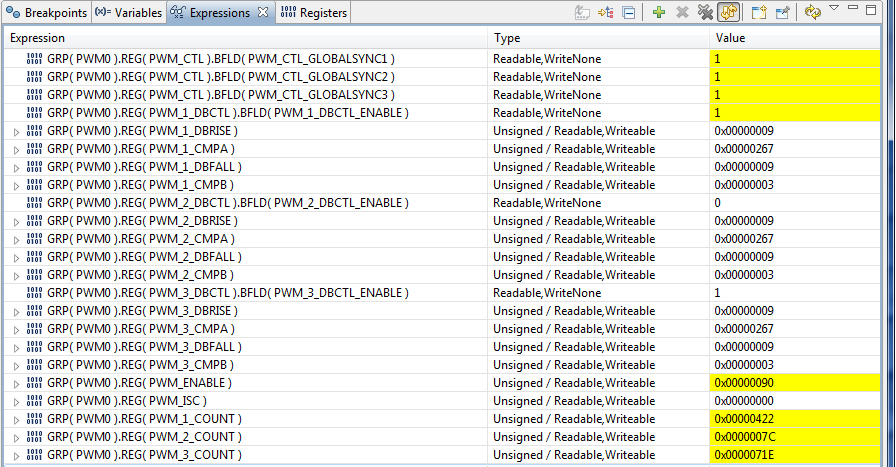

It seems there might be a possibility the PWM module is not able to reset all counters to zero via Tivaware syntax or the order of such procedure is highly relative. Yet the generators time base via software are made synchronous after a peripheral reset however the 3 generators counters in CCS debug fail to roll count values concurrently to each other.
Could there be an issue using ROM calls to zero the counters?  Is there a specific syntax order or delay period required to ensure all generators are reset to zero count? How can we use CCS debug to ensure all generators counts are reset to zero when count registers are otherwise so varied in counting values. Especially true in light of ICDI updates 1Mhz is considered to slow to even prove equal generator counts occur after peripheral reset.
    Have you measured the PWM outputs with a LSA or oscilloscope and seen that the PWM generators are not synchronised?
    Or is it that the current count values as sampled by the CCS debugger do not appear to be synchronised?

    Have you measured the PWM outputs with a LSA or oscilloscope and seen that the PWM generators are not synchronized?
    There is a scope capture in above posted forum link describes chopping pulses move left, center, right (relative) in the 3 phase inverter output.
    Chester Gillon said:
    Or is it that the current count values as sampled by the CCS debugger do not appear to be synchronized?
    The asserted Sync bit changes 1/0 seem to toggle all together in PWMSYNC register. Difficult to visually see in debug if all roll together or are few milliseconds apart. Yet the 3 generators counts are varied by quite some span. Amit at one time theorized skewed count was TMC123G ICDI (1Mhz) to blame for slow updates CCS debug register view. My reason to ask TI engineers does skewed count self correct with the faster XDS200 emulator.
  • PWM generator count registers are skewed yet the PWM_CTRL global update SYNC bits appear to fire simultaneous. Wondering if the faster XDS200 (480Mbps) would still have the same skew count condition ?
