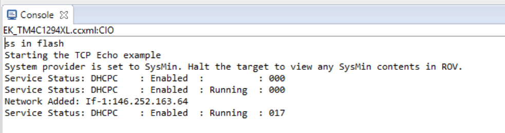

In the TCP Echo project for the DK-TM4C129X dev-board, the readme.txt says "the IP address is written to the console".
What is "the console"? I can't see what IP address the board is being assigned via DHCP.
The dev-kit comes with a screen, but nothing is printed on the screen. In fact, none of the screen code seems to be in the project. I verified the screen works by loading another example project.
