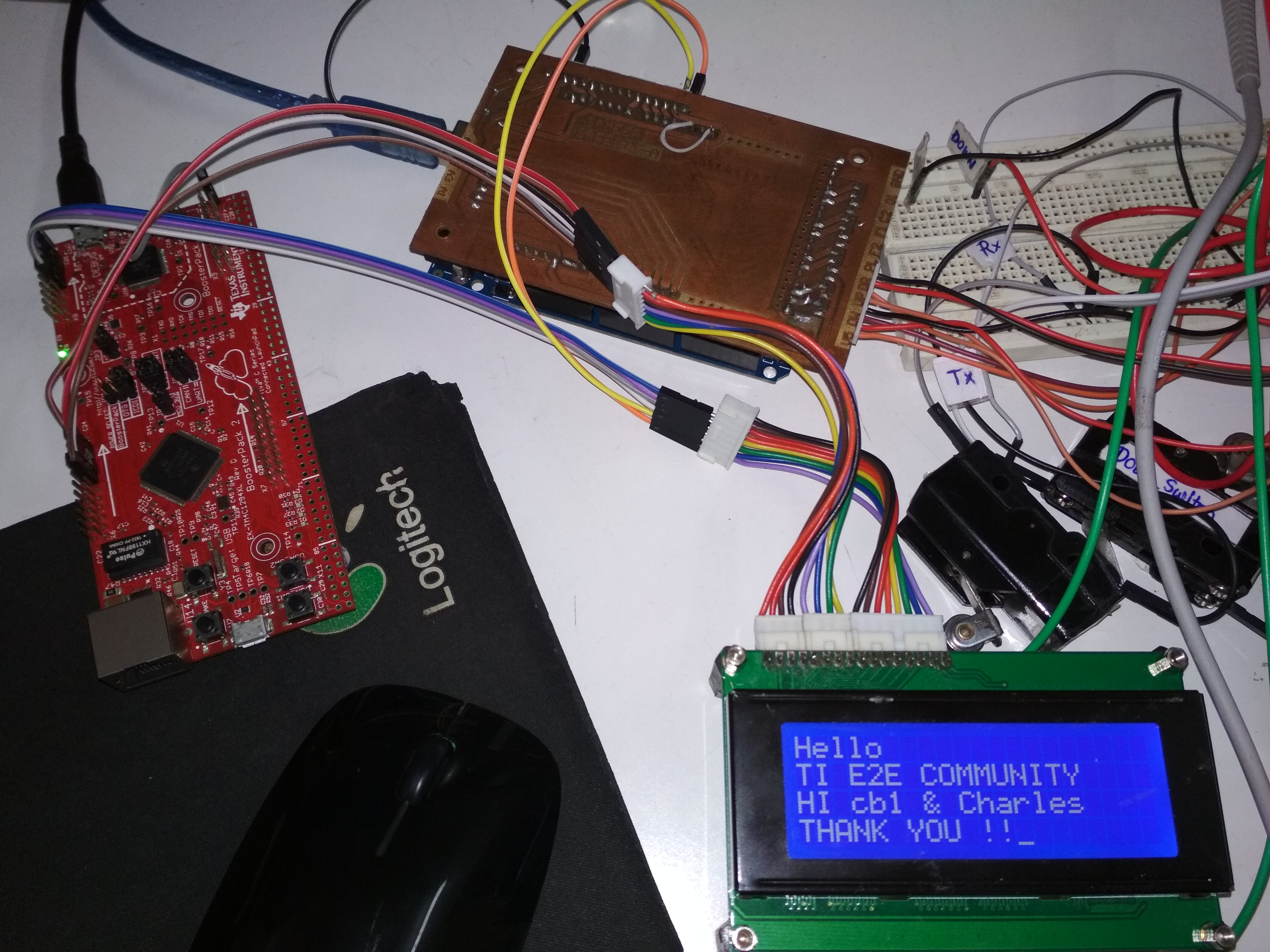

I WANT TO INTERFACE QC2004A LCD WITH TM4C 1294XL.
BELOW IS MY CODE. NO ERROR. BUT DISPLAY IS BLANK.
CONNECTION:  RS-PB4,  EN-PB5,  D4-PE0,  D5-PE1,  D6-PE2,  D7-PE3,  VSS-GND,  VDD-5V,  VEE[PIN 3]-3.3V,  R/W-GND,  Backlight Anode-3.3V.
PLEASE SUGGEST POSSIBLE SOLUTION / POINT OUT ERRORS.
    That's quite a task listing - is it not?
    You do (neither) yourself - nor your helpers - any favor by electing, "4 Bit LCD Mode."     The "saving" of 4 GPIO is achieved at much greater SW complexity - and loss of display "robustness!"    (as ANY glitch upon "E" will throw the Lcd into complete disorder! ... i.e. the dual, "nibble" transfer sequence will be "unpaired.")
    Your understanding of this vendor's most helpful API demands further review (especially GPIO Reads/Writes).     Here's (just one) example:
    GPIOPinWrite(GPIO_PORTB_BASE, GPIO_PIN_5, 1);
    While the use of "1" to "Set a Bit" is usual - it FAILS here!    Your review of the SW-DRL-User Guide reveals that the "3rd parameter must be the "bit-packed/valued" of the targeted bit."   (which is NOT "1" - instead GPIO_PIN_5 has the bit-packed value of 32.   Likewise "PIN_7 is 128, PIN_4 is 16, PIN_0 IS 1.)
    There are bound to be even further code errors - yet your "retreat from the needless complexity demanded by "Four Bit LCD Mode" is paramount!
    Your search of this forum will reveal my (multiple) past postings - some of which included the "Grandfather LCD Control IC's spec" - which revealed the complex Initialization Code and Timing.   Getting that (at all wrong) DOOMS all subsequent effort.
    You note the Lcd's contrast pin as set to 3V3 - while possible - it is far more usual that the contrast pin is adjusted near GND - check your display's data sheet for the specifics.
    Four Bit LCD Mode is (most properly) reserved for high volume Apps - and cannot justify the extra "time/attention" demanded - so that 4 GPIO are saved...  (for a limited volume usage...)
  • Hi Krishnat ,
     I think the best is for you to check on the logic analyzer if all the signals are properly generated to the LCD with respect to the timing requirements demanded by your LCD display. Check if the LCD has proper power supply and if you are manipulating the signals correctly. Below is a reference for how someone has done it in Raspberry Pi.
    LCD Pin Function Pi Function Pi Pin

  • Hi Charles,
    Looking at this (Rasp) fellow's "LCD Init" - I do not believe it to be correct.    Improper initialization - as stated - DOOMS all subsequent efforts.
    In addition - the "critical" contrast pin's level (Pin 3) - has been "unspecified!"     Attention to such detail IS required...   (throws all that follows under suspicion...)
    The "lack of robustness" via 4-Bit Mode is little recognized - yet VERY REAL - and is employed in your presented example.   As you know - a clear Violation of KISS!    "Saving 4 GPIO - at risk of a highly disordered display screen" - proves an unsatisfactory, "Risk vs. Reward."
  • Hi cb1,
    Thanks for catching the offending code line (appearing in multiple places using GPIOPinWrite) and the recommendation.
  • Hi Charles,
    It is my belief that such "offending code lines" occur w/in, "O.P.'s code" AS WELL as "Rasp's code!"        (and do note that Rasp "ducked" the  (necessary voltage level setting of display's (critical) Contrast pin!)
    Not all code - found "free" on the net - is insured to "function as desired..."
    You (must) have noted that (both) o.p. and "Rasp" have chosen the far more demanding, more complex, "Four Bit LCD Mode!"     By your presentation of the "Rasp" code (which I believe incorrect) is it your opinion that "Code Ease & Robustness" should be TRADED for the "saving of 4 GPIO?"

  • HI,
    THANK YOU FOR SUPPORT.
    CONNECTION:  VSS[PIN-1]-GND,  VDD[PIN-1]-5V,  VEE[PIN 3]-VARIABLE POT, RS[PIN 4]-PB4,  R/W[PIN 5]-GND,  EN[PIN 6]-PB5, DB0-DB3- N.C. D4-PE0,  D5-PE1,  D6-PE2,  D7-PE3,  A[PIN 15]-VARIABLE POT, A[PIN 16]-GND
    #include <stdint.h>
    #include <stdbool.h>
    #include <string.h>
    #include "inc/hw_memmap.h"
    #include "inc/hw_types.h"
    #include "driverlib/debug.h"
    #include "driverlib/sysctl.h"
    #include "driverlib/gpio.h"
    void Initialize_LCD(void);
    void string_to_lcd(unsigned char *s);
    void LCD_write(unsigned char,unsigned int);
    void main()
    SysCtlClockFreqSet((SYSCTL_XTAL_25MHZ | SYSCTL_OSC_MAIN | SYSCTL_USE_PLL | SYSCTL_CFG_VCO_480), 120000000);
    SysCtlDelay(100000);//2ms
    SysCtlPeripheralEnable(SYSCTL_PERIPH_GPIOE);
    SysCtlPeripheralEnable(SYSCTL_PERIPH_GPIOB);
    GPIOPinTypeGPIOOutput(GPIO_PORTE_BASE, GPIO_PIN_0|GPIO_PIN_1|GPIO_PIN_2|GPIO_PIN_3);
    GPIOPinTypeGPIOOutput(GPIO_PORTB_BASE, GPIO_PIN_4|GPIO_PIN_5);
    GPIOPinWrite(GPIO_PORTE_BASE, GPIO_PIN_0|GPIO_PIN_1|GPIO_PIN_2|GPIO_PIN_3, 0x00);
    SysCtlDelay(2000000);//20ms
    Initialize_LCD();
    LCD_write(0X80,0);
    string_to_lcd("Hello");
    LCD_write(0XC0,0);
    string_to_lcd("TI E2E COMMUNITY");
    LCD_write(0X94,0);
    string_to_lcd("HI cb1 & Charles");
    LCD_write(0XD4,0);
    string_to_lcd("THANK YOU !!");
    SysCtlDelay(0XFFFFFF00);
    while(1){
    GPIOPinWrite(GPIO_PORTB_BASE, GPIO_PIN_4, 0xEF); //RS PIN LOW
    SysCtlDelay(5000);
    GPIOPinWrite(GPIO_PORTB_BASE, GPIO_PIN_5, 0xDF); //EN PIN LOW
    SysCtlDelay(5000);
    LCD_write(0x33,0);
    SysCtlDelay(5000);
    LCD_write(0x32,0);
    SysCtlDelay(5000);
    LCD_write(0x06,0);
    SysCtlDelay(5000);
    LCD_write(0x0E,0);
    SysCtlDelay(5000);
    LCD_write(0x28,0);
    SysCtlDelay(5000);
    LCD_write(0X01,0);
    SysCtlDelay(10000000);
    void LCD_write(unsigned char data,unsigned int RS)
    if(RS==0)
    GPIOPinWrite(GPIO_PORTB_BASE, GPIO_PIN_4, 0xEF); //Cammand
    else
    GPIOPinWrite(GPIO_PORTB_BASE, GPIO_PIN_4, 0xFF); //Data
    SysCtlDelay(5000);
    GPIOPinWrite(GPIO_PORTB_BASE, GPIO_PIN_5, 0xFF);
    SysCtlDelay(5000);
    GPIOPinWrite(GPIO_PORTE_BASE, GPIO_PIN_3|GPIO_PIN_2|GPIO_PIN_1|GPIO_PIN_0, ((data & 0XF0)>>4));
    SysCtlDelay(5000);
    SysCtlDelay(5000);
    SysCtlDelay(5000);
    SysCtlDelay(5000);
    GPIOPinWrite(GPIO_PORTE_BASE, GPIO_PIN_3|GPIO_PIN_2|GPIO_PIN_1|GPIO_PIN_0, (data & 0X0F));
    SysCtlDelay(5000);
    SysCtlDelay(5000);
    unsigned int slen;
    slen=strlen(s);
    while(slen>0)
    unsigned char D=*s;
    LCD_write(*s,1);
    SysCtlDelay(1000000);
    slen--;
    s++;
  • **** LIKE!!!!! *****
    That is one highly creative Thank You message!!!!
  • Glad your problem is solved.
  • So INSPIRED a POST demands a "Double LIKE!"   (for execution - especially your photo!)    (I actually thought, "How great it would be if poster "showed his screen" (as I read your display message) and then saw that you, "Did just that!"
    *** LIKE ***
    *** LIKE ***
    That said - having been (very) successful in the display biz - ALL EIGHT DATA Bits (wiring) reveal w/in your great photo!     (law-school "evidence training")
    (I remain uncertain (even doubtful) over the correctness of your 4 bit initialization - although you did modify it between first & second postings.)
    The fact that "ANY glitch upon "E" will "Throw your display into disorder" - as "DIRECT CONSEQUENCE OF 4 BIT MODE" - introduces an element of risk!    (not properly "rewarded" via the saving of 4 GPIO!)
    In addition the "write (or read) time" for each/every character is DOUBLED!
    So rare that "helpers" are rewarded - great kindness on your part - and IMAGINATIVELY DELIVERED!     (Switching to (proper) 8 bit mode adds ROBUSTNESS to your effort...)
