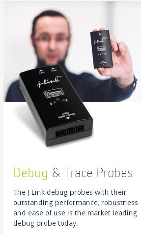

The J-Link - to my mind (and to the mind's of many) proves superior to the "vendor locked, limited versions" earlier mentioned. J-Link's proper, "vendor agnostic" capability - and substantial development time/funding/effort - and "true focus" - renders it measurably superior. It is also - the most popular JTAG/SWD Probe - by sales volume - and was introduced long prior to "lesser/limited versions."
A full-featured J-Link version is offered at a special, "Educational Discount price" - and you do NOT have to "pretend" to be a student! (I still have my "UCLA" sweatshirt) Neither firm - nor I - receive reward for such endorsement (although NOT by choice) - highly skilled (fellow) poster Robert also employs, "J-Link" - such (should) prove telling...
It should be noted that (even) vendor agent (here, TODAY!) endorses J-Link/J-Trace ... ... ... (seems an irresistible force - does it not?):

May I suggest, "DEBUG AND PROGRAMMING PROBE" (or Pod) as far more (properly) descriptive. Emulation - does NOT come into play! (It is just WRONG!)
You look forward to "pictures" (I prefer to await "demand" - prior to effort) thus (now) shall comply.
Note that the above flows (directly) from Segger's site - "Trace is a more powerful tool - and of course (still) NOT an "Emulation." (you should note that "cb1" (according to unbiased staff) is far better looking...and a "righty" - attending (always) to detail...)
