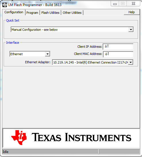

  • Are you looking for something like LM Flash Programmer, or are you looking at building your own server?

    the thing is we had the application developed in .Net for stellaris. Now for some Requirement we need the application written in c so that it can be used on linux machine to update bin files to micro controller.I have written the application in c.I was testing it with stellaris controller only,it is sending magic packet to the controller on port 9 to activate the Ethernet controller ,but the board is not recognising the packet. so my application is keep on sending the magic packet.magic packet consists of 6 bytes of AA followed by 6 bytes of MAC id of stellaris board.
