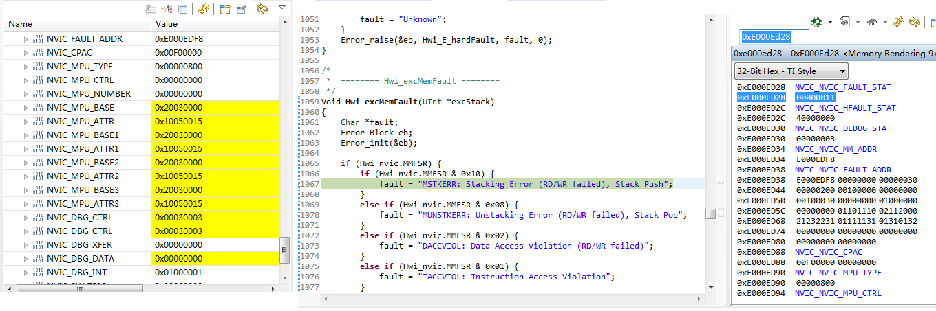

      I have difficulties to use MPU in this chip.
    1. <ti/sysbios/family/arm/MPU.h> is not found in my RTOS version. So I can't use BIOS API for MPU.
    2. Then I have to use driverlib. But I found definition like "MPU_RGN_SIZE_32B" is not correct in driverlib/mpu.h. Size bit should be log2(size in bytes) - 1 according to datasheet.
    3. I use the following code to init MPU (Note up till now, only one region is configured), and MpuInit is called in main, exactly before BIOS_start. But just after MPUEnable(MPU_CONFIG_NONE), an exception will occur. Please see the snapshot below to see detailed information about the exception.

    Also .map is attached.
    It look the error is not related to my region. But I don't know what is wrong.
