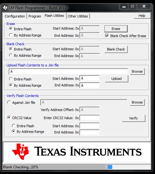

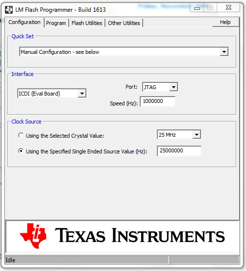

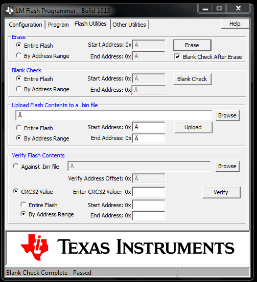

    Now my custom board was earlier programmed using TM4C123's ICDI so it's flash had to be erased( to invoke ROM based bootloader in LMFlash Pragrammer) so  I used the TM4C123's ICDI to erase flash.
    and checked that flash is  blank by blank check test which in my board case, was passed.

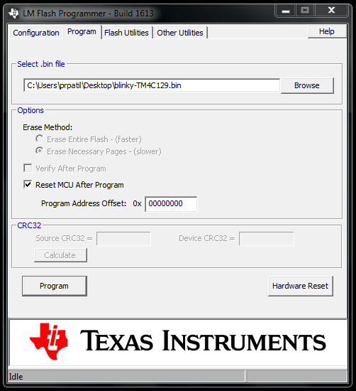

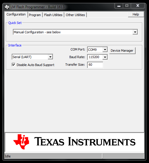

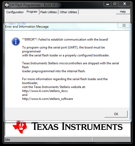

    Then I removed the JTAG connections and connected my custom board's PA0(RX) and PA1(TX) pin to USB to TTL board whice has COM port-9(who's baud rate I set to 115200 in device manager and kept the same baud rate in LM flash programmer too)
    and tried to program a blinky.bin to my custom board but it gave some error like this..
    Is there any important step of invoking uart ROM boot loader in LM Flash programmer, am I missing here?

  • Hello Techinspired,
    Sorry for the delay. I think you need to set the Program Offset before flashing the .bin file. This E2E thread discusses that: e2e.ti.com/.../2013487

    4) You need the define for your APP_BASE in your Linker to match the define for the APP_START_ADDRESS in the bl_config.h file. This is also the offset you need to indicate in the LM Flash Programmer for the "Progream Address Offset: 0x" box.
