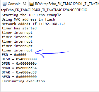

    i have used tcpEcho sample project along with trying to user periodic timer module to generate the interrupt in 5 second once. once the timer interrupt occurred, the timer ISR routine post the event to pending task. its working very fine as long as when no Ethernet cable is connected. the execution is breaking the moment Ethernet cable is connected.
    when Ethernet is connected from the beginning of execution, as first timer interrupt itself, execution termination.
    what is the relation between the timer module and NDK?
    here i have attached the code and snapshot.
    tcpEcho.zip
    Bala

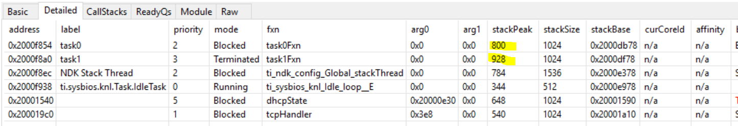

    The problem is that you are using printf. printf has two issues.
    1. It breaks real-time since when a '\n\' or the printf buffer (CIO) is full, a break-point is hit. CCS reads the contents of the buffer and displays it to the console. Note: this is for TI compiler. The GCC is slightly different but the same real-time issue.
    2. printf uses a lot of stack. It also jumps around and leaves chunks unchanged. So you were getting unlucky. It looks like you have enough stack, but it was really corrupting the things above the stack...the NDK buffers. Note: ROV and the runtime stack check are looking for 0xBEBEBEBE values at the top of the stack. Your call to printf was placing some things on the stack, but then jumping above it (and leaving lots of 0xBEBEBEBE at the top). I bumped the default stack to 1024 and here is your app (minus using DHCP instead of a static IP) task view.
    So, can you try this without printf (or change the printf to System_printf).
    Todd

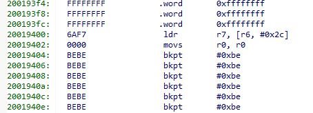

    I have checked by increasing the stack size. But it didn't help. I am attaching my disassembly view here. I put a break point at the stack base and run. It is not going to that point. The stack base is at 0x20019400.

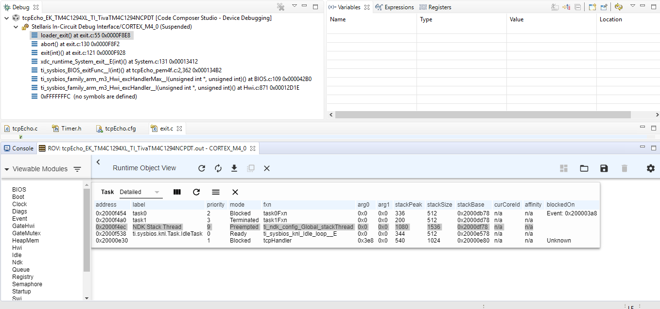

    I removed the watchdog task and tried to run. Then also stack is getting overflow for the next task having the same stack base. I am attaching the console and the ROV below after removing watchdog task.

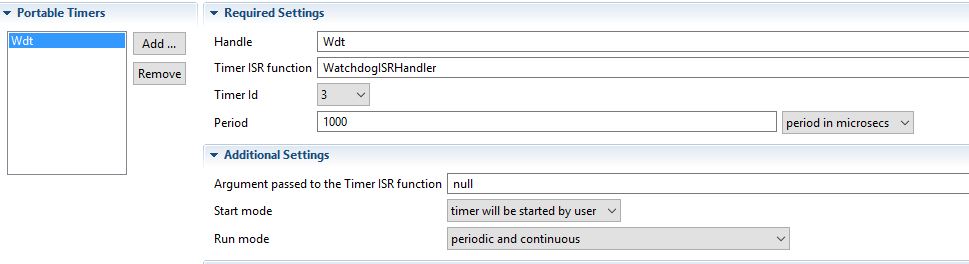

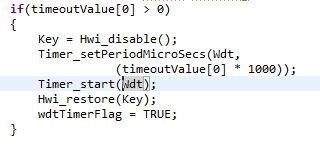

    Then I removed the timer module start and stop code from the application. Then it was working fine. The timer module configuration is attached below,
    The code used for starting the timer is given below,
    This condition is not true initially. Then also adding this code leads to stack overflow before doing any operation.. What may be the reason for this problem? Help me to get out of this.

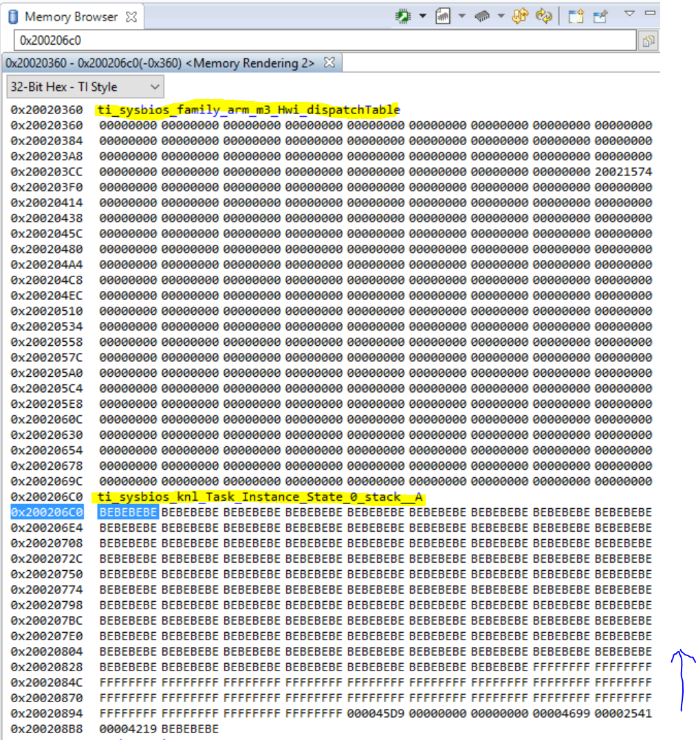

  • Sandra,

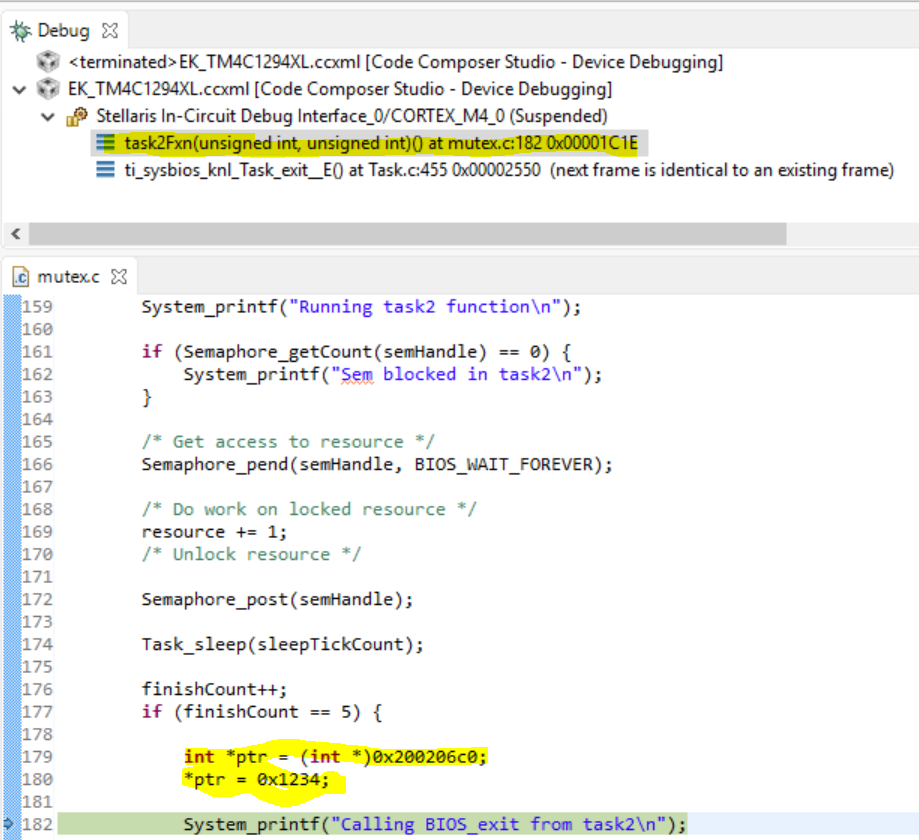

    Do not put a Hardware Breakpoint. Put a Hardware Watchpoint. For example, I have a simple project. Here is the stack for one of the tasks in a memory browser.
    Note the stack (base is 0x200206c0) will grow up (as denoted by the blue arrow) toward the base. I also showed what was before the stack. A common problem it is this block that is over-flowed. So definitely look at what is before your stack.
    To create a Hardware Watchpoint, right-click on the "new breakpoint" arrow in the Breakpoint view and select Hard Watchpoint.
    Then add in the stack base and have it break on a write
    Now run the app. As I noted before, if the stack had not been initialized, the watchpoint will trigger when the 0xbebebebe is written...just continue.
    Once the stack-base is modified (corruption or overflow), the watchpoint will trigger. Simply look to see where you are. For example, I added some code that corrupted the top of the stack.
    Once the "*ptr = 0x1234" code was executed, the Watchpoint halted the target. It's easy to see where the corruption is occurring now.
    Todd
