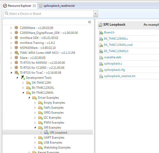

  • Do you have a specific question about using the TM4C1294? Are you using the EK-TM4C1294XL launchpad for your development? You can see a simple SPI example in TivaWare
    C:\ti\TivaWare_C_Series-2.1.4.178\examples\peripherals\ssi
    If you need to use an RTOS, there is a TI-RTOS example included with the TM4C TIRTOS.
    You need to look at documentation for your display to identify what data to send out the SPI.
