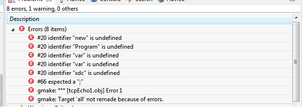

I am trying to set up a timer interrupt in TI-RTOS for my TIVA board. I use the following include files and code to create a timer:
#include <ti/sysbios/family/arm/m3/Timer.h>
var m3Hwi = xdc.useModule('ti.sysbios.family.arm.m3.Hwi');
var m3Hwi0Params = new m3Hwi.Params();
m3Hwi0Params.instance.name = "IntTimer";
Program.global.IntTimer = m3Hwi.create(39, "&task_clock", m3Hwi0Params);
I get the errors as below. This code I have attached looks the same as the one generated by .cfg GUI. Appropirate #include file could fix it? My final goal is to use .StartMode_USER mode and Timer_start() function.
I use CCS7.3, 2.16.1.14 RTOS, 3.32.0.06 XDC.
Thanks a lot.
  • Hello Lukasz,
    One of the errors says that a ';' is missing... if that is true, all other errors could be directly related to that. Please review your code to try and find the missing ';' and then re-compile when it's fixed. (Tip: Look just above where the red x's start showing up in the code window...)
