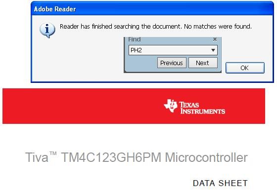

    First off - both your subject line (above) - and the quote from w/in your post - reference "PH2/PH3" - which DO NOT APPEAR W/IN MY "TM4C123 MANUAL!
    • Is this MCU (really) capable of providing 18mA drive (even from those "mystery pins") - both consistently and long-term?
    • And - many such opto isolators "lose efficiency with use & age" - might this be placing (even) higher demands upon these MCU pins?
    • MCU GPIO are not intended as,  "Beasts of Burden" - your imposition of  more robust - "buffering transistors" - imposed between the MCU and opto isolator - seems (highly) indicated.    (even if - and especially if - what you "have in place" - has (almost) appeared to "work so far.")
    • It would prove most wise to, "carefully/closely, scope & observe" each MCU pin tied to your opto - especially during the "Turn OFF" of the Opto.    Damaging voltage spikes (may) be in evidence - and if so - use of a Schottky diode to "Limit the  (unwanted)  "voltage excursion" is a usual practice."
    Shown below is support for the claim of  "PH2 (and its partner in crime)  somehow - NOT being resident" - upon TM4C123GH6PM.
    Thus - you must have "scrambled" this vendor's part numbers.   (a '129 device - suspected)     The above "transistor buffering" along w/voltage limiting Schottky diodes...  STILL applies.     As (fortunately) signaled - by your "4% - and likely to balloon" - failure rate...    (it is to your advantage - to have garnered "early warning" - of what may arrive - in FAR HIGHER (thus more consequential) numbers!")

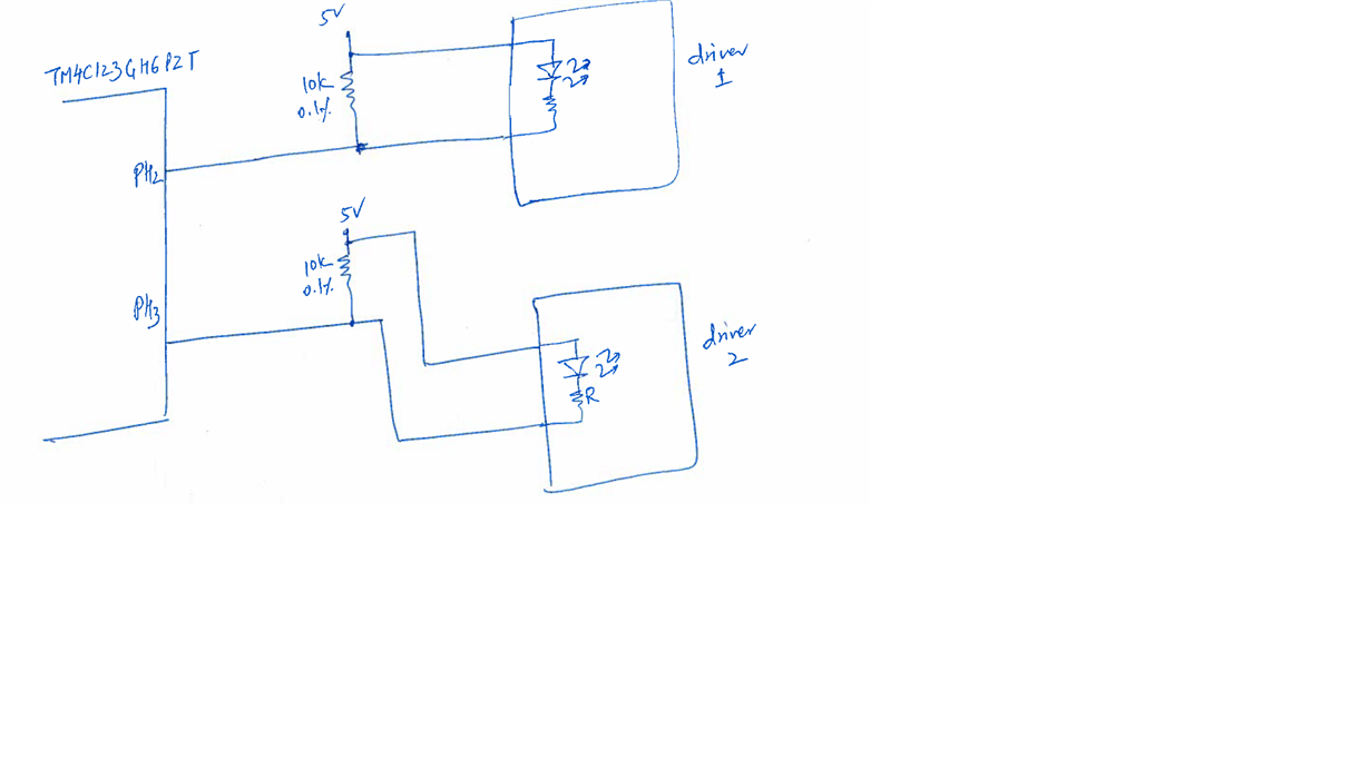

    Besides being wrong MCU posted are there any series resistors besides 10k pull ups from opto coupler transistor drives into PH2/3 MCU pins?
    Can you provide clip from schematic of coupling part of circuit, that would help here?

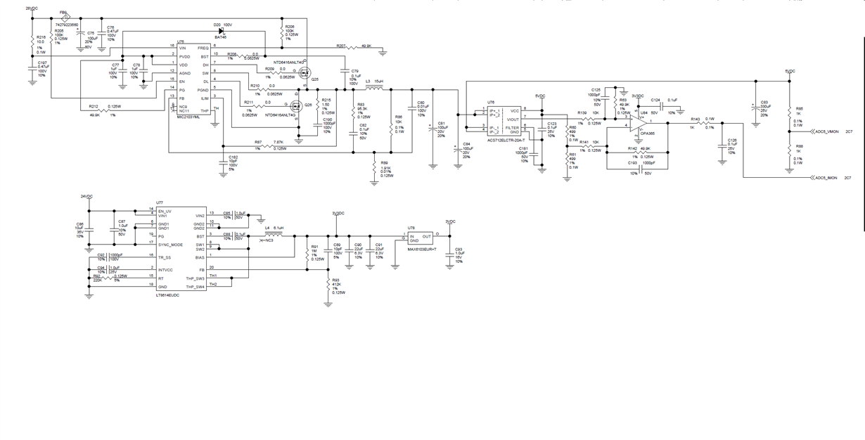

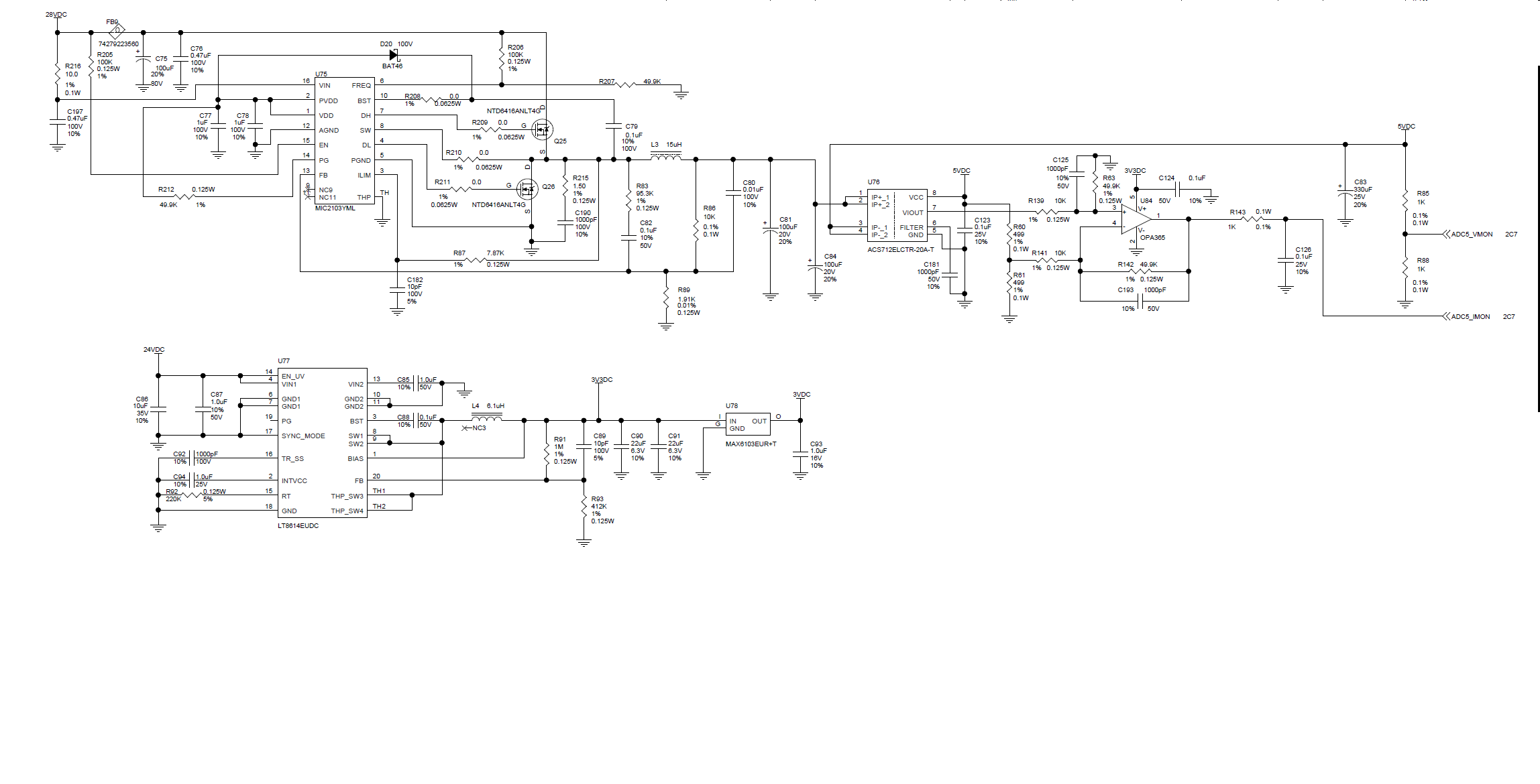

  • Sorry for the silence.  Was busy troubleshooting the issue with customer. Back in the office today. However still no resolution found. My apologies.
    The part we are using is TM4C123GH6PZT.  There is a series resistor internal to the stepper driver that produces 15mA drive at 5V supply with output set to low. It is happening only on one setup so far with three failures.
    On the other side, same boards and same drivers with same full load of 15 mA on both outputs ( PH2 and PH3), we have been testing multiple sets in temperature chamber where chamber temperature is set to +60 degC. The most temperature rise we saw on chip is to 78 degC. The chip itself is rated to 105 degC.
    The same chip is connected to outside world through serial connection using LTC2870HUFD transceiver.  Two of such transceivers are in use simultaneously in the failing setup.
    The 5V power is generated through MIC2103YML chip from 24V DC input.
    The 3.3V power is generated through LT8614EUDC chip from 24V DC input.

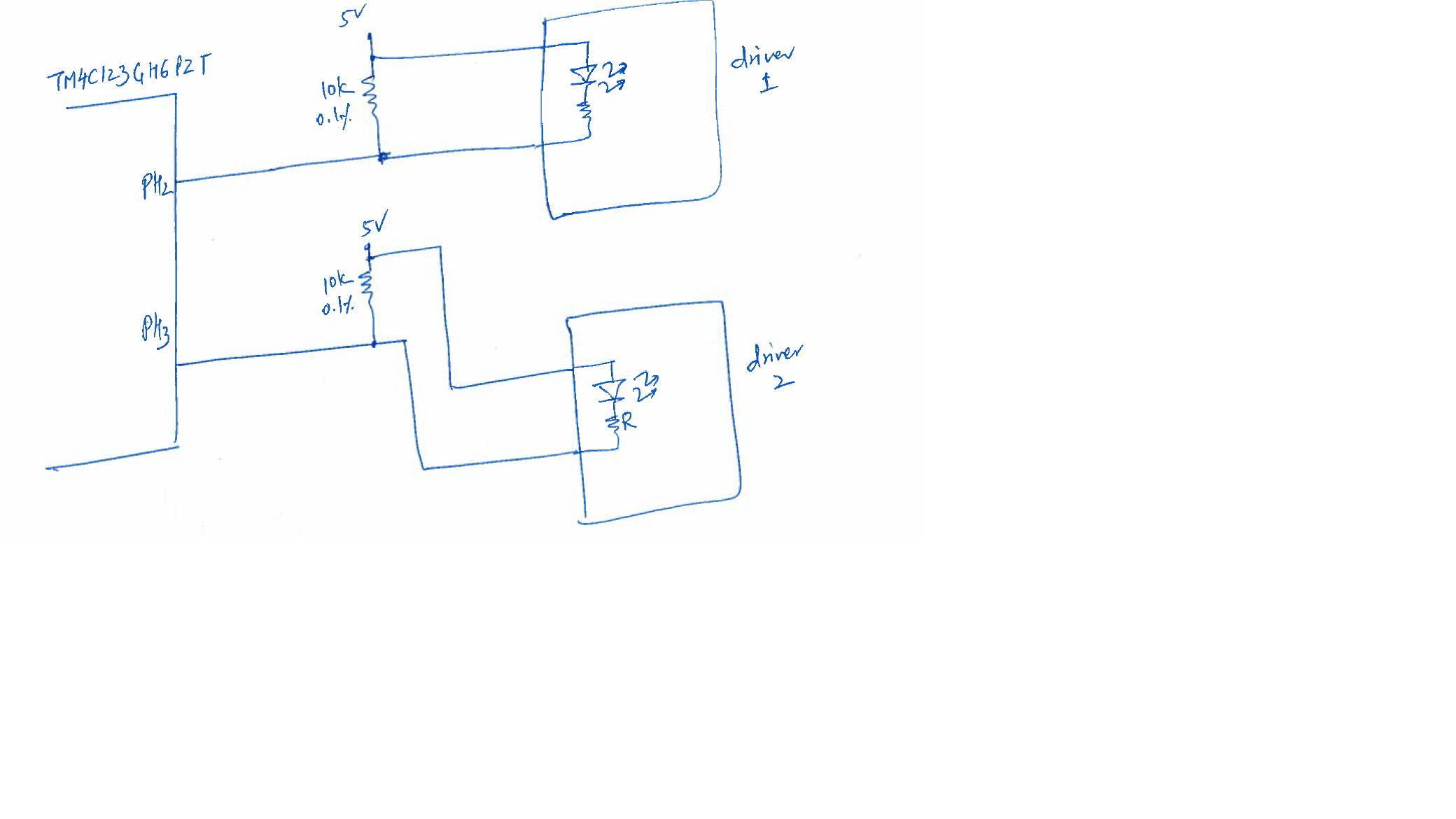

  • We use Microcontroller to driver opto inside Lin Engineering R701 driver.
  • 5V goes to LED of Opto. There is a 220 ohm resistor in series with LED before it connects to micro.
  • And - do they provide a "firm" specification - with which you are in "full compliance?"
    Might you be good enough to, "Check, confirm and report" - the voltage reading upon "PH2/PH3" (with respect to Gnd) - when your MCU's Open-Drain GPIO is (first) OFF - and then ON?     (yet otherwise "connected" - per your earlier schematic - especially w/the pull-up resistor deployed.)
    [edit]  Client-User (here) has added the detail of a 220Ω series resistor - I've produced the following paragraph in response to this (new) data.
    If the 15mA flows - as you earlier noted - there is a 3V3 "voltage drop" across the series connected 220Ω resistor.      (E=0.015 * 220 = 3V3)      That leaves - at most - 1V7 remaining in the (5V) series circuit.     It (remains) expected that the Open-Drain GPIO pin (PH2/PH3) will experience a voltage "at/around" the specified VOL level (~0V5,  ~0.5V)) when  15mA current flows.     Again - would you be so good as to measure & confirm?
    As you've reported "multiple Field Failures" - is it not reasonable to assume that the "power dissipation" of  "either - or both - PH2/PH3" is being (somehow) exceeded?     Such is the justification for your NEW voltage measurements - of both PH2 & PH3 - with respect to MCU Ground.     (it would not hurt for you to attempt a current measurement (thru the 220Ω R) if possible - as well.)
    Should you (still) have the Failed Units - might you make one more measurement - but this time w/the "opto circuit" NOT Connected - to either PH2 or PH3?     Such should prove useful - in our attempt to resolve your issue...
