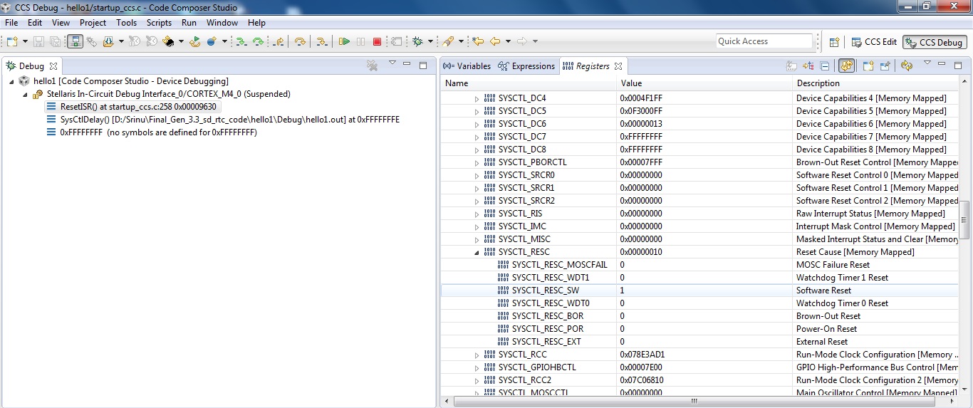

    I attached the image of my debugger output, when the SD Card starts writing that time CPU RESET is enabling  (few nano to milliseconds time) and my PWM interrupt stops for few nano to milliseconds and again CPU RESET disable(within milliseconds) and PWM states will come on normal.This process is going continuously.
    I request you to please suggest me how to avoid this issue.
    Srinu.V
  • I am confused. You circled the icon for asserting a CPU reset, and have labeled it "ENABLING". Is you system being periodically reset? This would explain why the PWM would be interrupted. If you put a breakpoint at the beginning of the "ResetISR" function you can see if you code is being reset. Then you can look at the system control RESC (reset cause) register to determine the source of the reset.
  • Yes sir,
    In my code CPU reset is happening in periodically.in this I think all my interrupts just halt and again it will starts.
    It's stop resetISR in start_up.ccs.
    I request you to please suggest me how to resolve this issue.
    Srinu.V.

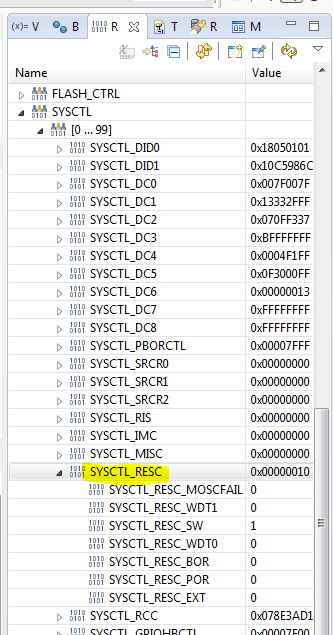

  • Is the watchdog enabled? What is the value in the SYSCTL_RESC register (System Control Reset Cause)?
  • Hai sir,
                Thanks for your valuable suggestions.
    I attach the snapshot of the  SYSCTL_RESC register. I request you to please find the attachment.
