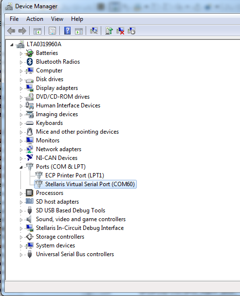

  • It looks like the code you posted is straight from the "hello" example. Are you sure you have connected your serial terminal to the correct port? In the device manager the port should show up as "Stellaris Virtual Serial Port" and then the COM port number like shown below:
  • Yes, it is the exact example because I want to keep it as simple as it can, and yes I connected to the rigth port. As I stated I used it before with the UARTChar sending characters (an echo example from the workbook).
    Is possible that am I missing something? I assume that the example should be ready for running, but perhaps I am wrong.
